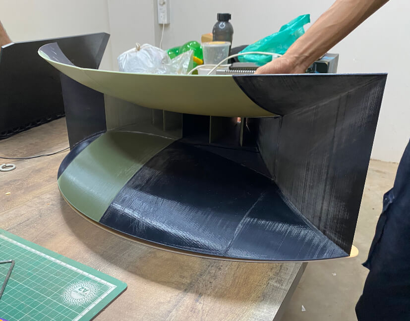

1. HORN

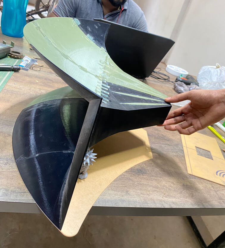

We embraced the mantra of cost-cutting for this purely experimental endeavour. So we came up with a plan of printing only the inner wall of the horn and decking out the outer wall with good ol' plywood. Once that's complete we would probably go wild with a filling of POP (plaster of Paris) or expanding foam sandwiched in between. Because who doesn't love a speaker that's part 3D-printed, part carpentry?

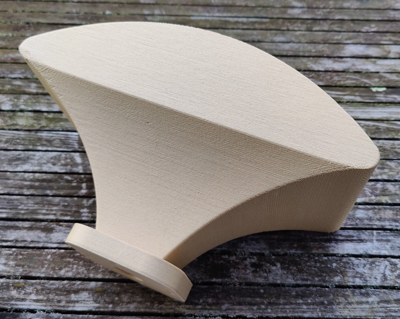

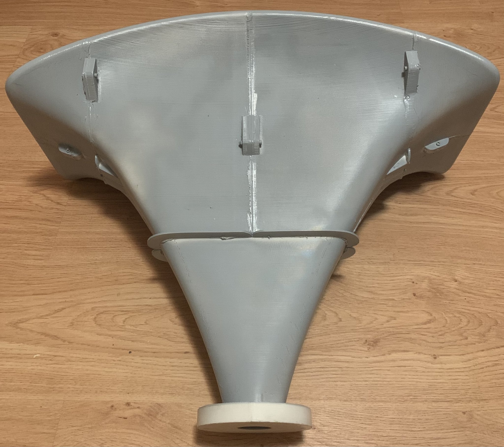

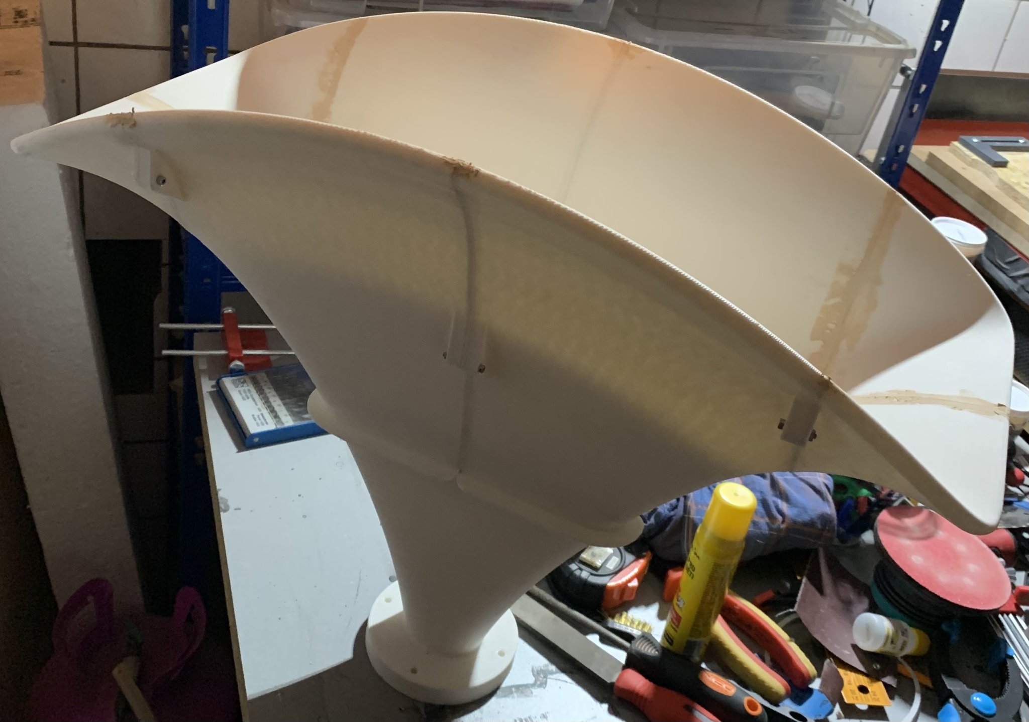

I like that plan. What material do you plan to use for printing? I printed a horn of similar size in pieces, but it definitely needs the walls damped.

Thanks! I intend to finish one horn first and if required further tweak the building process for the second one. I have outsourced the printing job, and my printer is super enthusiastic about this project! fingers crossed!
I think a Polyurethane casting resin is a good idea as it will provide some damping.
Yes! This is an option. I want to see the amount of cavity that needs to be filled once the outer wall is complete.

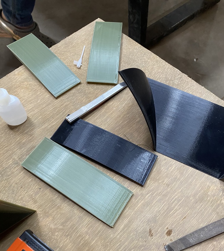

Would you like to show us some pictures or the cad file of the PLA inlay you are currently printing? I would likte to see how thick the PLA block is. Do you also have the fins included in the print?
I have some mixed experiences with PLA as it is prone to resonances especially for thin parts. Your approach is very interesting to overcome these issues. What is also quite nice to print is carbon fibre PLA which gives a better internal damping. My current attempts are also metal filled filaments.

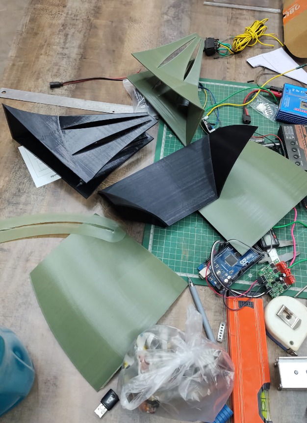

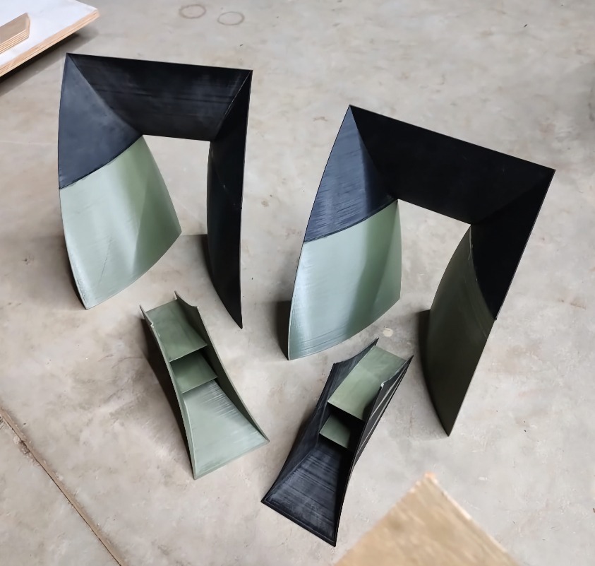

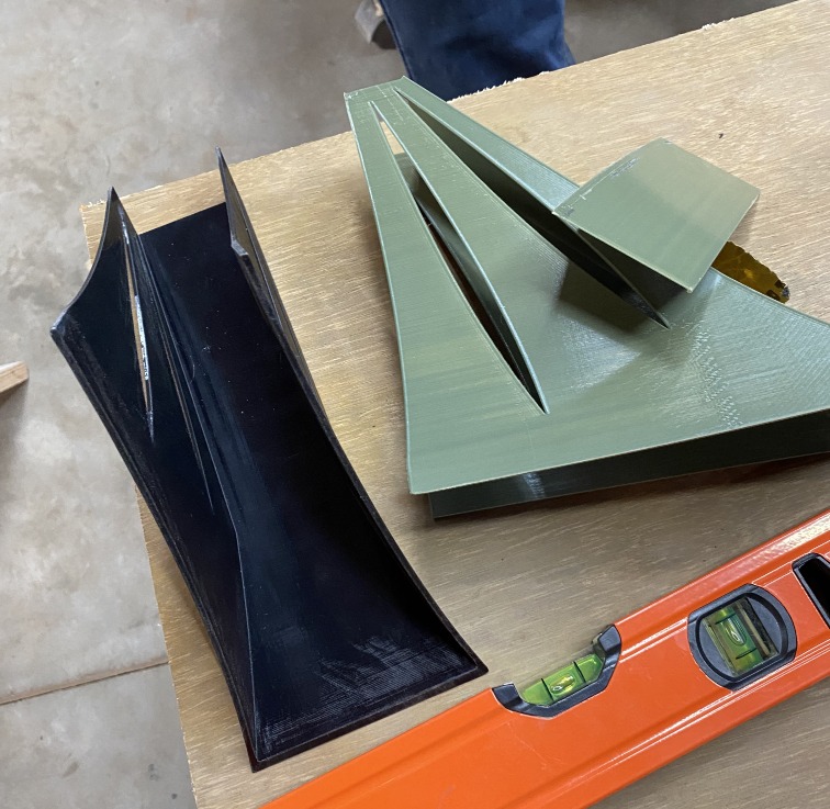

I have shared your cad file with just the profile with the printer. He's making the necessary slices to suit his printer. The thickness will be 2mm, and the fins will be printed separately and then glued. This also gives enough space to sand down to a smoother finish before the fins go on.
You're right, carbon fibre will have a "natural" dampening quality.

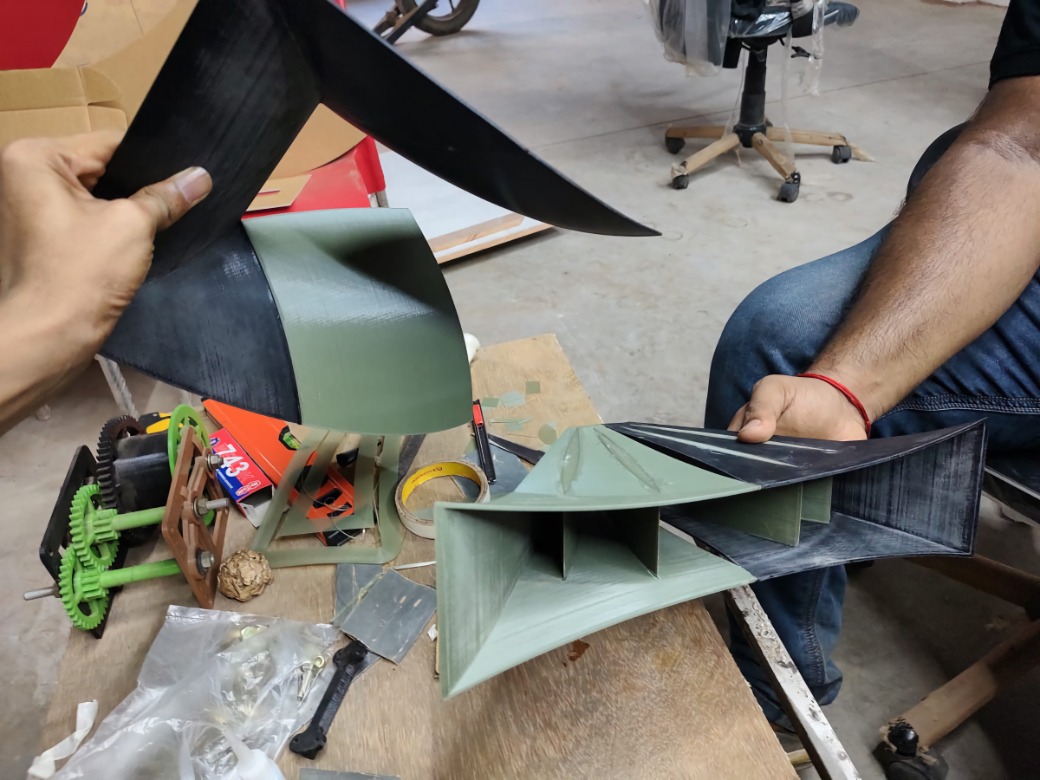

These are printed on multiple machines simultaneously. Helps speed things up.
Reactions: 2 users

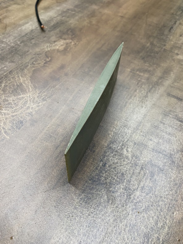

To study the effects, I will inject and fill the fins on the second horn with resin to make it solid. If the measurements show anomalies, I can always drill small holes in the fins of the first horn and fill them. The fins in the first horn are currently bound by structural webbing on the inside, but a quick flick with my fingers makes them ring.
Here's a top view. (rejected piece)
Reactions: 1 user

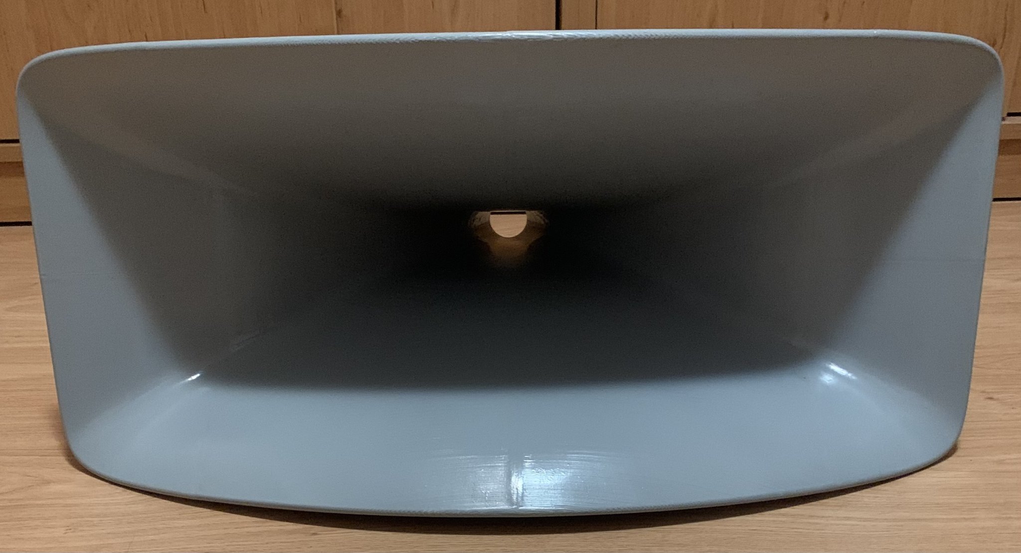

2. I'm reconsidering my approach to dampening the horn. My initial plan was to fill the cavities with POP, but I'm concerned that the added weight would cause the PLA surface to sag. I'm now considering the option of attaching felt or thick fabric around the horn. Are there any other ideas or suggestions for dampening the horn effectively?
Edit: I'm intrigued by @DonVK's post on his horn construction and would like to gain a better understanding of the effectiveness of his damping solution.
