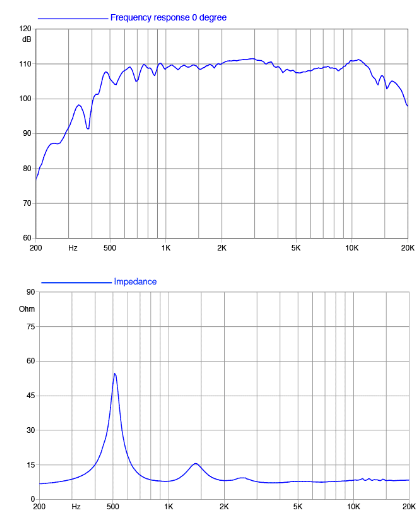

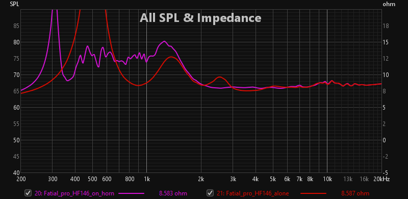

Here is a snapshot of the relevant calculations related to the internal geometry of the HF146 driver
But... that's an extreme driver-horn mismatch!
The driver's internal throat is short and with a large exit angle, resulting in a VERY high flare rate (>900 Hz equivalent exponential), whereas the horn has a much lower initial flare rate.
The wide conical throat of the driver is not damping the second driver resonance at 1.5K very well and below that the impedance match isn't as good as it could be. A ring insert adapter going down to the phase plug would help to avoid that problem and the HF146 is a good candidate for that idea. Overall it looks pretty good and as the simulations predicted. Above 15K is difficult for many 1.4" compression drivers and 3D printed fins in PLA with no reinforcement or damping could well be contributing to the messy HF.Don't know what is happening around 1.5kHz as well.
Please share your comments regarding these measurements

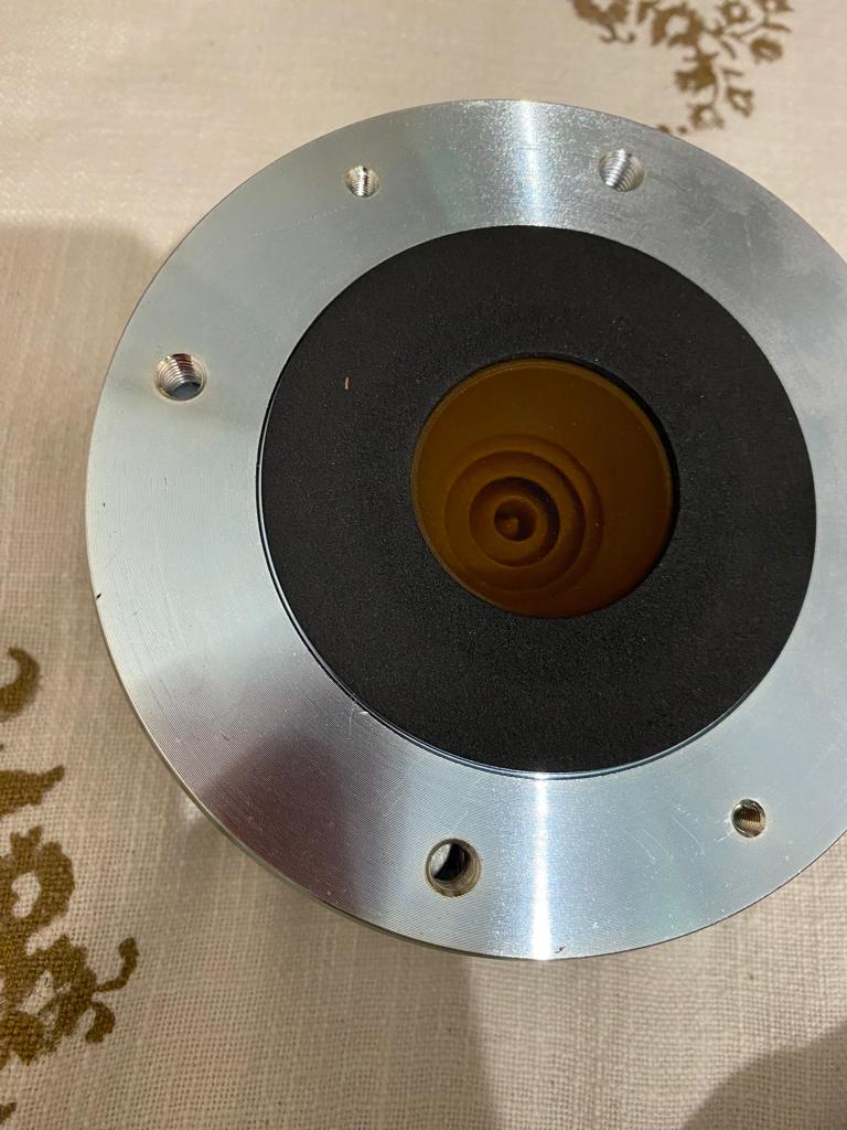

This is how the conical exit of the driver looks like
We want to ensure that the outer surface of the new adaptor especially the part that goes inside the throat fits properly on the orange colored existing conical adaptor in above pic. So the outside of the insert that we design needs to be conical but inside will be designed as per a smooth curve.

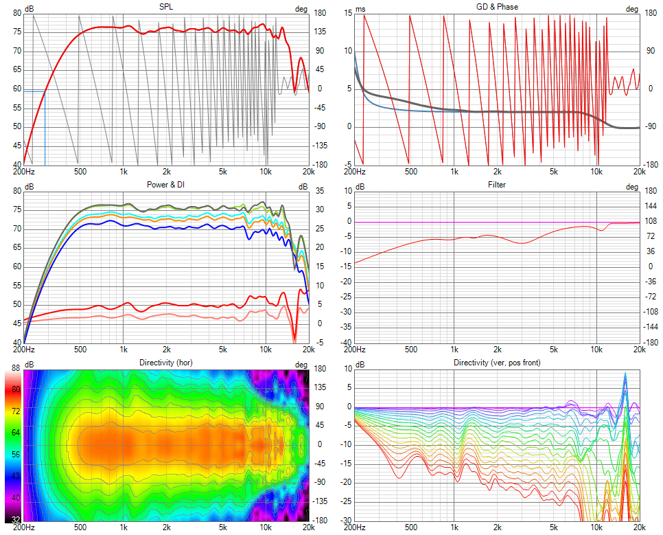

@vineethkumar01 , @WetFartz
IMO you need to slow down and start to eliminate some variables that might be causing these issues.. A few experiments will tell you if the problem is from either measurement or construction. What material is in the space between the horn skin and the thin plywood (?) outer skin? Are we sure that every interface is sealed properly , either perfectly flat or with a gasket. If it were my horn I would try the following:
1) single baseline measurement on axis
2) put the horn on a folded blanket to decouple (and damped) it from the stand, take another measurement
3) wrap a thick blanket around the horn body and take another measurement
If all 3 look the same you have a good construction, and can start to look at the next things.
[edit] if you want I can rerun the simulation with your particular adapter, I think its is a simple lofted conic, is that right?

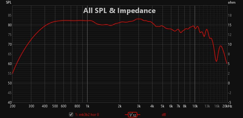

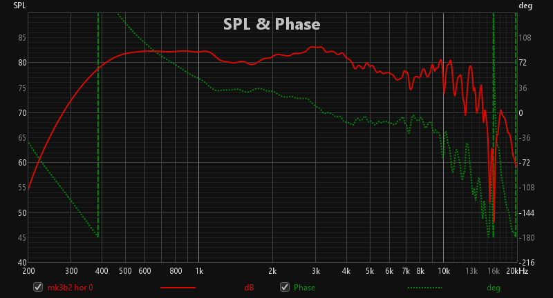

For now, this is our 6ms gated on axis measurement of the horn with mic 2m away from the horn mouth
There are indications of some dips and peaks in the impedance magnitude response above 8kHz above which also coincides with some of the dips and peaks in frequency response. These are even in the raw driver impedance measurements as shown below.
Even Faital pro's data sheet measurements show these but I think their magnitude response is much smoothed
If I just apply 1/12 octave smoothing to the above captured measurement, it looks like below.
Looks much cleaner and similar to data sheet.
From above, I am guessing that the driver break up modes could be causing some of the issues that we have been seeing. The resulting out of phase radiation from different parts of the diaphragm may be causing the kind of comb filtering sort of effects that we are seeing at high frequencies I think.

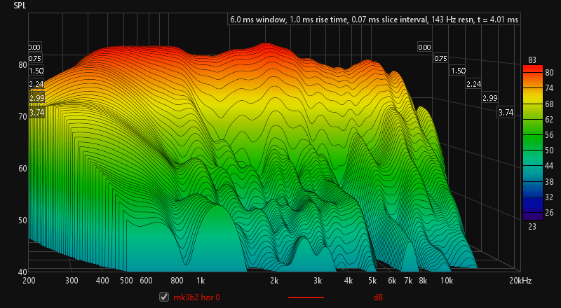

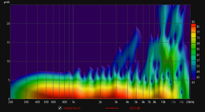

Adding energy decay & distortion plots for the above measurement

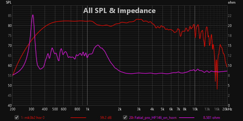

I've always wondered how it can be that the impedance look so weird, I mean the region 400 Hz - 1 kHz. I've never seen that on any device I've been ever working with. Are those all high-Q resonances induced by the horn, or what?
(You would need a pretty long time window to capture that acoustically, BTW, if it's actually in the radiated sound.)

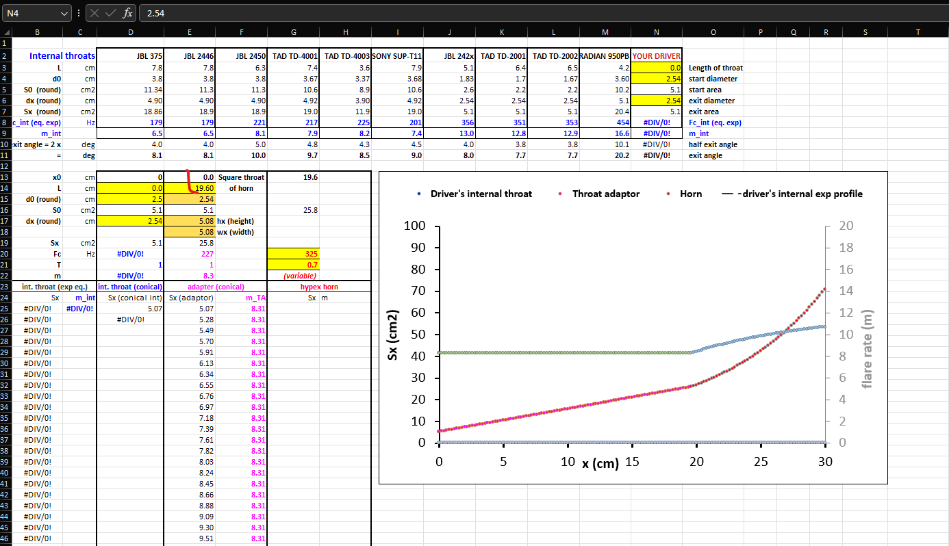

I didn't know how to make an exponential adaptor.
So I tried out the conical adaptor excel sheet I used before from @marco_gea
Based on the input parameters, it gives me a length of 19.6cm for the adaptor.
Can someone please check if I have input the parameters correctly? (with the ring insert, I am assuming that the throat length can be set to zero)

@WetFartz
The previous tests were for unintentional radiation from the horn walls or the stand (stacked chairs).
The next test I would do is check for internal resonances using a CSD waterfall using REW. You can use the on axis baseline for this. I've attached a sample so you can see what I mean. The resonances are at [2Khz, 8Khz, 18Khz].
