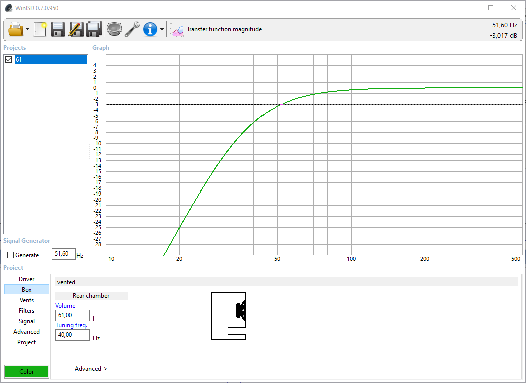

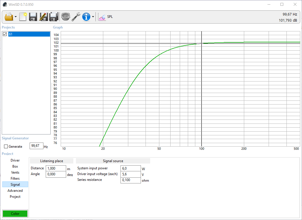

Take Faital 12PR320 12-inch with FS of 42 Hz and put it in your 61 liters enclosure. Build it 34 cm wide and 36 cm deep with 18mm wood. This is the smallest baffle width possible, aka foot print. They seem "slim" then. Put the ports on the front baffle so you can use the speakers closer to the wall if you need boundary gain. Tune the enclosure to 40 Hz and build the speaker 80 cm high, which is good to put your favored compression driver at you ears height and necessary for volume. You get F3 of 52 Hz, should suffice your needs. Also, 101 db @ 1 meter @ 6 watts or 94 dB @ 2.5 meters @ 6 watts. Horribly loud. This is the best you can get if you want to go passive and low and relatively slim. Now you need to read alot about electronics to construct the crossover, so many graphs! And very time consuming.
Enclosure 34 x 36 x 80 cm (-3,6 cm each for internal volume of 61 liters), tuned to 40 Hz, WinISD simulation attached.

I just spent a couple of hours on WinISD and experienced extreme frustration. I read the tutorials but could not get started due to missing info.
1) There are no drivers listed in the SELECT DRIVER FOR PROJECT list.
2) I entered T/S parameters for the driver I wish to use but wasn't able to save it so lost everything.
Is there a problem with this app or is it just me that doesn't know how to use it? I down loaded version 0.7.0.950.
