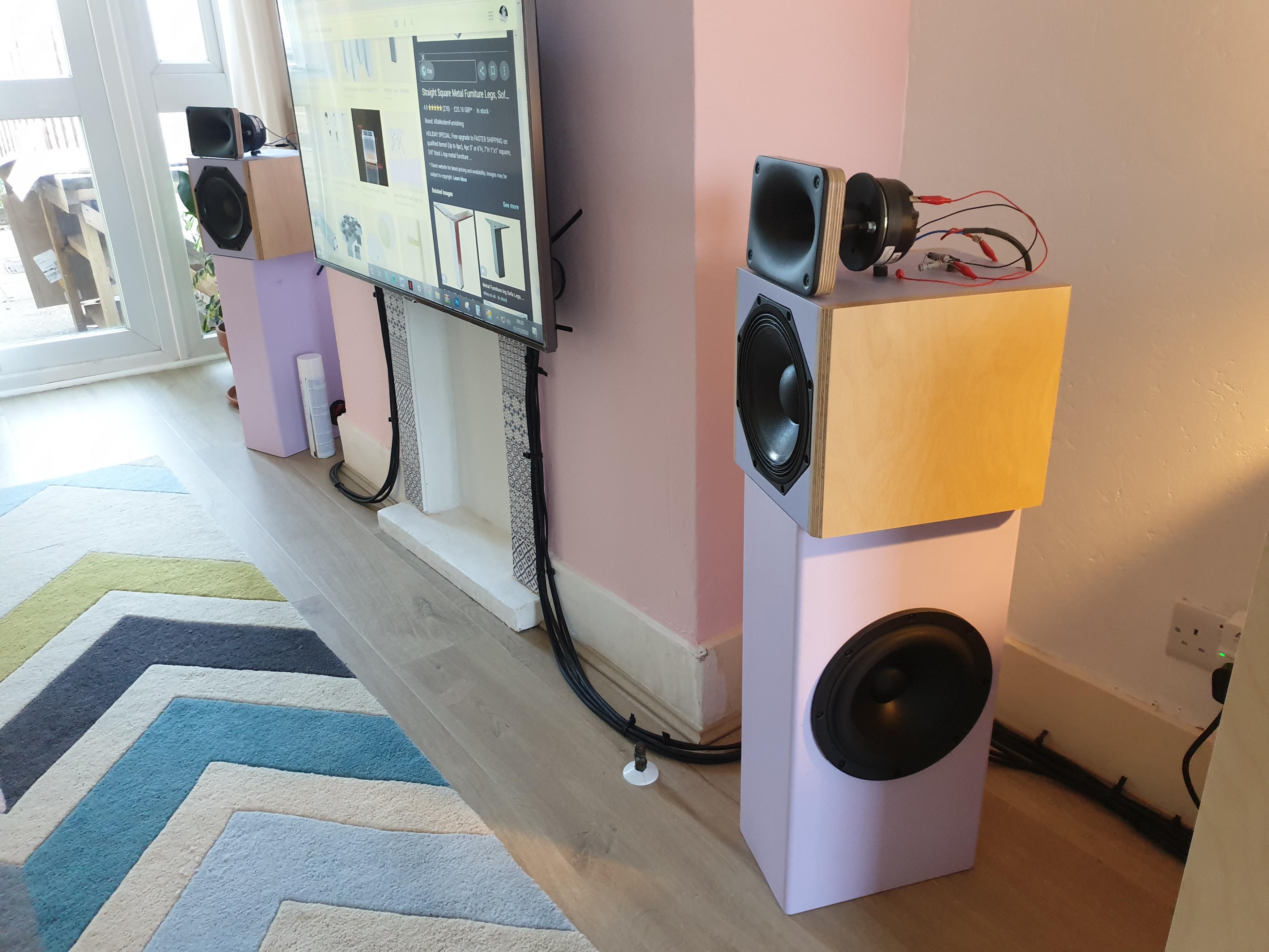

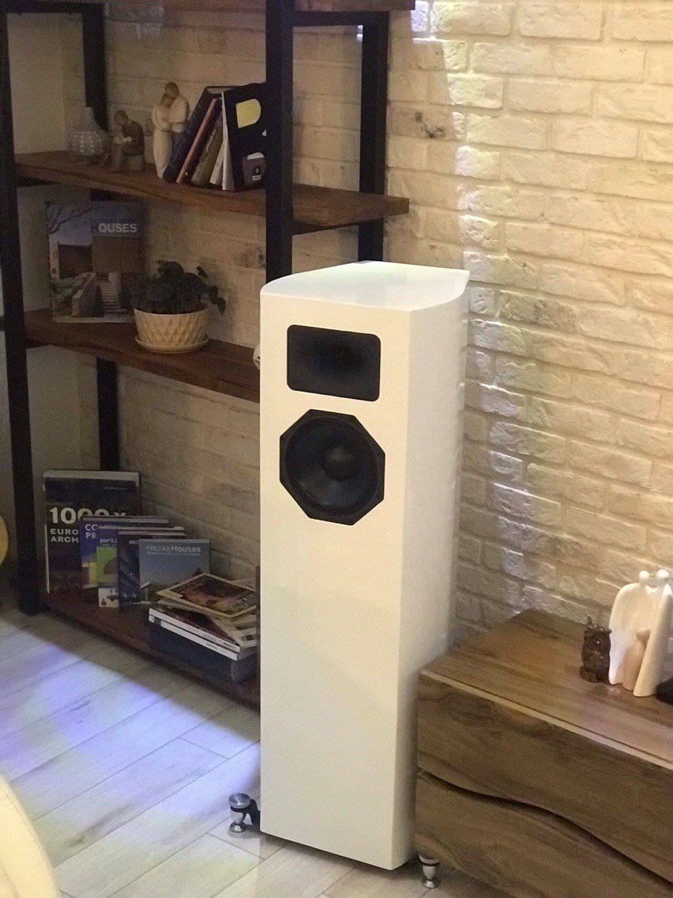

I've designed a speaker with exact drivers of your second option. Faital Pro 8PR200 and HF10AK + STH100.
Since one of my requirements is a small foot print, my first choice of speaker size is an 8 inch in a 40l maybe 50l box. Dave123 and GrahamGraham can you give us your thoughts on your speakers? Dimensions? Hence volume? How is the bass? What type of music do you listen to? Do you think the Fs 58Hz of the 8PR200 to be sufficient for rock, classic rock, prog?

In response to thoughts on the 8PR200, I think it's very nice. It's the first pro sound driver I have used of this size but I have absolutely nothing to gripe about other than the bezel shape. It's a bit of work to flush-mount and whilst not strictly necessary it's something I would want to do.
My alignment is a bit more compact than you could use on this driver. Initially I made it as a mid bass cab to crossover at 100hz ish. However, when I moved house and my listening position was up against the opposite wall I found I had enough LF extension to turn the subs off. If I were to do it again (which I most likely will when my shed is built) I would make it an EBS alignment (17L/55hz) and let the room do the back work to lift the bass area or EQ it flat depending on outcome.
However, we do not know your listening environment so it makes it a wee bit difficult to give any direct design suggestions. As scootmoose has said a few times, speakers should be designed holistically. This means as part of a larger system which is the room.
