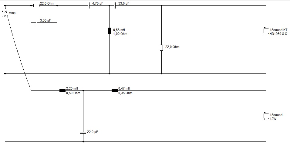

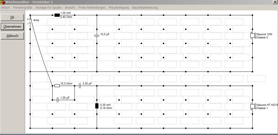

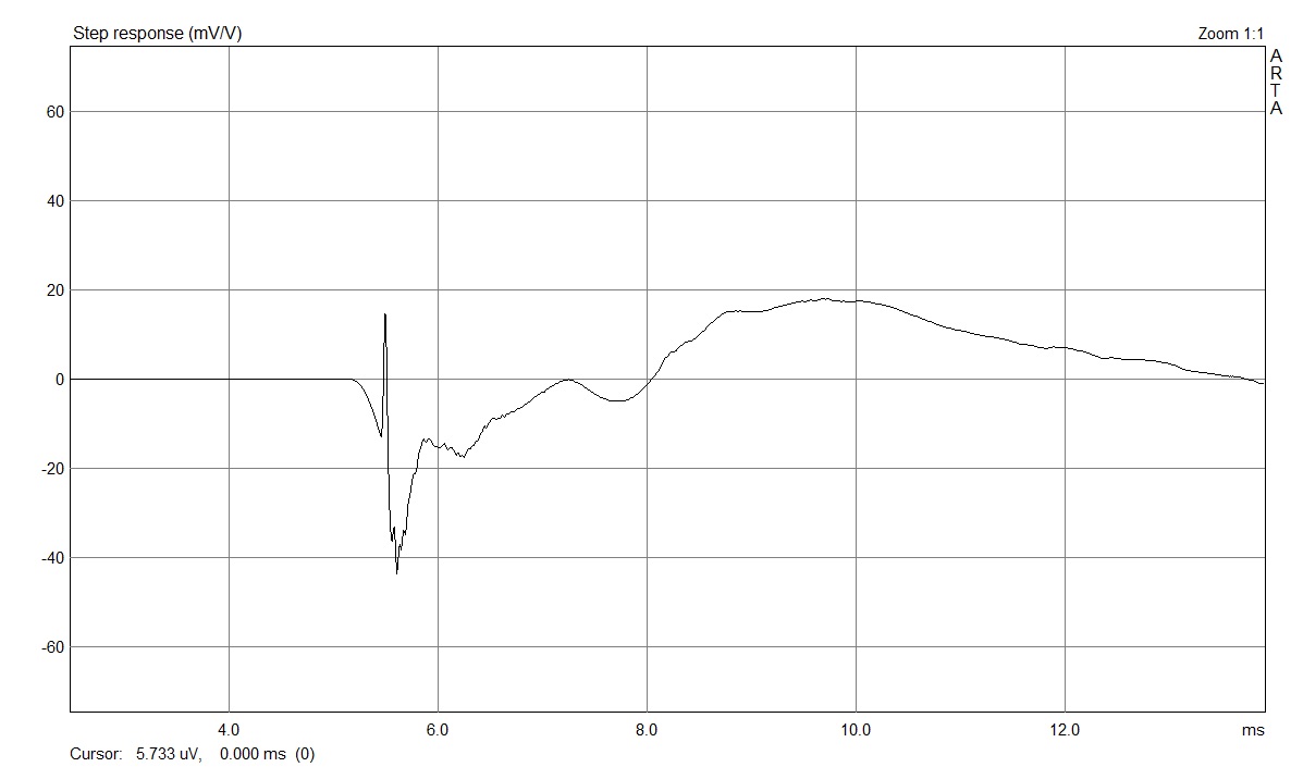

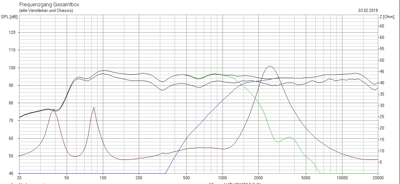

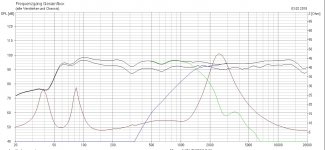

Max 1 try
I gave the project up ... the old Forte II pleased me more.
Nevertheless my last try with a Max1 inspired build.
Maybe someone will use....

I've been using 18Sound drivers with the Beyma FD250 crossover in PA 12" & 15" speakers for long time and they sound as good as compared with Yamaha / Turbosound / JBL stuff. No I didnt't take any measurements, just tweaked the HF attenuation on the crossovers. Do they have a flat response ? I don't know, but I don't like flat music either.
