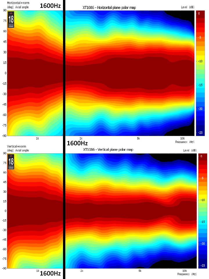

3) Charle's cabinet butts the XT1086 horn to the top sharp-edge board. Since a 1600Hz wavelength is 8.5", a taller cabinet with the XT1086 1"-2" below the top PLUS a radius top edge can have smoother, more uniform treble directivity through the crossover's 1st octave.. i.e. the midbass does not have to compensate for the -1600Hz drop at the cabinet's top edge.
4) Charle's cabinet appears to use a 0.75" walls. My sketch, like the BMF-1, assumes 0.75" exterior Baltic Birch glued to interior 0.75" MDF for big-box strength and some vibration control from different mass densities, which requires a 1.5" wider cabinet.
5) It is common to put the center of the horn at ~ 40" - 42" ear level, creating a 46" - 48" tall horn cabinet.
6) 1600Hz Xover looks best

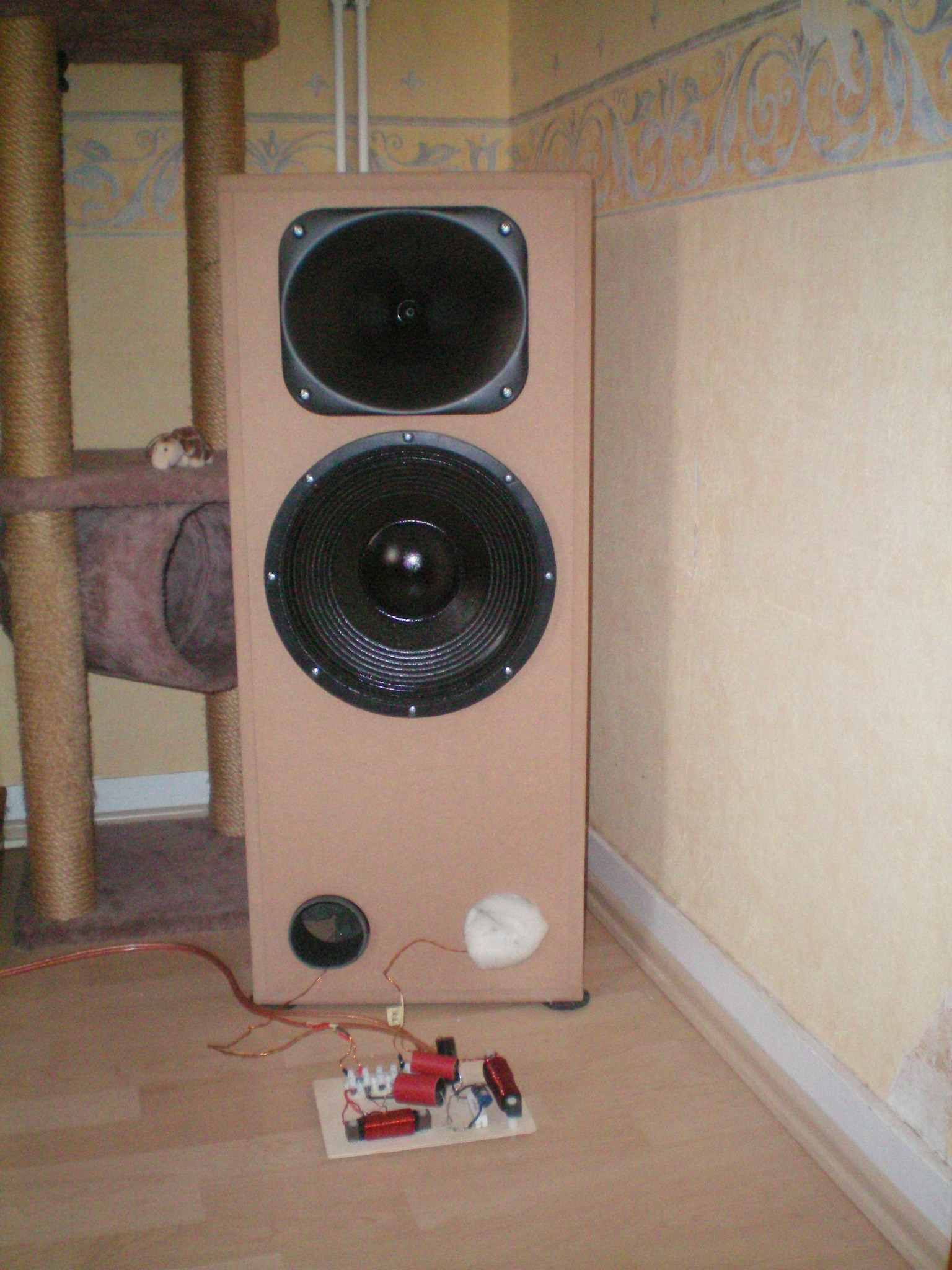

To make things clear: This cabinet is not finished yet ! The picture has been taken before even the reflex port had been routed. The whole thing will be run as two-way (i.e. no sub)and I don't want to cross over in the 6" woofer plus dome territory. Although I wouldn't mind going a little higher if necessary. It would even make the intended group-delay equalisation a little easier.
The 10" shown is a real woofer. It is not a PA low-mid but a crossbreed between PA and HiFi. These things are not easily obtained anymore nowadays but were available in abundance during the eighties when fostex, coral etc made lots of drivers like that. That's one of the reasons for the size, the other reason is the compartment on the backside for the electronics.
I know I could countersink the 1086 also but that was too much of a hassle to me. The cabinet edges will also get a small roundover but only for aestetics, they will not have a lot of effect acoustically. The board thickness is around 0.75" the baffle thickness is slightly below 1". Vibration control will be done by the use of Hawaphon and felt.
My targets were full range capability (i.e. cutoff below 40 Hz), very low crossover-induced group delay distortion and dynamics (it will not go as loud as a box with PA drivers because of the efficiency in the low ninties and a nominal woofer power handling of 120 Watts, but now you can see why I can probably cross the HF driver lower than 1200 Hz).
Regards
Charles

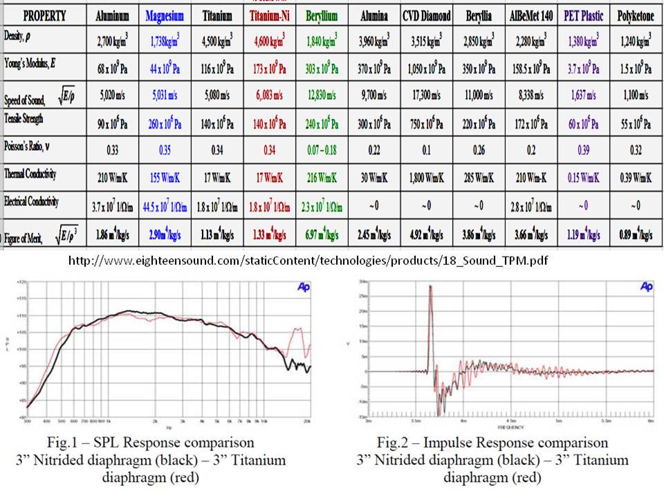

--Bragging data for TiN diaphragms $$
--Bragging Tech behind side-side woofers $$

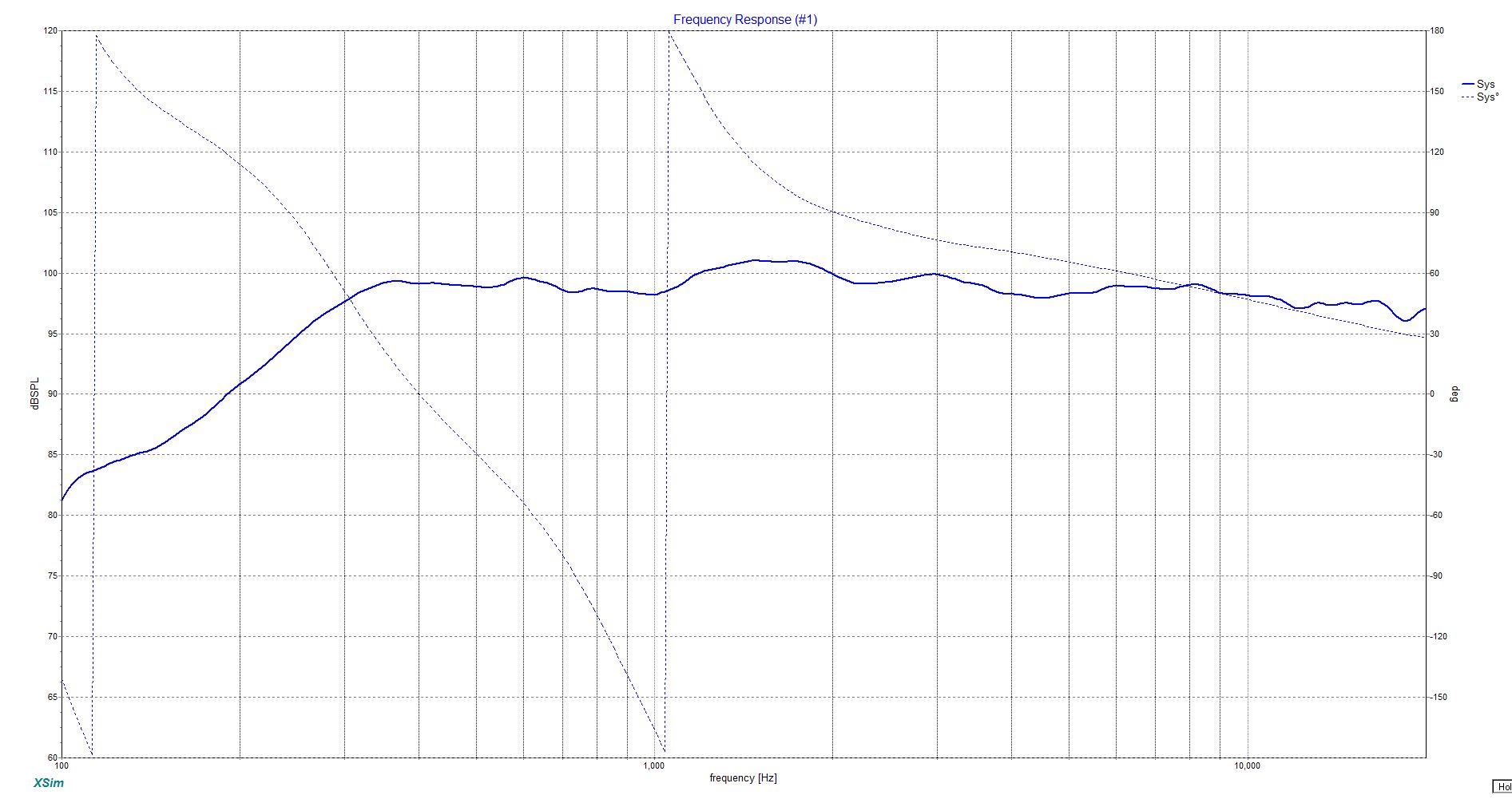

--Quick XSim LR4/LR4 crossover of the XT1086+NSD1095N to the 12 NMB420
----FRD and ZMD came from 18Sound Plots.
---"SPL bump" from 1K-2KHz from sum of 12NMB420 beaming plus the start of 1600Hz XT1086 peaking...wait for real measurements

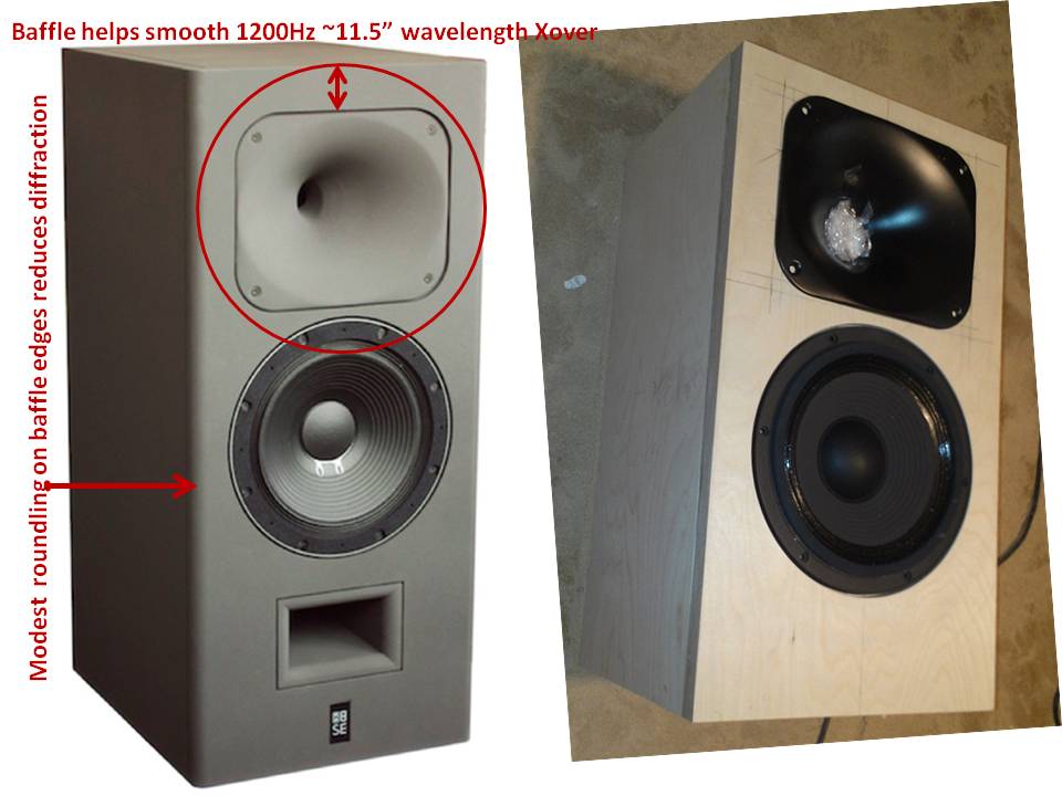

BTW: This one is what inspired me, it does also use this horn with an xover frequency of 1200 Hz: STRAUSS-ELEKTROAKUSTIK
Looks like a well designed monitor. The XT1086 horn has the rare 27-degree mouth that exactly matches the 18Sound 1" compression drivers.
I've noticed that some engineers use the horn position on the cabinet baffle to improve the crossover performance, or to tweek the polar pattern for a smoother controlled directivity function.
Measure...Design...Measure...Design....Measure...

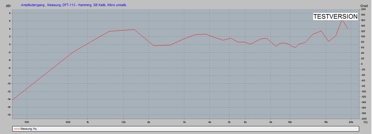

For those who are interested in the performance of the Faital HF10AK on the XT1086 horn I made an informal measurement tonight. The response shown is on-axis. Driver laying on the floor, horn facing upwards (without any baffle). Measuring distance was 70 cm.
For the price of this combination I would say that it measures quite well. There is nothing that couldn't be EQed with reasonable effort. And I think a crossover point around 1300 Hz would also be possible with this combination for loud home listening levels.
Regards
Charles

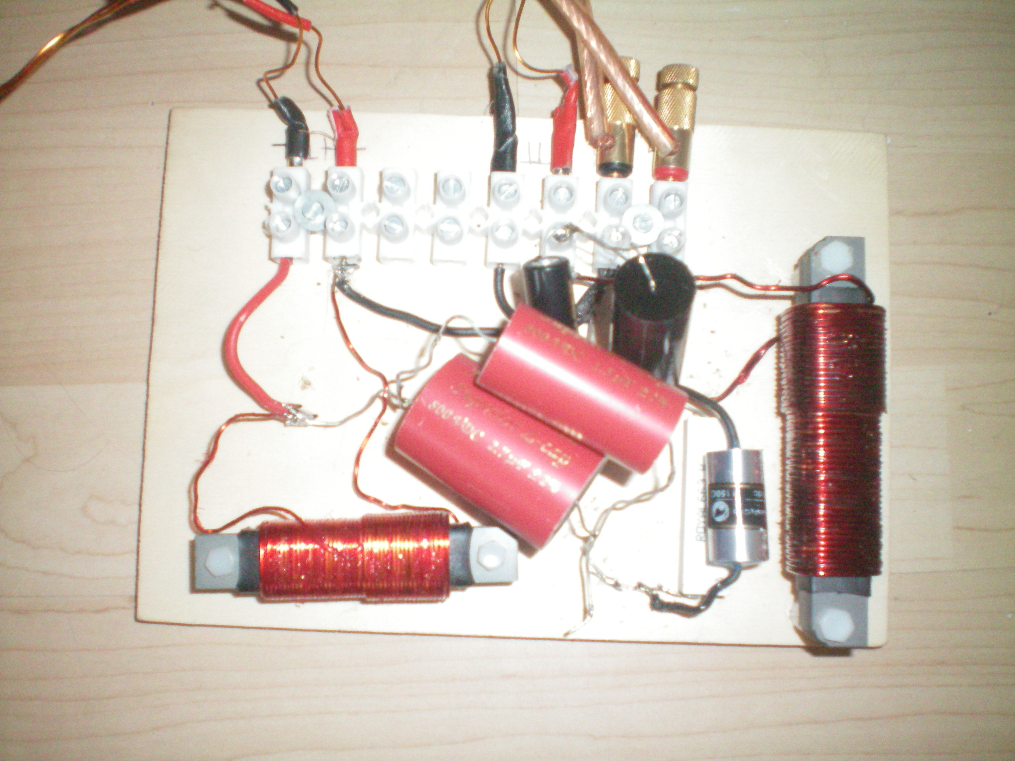

Caps used are the Jantzen Z superior. Volume of the case around 75l.
Tuning of the ports is still to be done.
Sorry for the mess on the crossover board, it was the 579th change.....:hypno2::hypno2:

yeah, the crossover point is near 2kHz.
I fully understand what LineSource commented....about shortcomings.
Nevertheless the reviews are mostly good and I had bought the speakers before reading Line Source lines.... 🙂
So no way back, too much money.
They sound for sure more precise in all aspects than my old Forte I.
But maybe they need a crossover change only.
