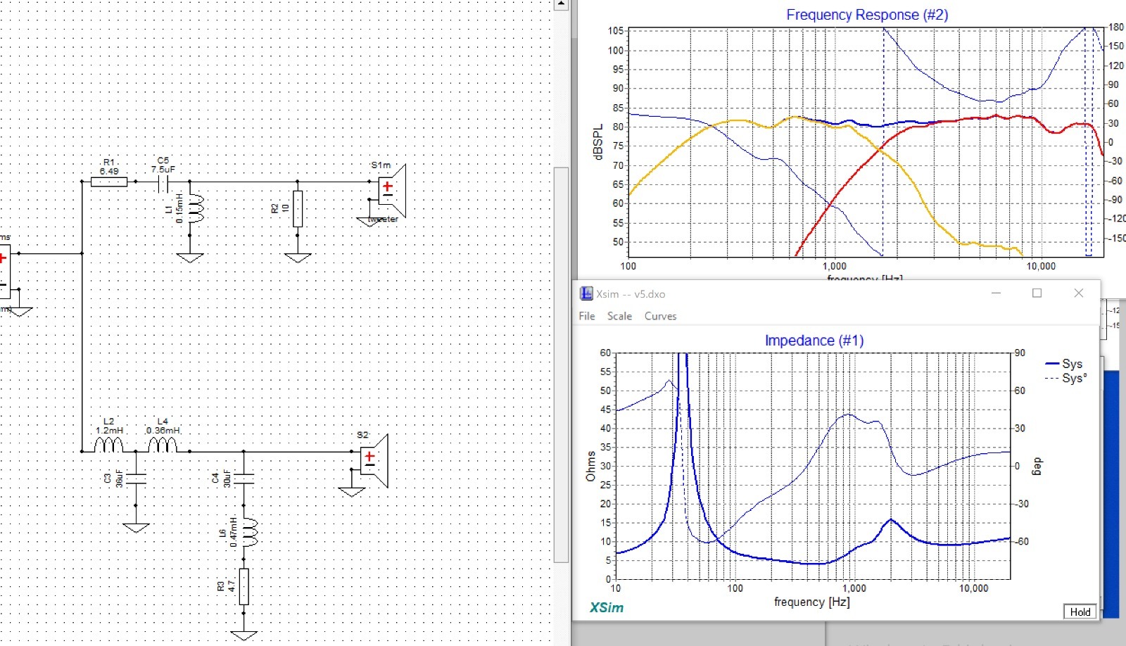

I modelled your driver and crossover in Basta, with a 200mm by 350mm baffle. This doesn't use the measured response (and I'm guessing your baffle size), but it helps me to see what your crossover is doing.
Thank you for taking your time, your estimation isn't that off, but it's more like 160x350, quite a narrow baffle...
I'm surprised by your LCR trap - it's giving a broad reduction centred around 1kHz. (And the revised version is maybe centred around 800 Hz?) But the driver datasheet doesn't show any significant surround resonance or other peak in that region. Are you using the LCR trap to reduce baffle step? If so, why not use a more conventional LR baffle step circuit? (Then, if you do want to reduce the breakup region, maybe use an LCR trap? But you're probably OK without that.)
It's indeed for baffle compensation. The LR was too broad for this application, it was lowering the spl below 500hz and I didn't want that. If you look at my raw measurement for the woofer I think you'll see why:

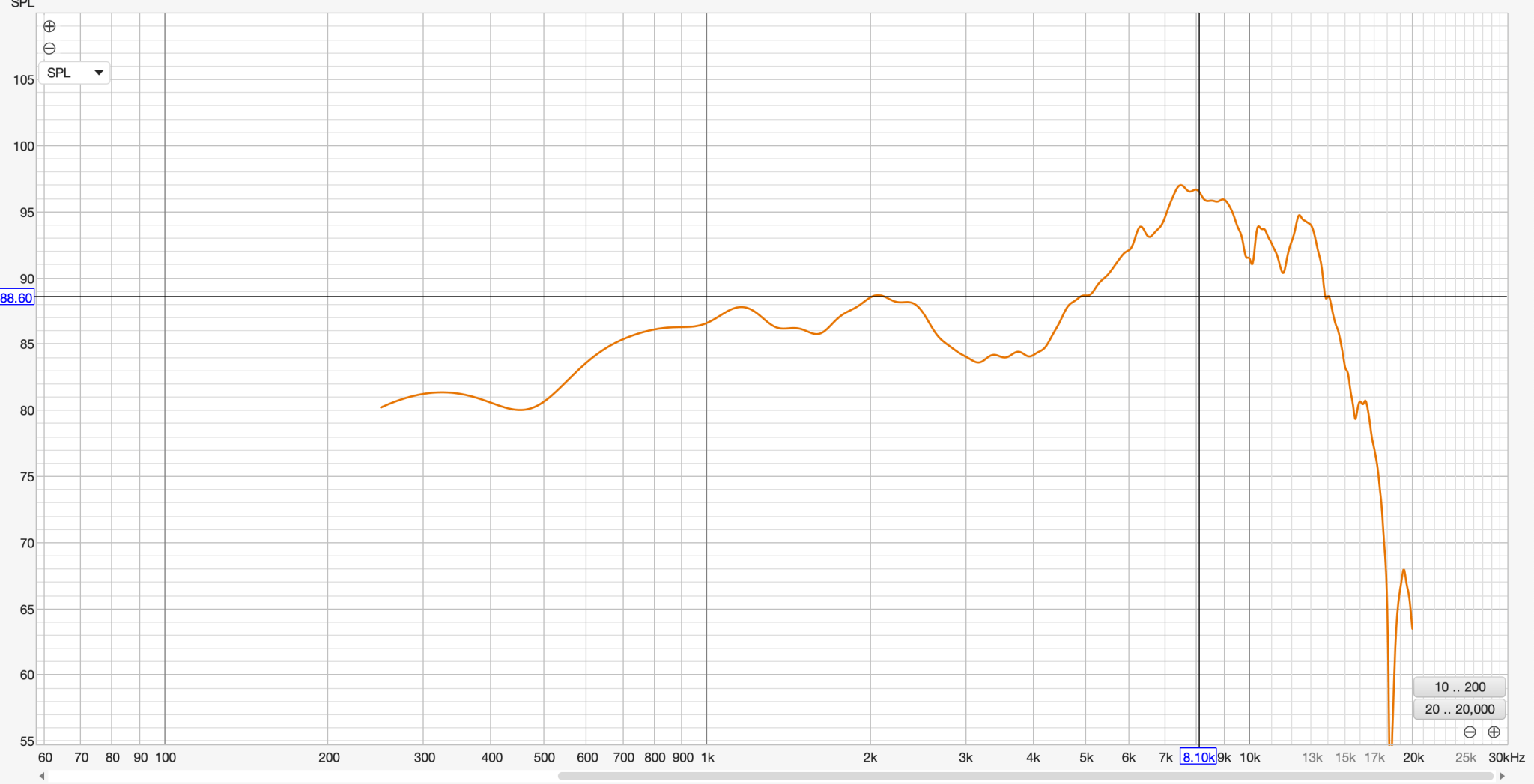

Fair enough. That 450 Hz dip in the raw measurements is a little odd, though. Are you sure it's real, and not a measurement artifact?
(The datasheet shows no sign of it, and I don't see how the box dimensions could cause it. Did you do a near field woofer measurement?)
I am almost certain it is not an artifact. There was another driver installed in this cabinet which showcased a similar response around that area. For reference, I measured other speakers at that exact spot, and I couldn't see anything similar.Fair enough. That 450 Hz dip in the raw measurements is a little odd, though. Are you sure it's real, and not a measurement artifact?

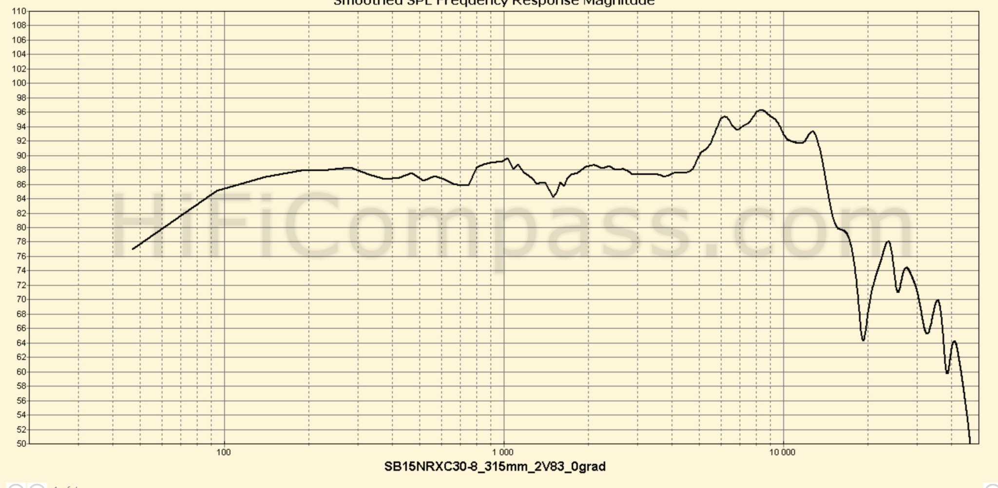

This is the FR measurement of the driver made by hificompass.
The woofer drops 3dB's from 1k till 700hz, combined with the baffle loss, I think it kinda makes sense why my measurement looks like this.
As for the near field measurements, I didn't really feel the need since at lower frequencies the room becomes more important than the speaker as you'll probably agree, and I use some room eq in almost every circumstance. But of course, it would be nice to see the overall picture and give a better idea about what's happening. All in all, I think I am just gonna trust my measurements for now. I believe I can live with a few dB's of deviation 🙂
Fair enough. That bump in the hificompass measurements is quite pronounced and might well be worth a trap. Personally, I think near field measurements are always worth doing - gated measurements have limited resolution down near the cutoff.

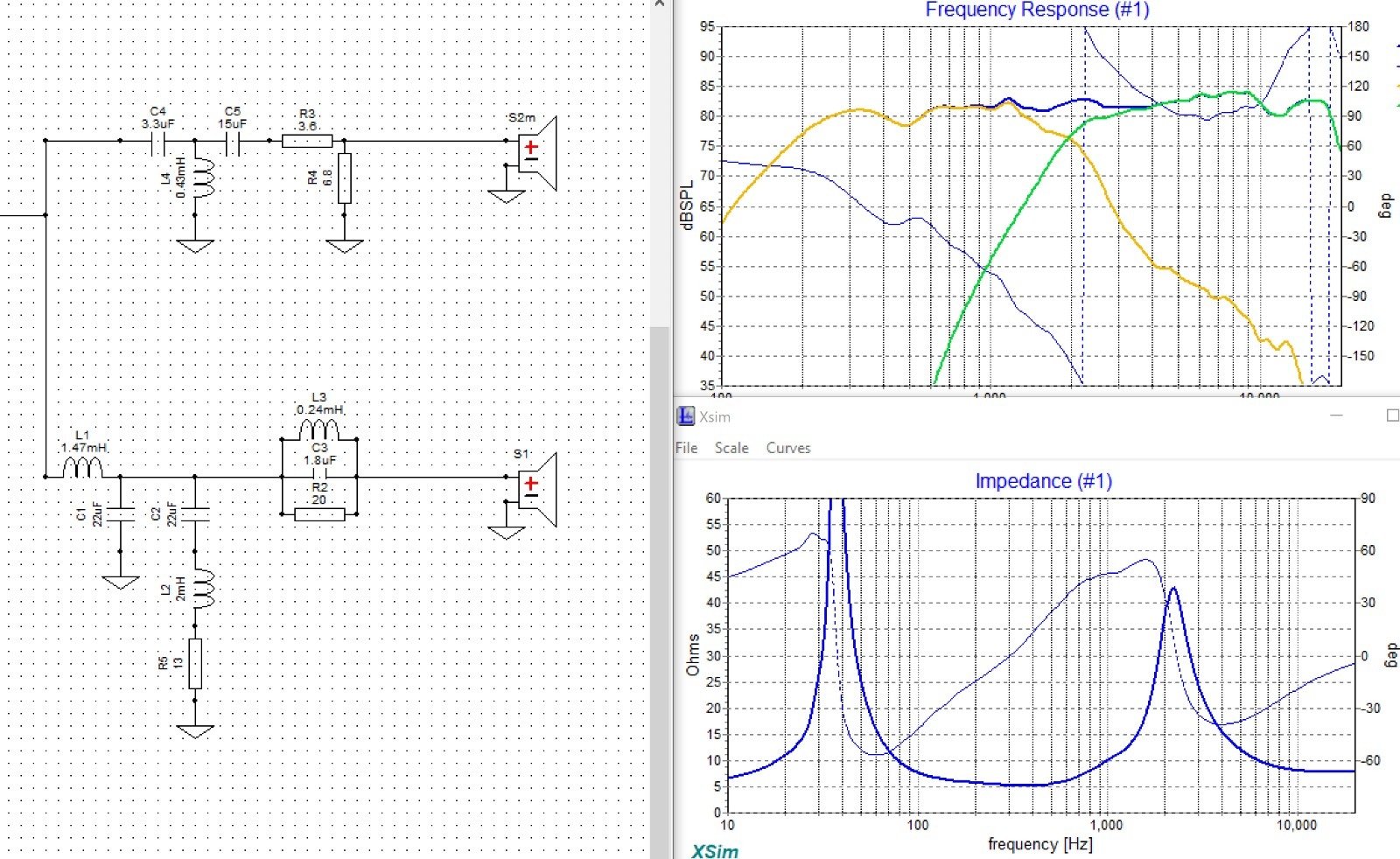

Thank you all for your opinions. Many people particularly suggested using a 3rd order filter on the woofer, so I have revised the design and implemented a 3rd order lowpass. The high pass filter had to be changed from 3rd to 2nd order (which I guess is even better since I am not going to use expensive caps)
However!
In order to get a decent FR and phase, I needed to push the xo point down to 1.65k. The tweeter's Fs is 900hz and I am using a waveguide which theoretically should make it work. (According to my measurements, the WG boosts about 5-6 dB's around that region) The thing is though, the filter is only 2nd order and I don't know if that's gonna be alright. How would you interpret this? Has anybody here crossed that low? (in a waveguide or as is) what are the pros and cons?

Assuming my measurements are reliable, what would you say about crossing this tweeter at 1.65k in a waveguide? https://www.parts-express.com/pedocs/specs/277-010-morel-mdt-29-specifications.pdf

Crossing the Morel in the waveguide that low is no problem, as the sum of the resistance and the impedance of the highpass will protect it very well, even crossing at 1,6k. The woofer will give up sooner, I bet.

I don't think crossing at 1.65k LR2 in a waveguide was going to create problems (especially at my preferred listening levels). If I was using a bigger woofer like 7 or 8inch, I'd definitely cross it there, but I believe it's the bare minimum this tweeter can handle. Considering the fact that the tweeter begins to show some signs of ringing around 1.5k, I think 1.95k 3rd order is the better choice.

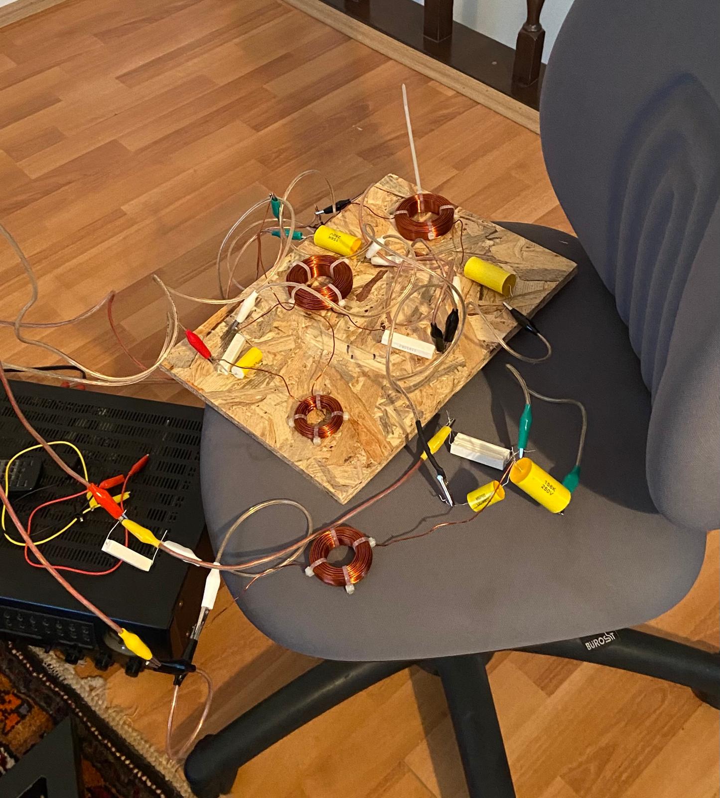

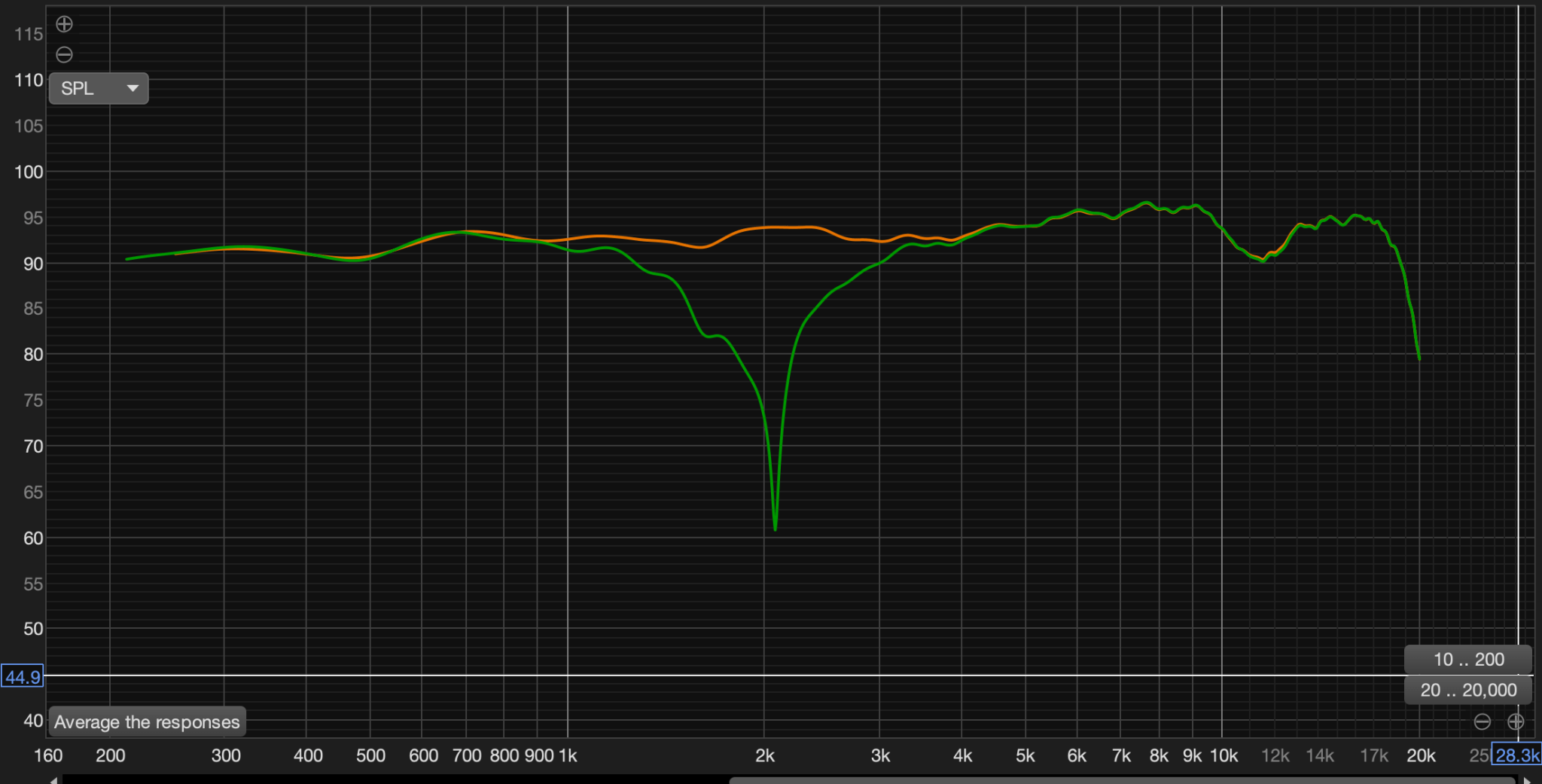

Just wanted to let you know that I built a prototype crossover and it measures pretty good I guess. Thank you all for your feedback.
By the way, does anybody have a solution in mind regarding that drop around 12k? (courtesy of the waveguide) Like maybe a phase plug or something?
