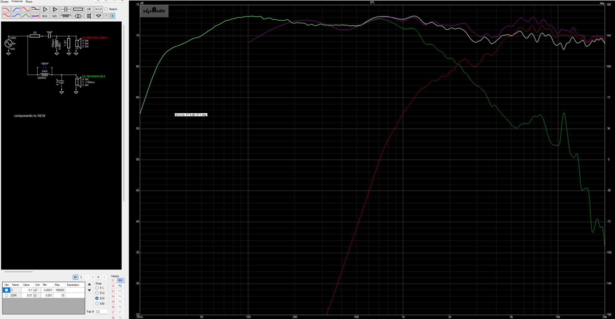

Let me share the difference C6 makes regarding the break up region:
The (benigne) breakup is 20dB below reference level. I doubt if it is noticeable, so C6 can probably be skipped. Or choose a 3d order electrical lowpass.

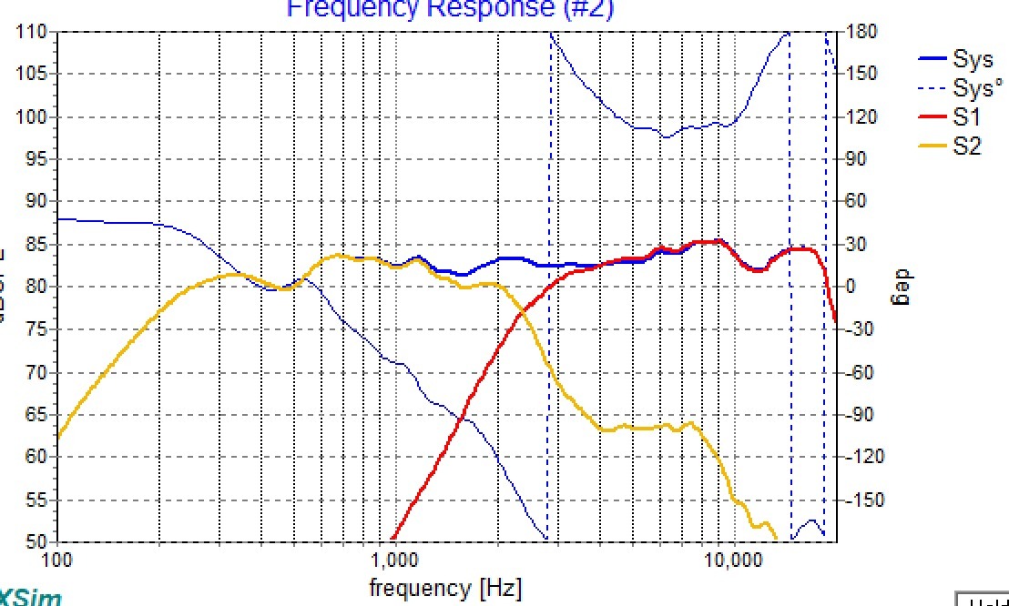

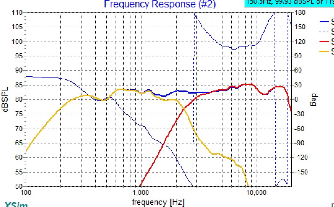

One of my designs uses your exact woofer, so I understand exactly why you ended up with your crossover. Here are my responses without and with a small 0.10 uf capacitor. It makes a significant difference to the cone breakup just as you had noticed in your design. To AllenB's point, there very well could be better alternatives, but this (at least with a resistor in series after the capacitor) is a very common filter.
That nasty break up combined with the baffle loss (also the fact that I put my tweeter in a waveguide) makes it very hard to get a good response and seriously limits your options. I really don't understand how so many people opposes this given the fact that so many designs incorporate it.

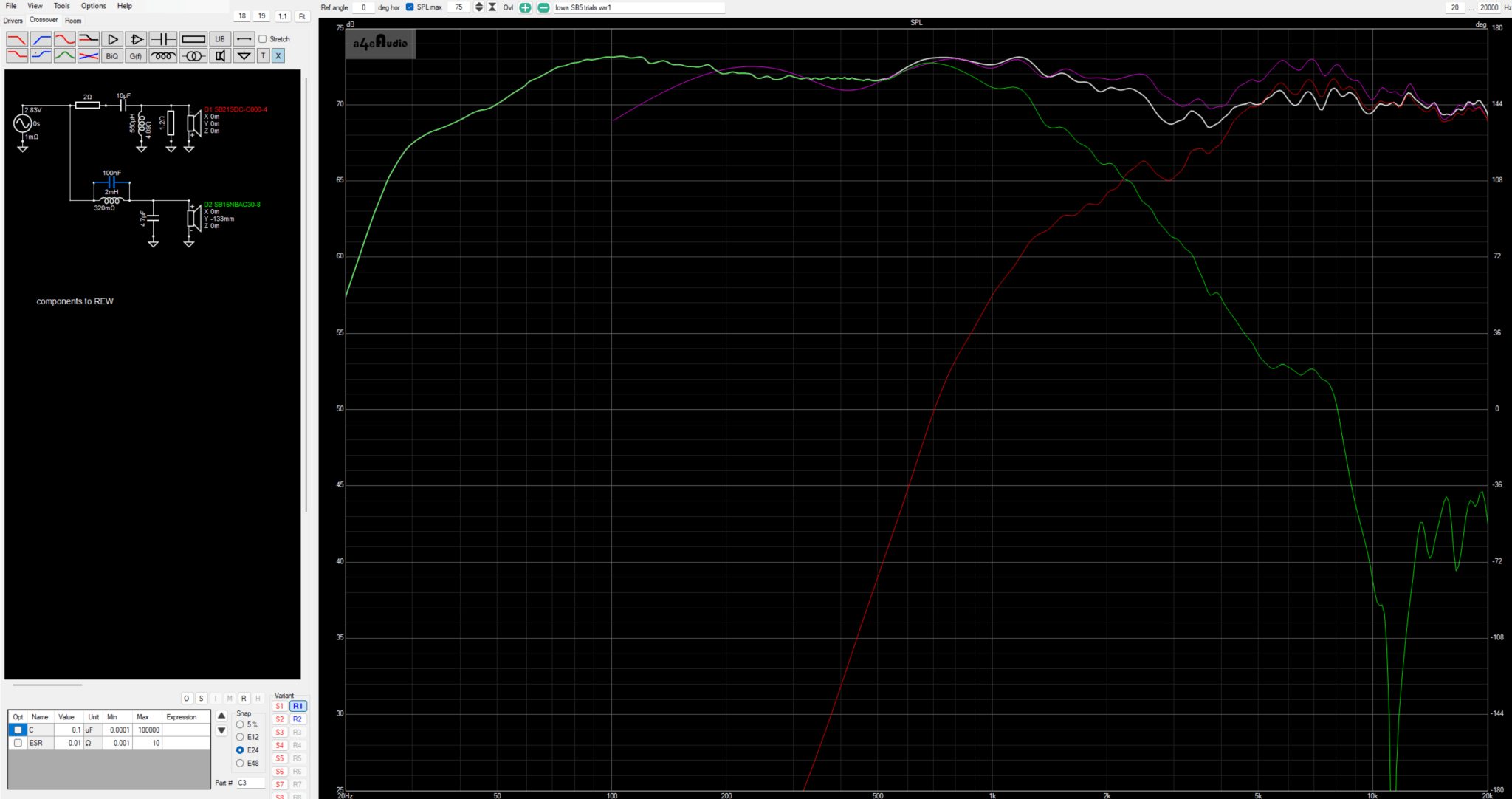

Below are the responses with and without the capacitor in question. This is my first proper build so I don't know if there will be an audible difference.

I did something similar with the cheap SB16pfc here to practice before doing it to a more expensive driver.
Wow, that is quite a difference. This much improvement would solve all my issues but I don't have the confidence for such an undertaking right now

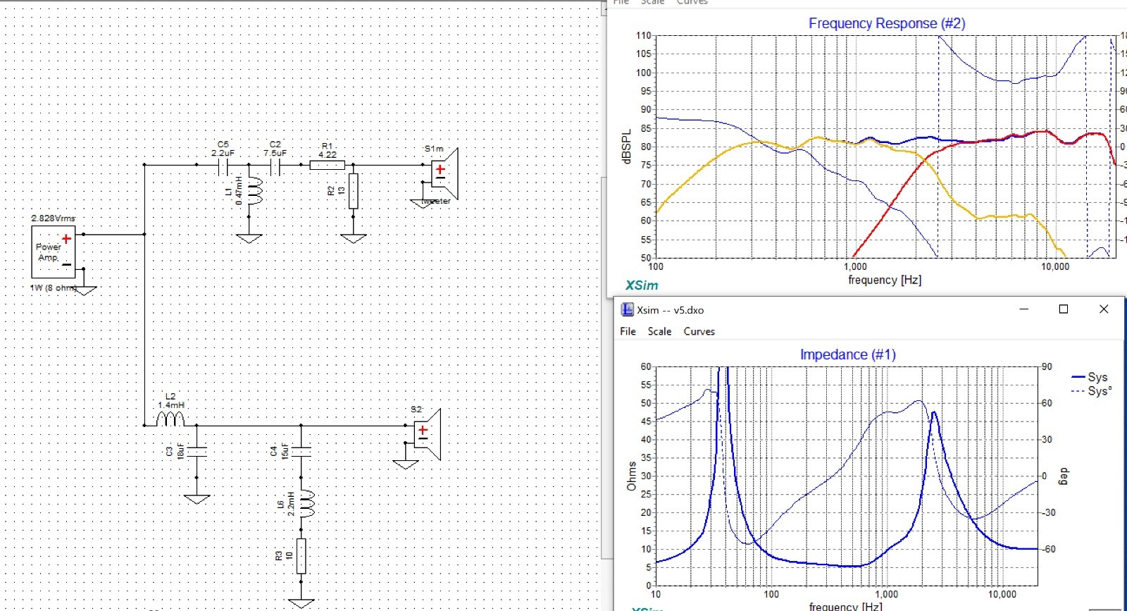

I modelled your driver and crossover in Basta, with a 200mm by 350mm baffle. This doesn't use the measured response (and I'm guessing your baffle size), but it helps me to see what your crossover is doing.
With your original crossover, it would be easy to add a resistor in series with the 0.33uF cap, maybe even as much as 12 ohms. You'd still get a decent depth of notch. But such a circuit always gives a pretty narrow notch, no matter the resistor value, and you're trying to reduce a broad breakup area. So it's probably best to omit the 0.33 capacitor altogether, as you've done.
I'm surprised by your LCR trap - it's giving a broad reduction centred around 1kHz. (And the revised version is maybe centred around 800 Hz?) But the driver datasheet shows only a minor surround resonance (or similar) peak in that region. Are you using the LCR trap to reduce baffle step? If so, why not use a more conventional LR baffle step circuit? (Then, if you do want to reduce the breakup region, maybe use an LCR trap? But you're probably OK without that.)
