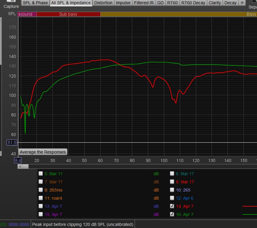

With 2 sealed i will gain more midbass, but can i rescue the rumble? I dont want to go 2 ported because then i loose the sq, plus needs a bigger box.
  • Power handling specs are useless blather says this loudspeaker engineer who has also spent time as a paid liar, er Marketing employee. Generally, the power limitations will be physical although you'd have to simulate to be certain.
  • As was noted a port uses resonance to increase output around the port tuning, the downside being that below that the cone unloads. Plus it's a RESONANCE so can sound bad-but to total effect depends very much on the tuning and the resulting shape of the response curve. "Undertuning" the port can yield some gain in output over sealed, but with a slower rolloff than ported, implying better time response and hence less boom. So there is a tradeoff between output and sound quality, yes. Bandpass enclosures have even more resonance and hence really strong sound which is generally then boomier and muddier sounding.
  • But maybe you LIKE the boom? If that's what you need by "rumble."
  • More non-boomy output is pretty much going to require more total system box volume, whether sealed(s) or ported(s).
