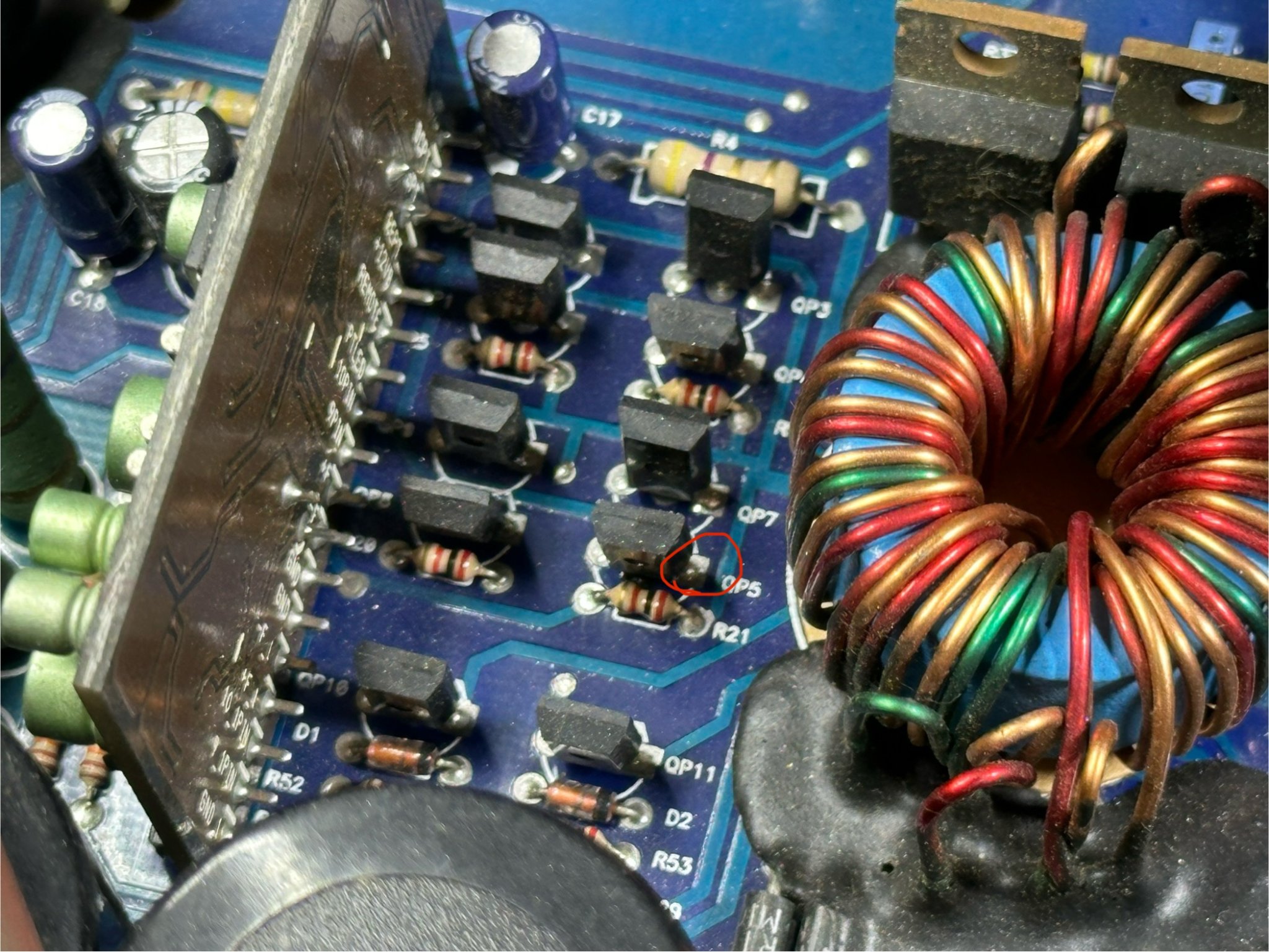

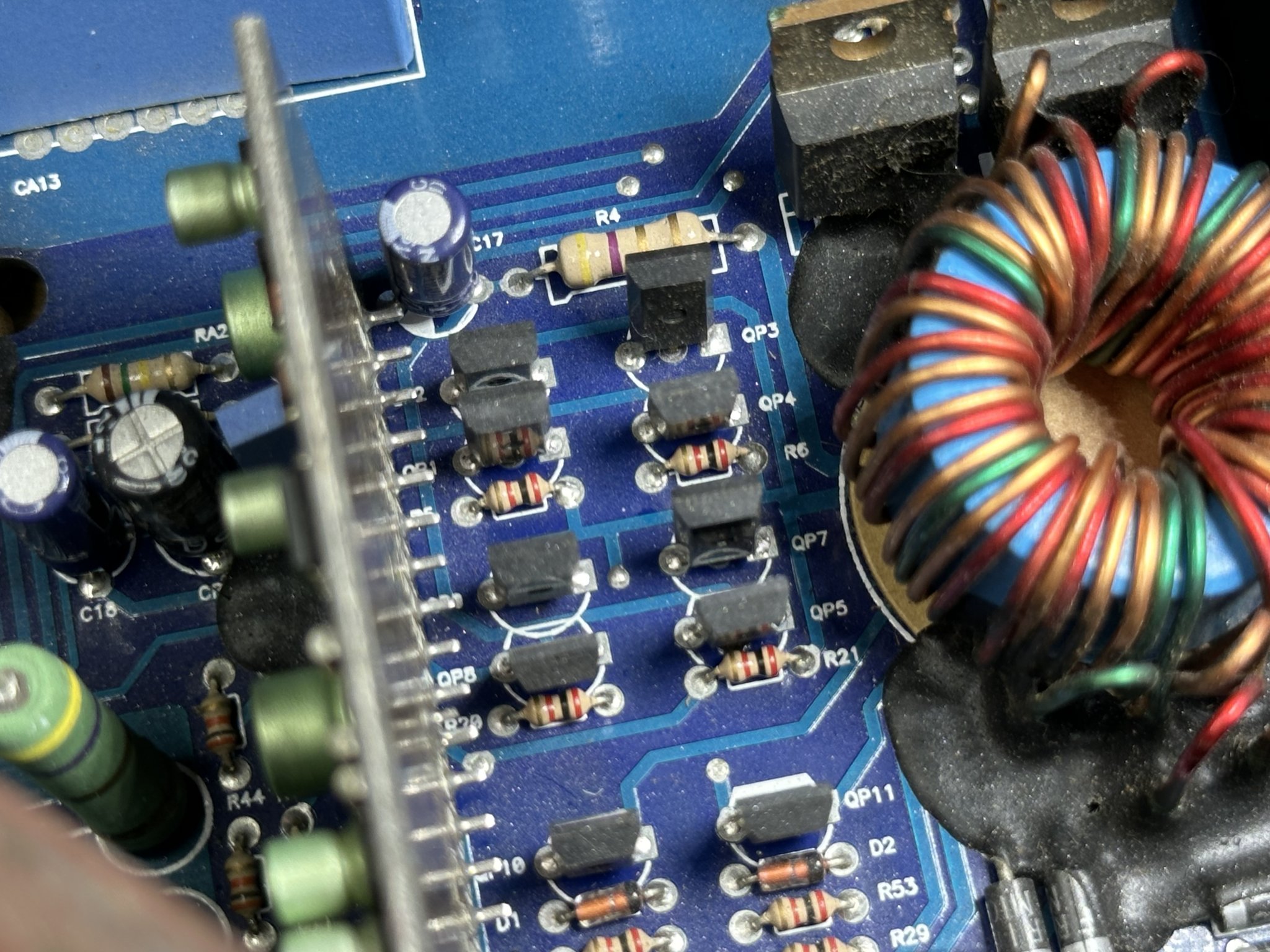

I’m not good with reading resistors as I’m not sure which side to start with but it looks to be Gold, Red, Black, Red
Gold and silver are tolerance bands. I don't think I've ever seen either as the first band.
Ignoring those when on the end, look at the bands from the other end. These are 2k ohms. They are reading 1k because the two driver groups are in parallel.

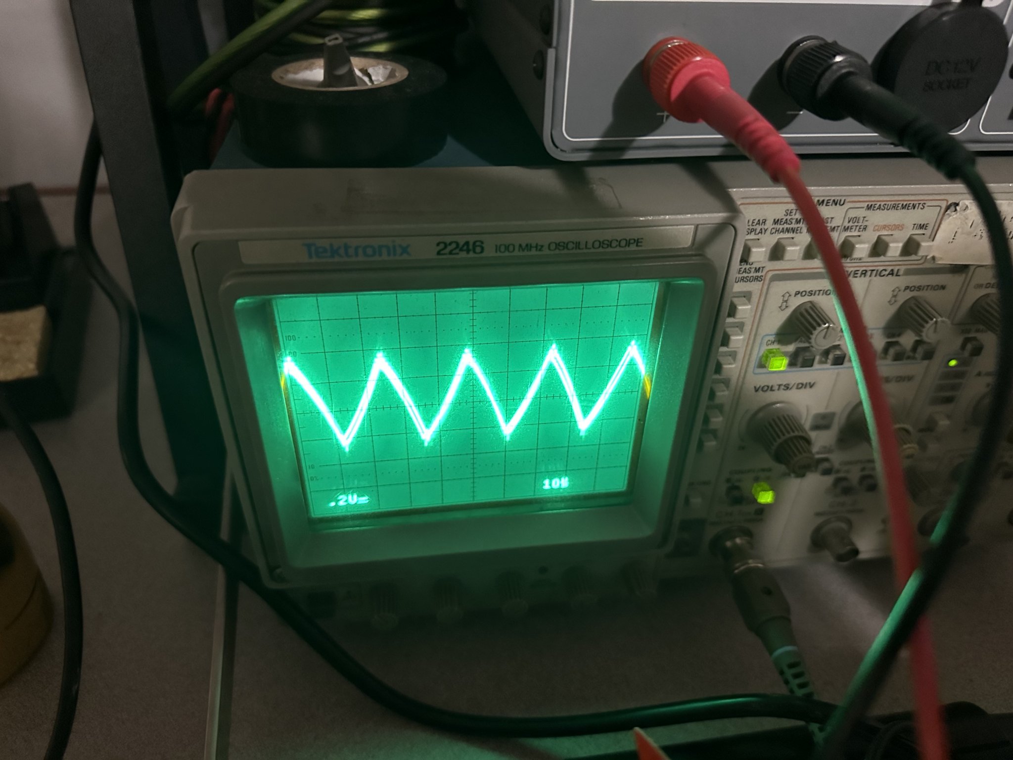

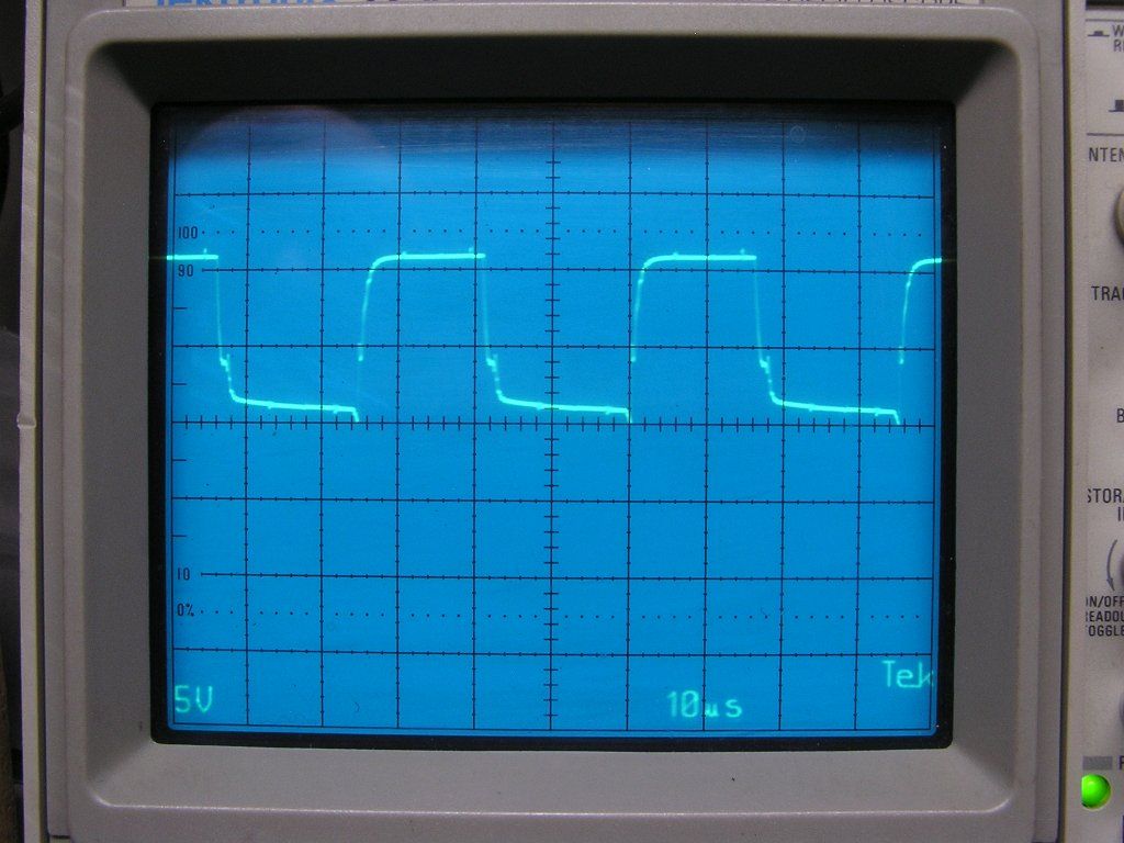

What's the operating frequency of the supply? Check it on the base of the driver transistors or on the terminal of the 2k resistors connected to the base terminal of the driver transistor.
Some multimeters read frequency.
If your scope is relatively well calibrated and the var controls are set to the 'cal' position, you can use that to get close. Generally, with the scope set to 10us, you will see approximately 3 complete cycles on the display (see attached).

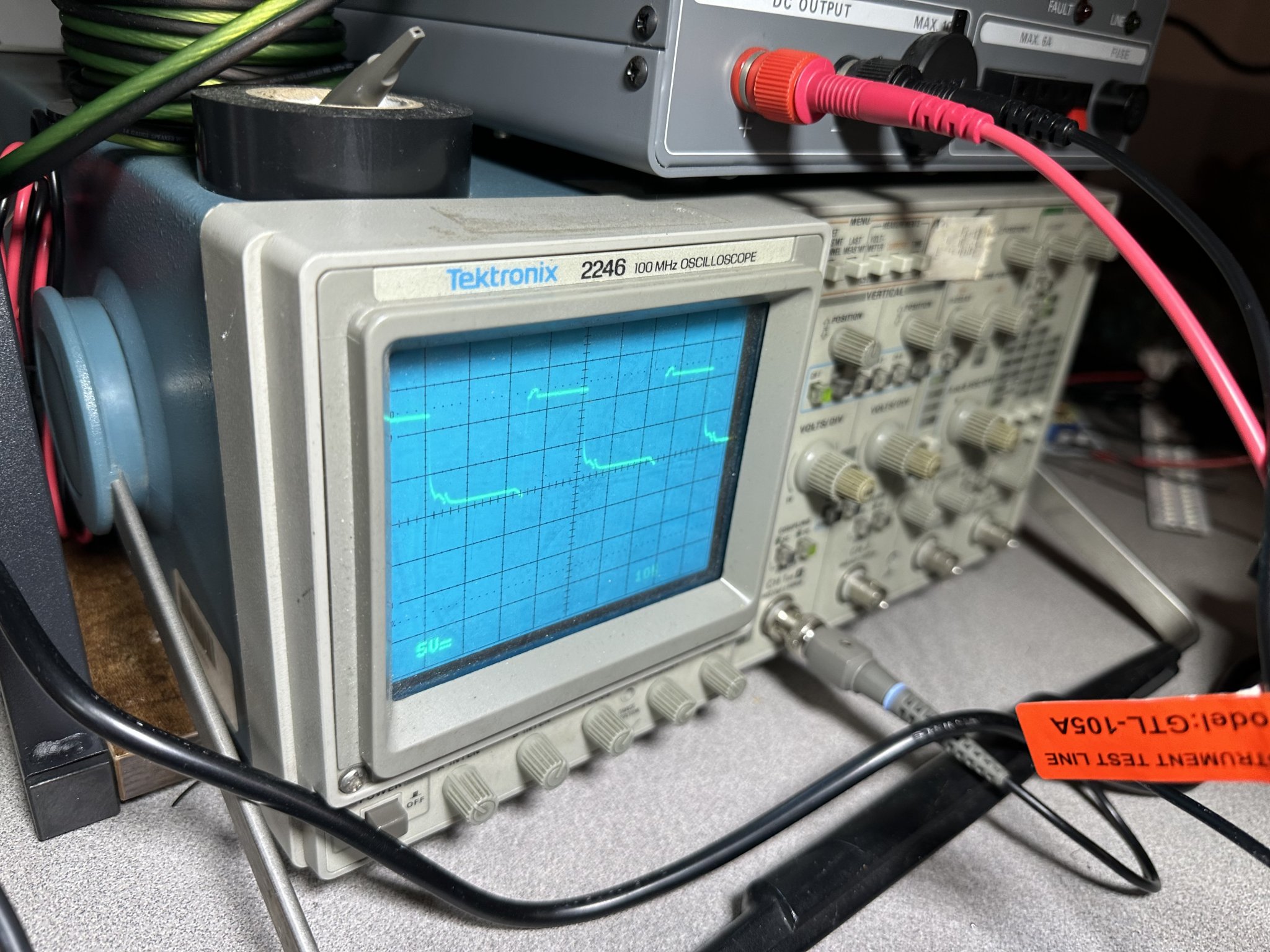

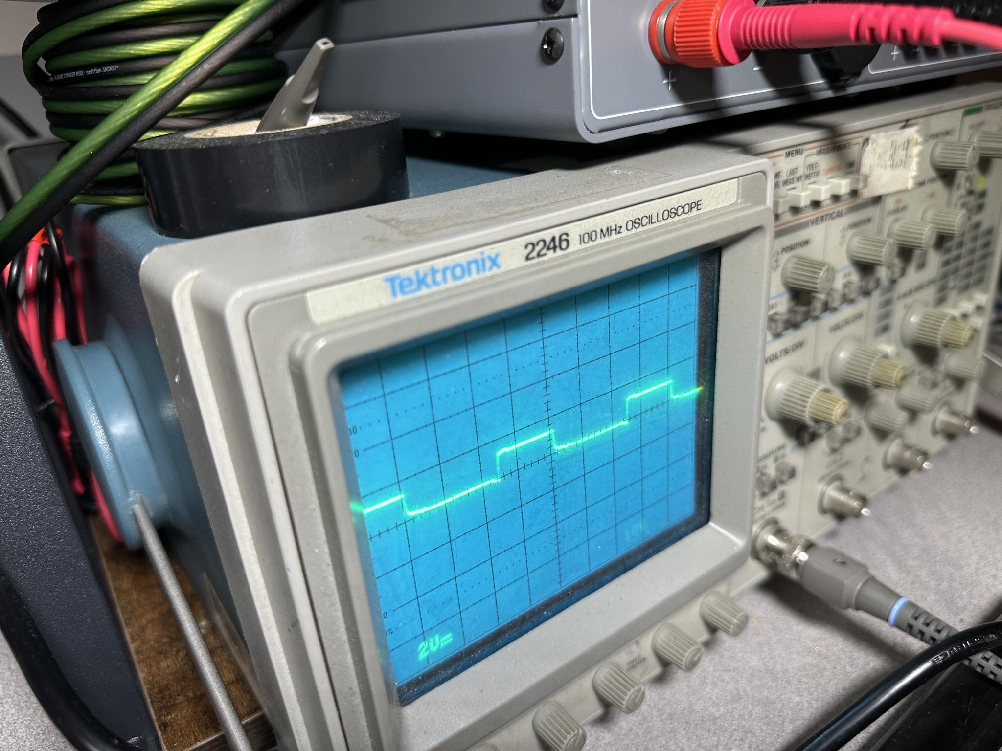

Readings from contact circled in red, not sure if this is good or not
First pic is at 1x and second at 10x (probe)
