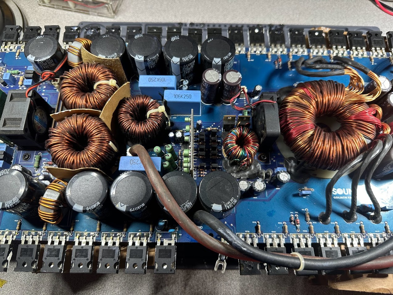

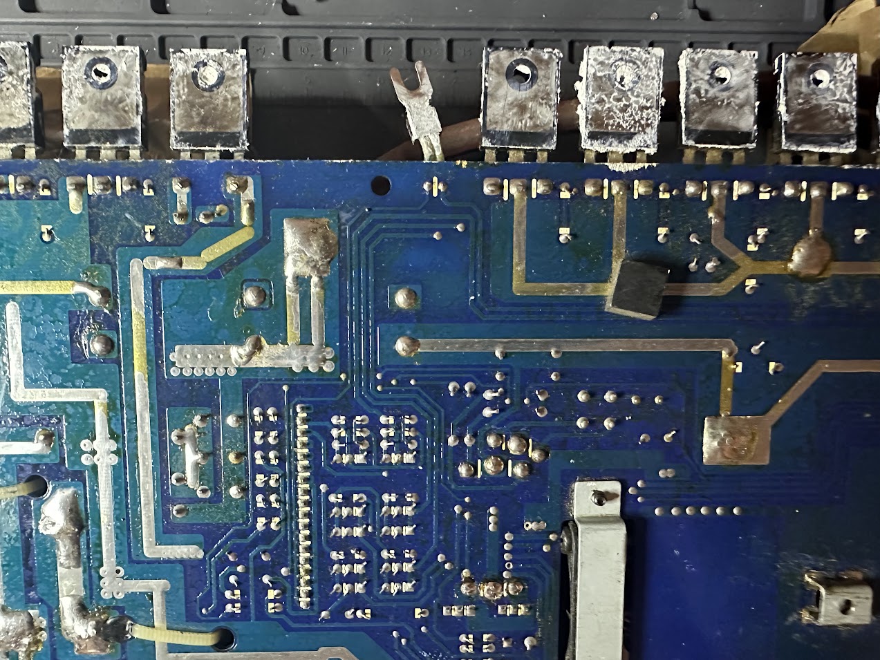

Amp will no longer turn on

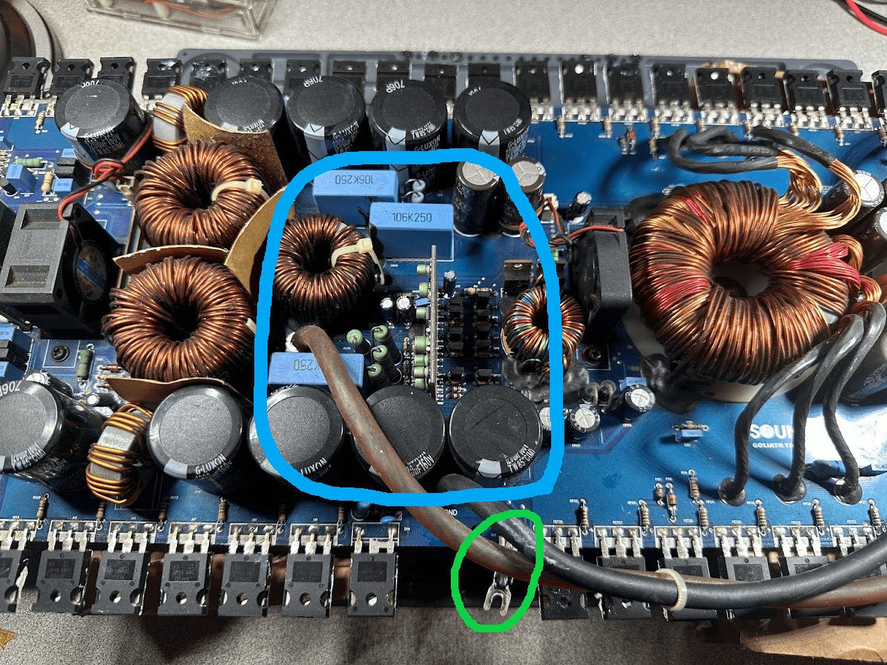

I had got it to turn on and it started making a buzz near the blue outline (louder than the power supply buzz, sounds closer to maybe an arcing?), changed voltage from approx 15 to 14 and it started freaking out so I shut it off. Go to turn it on again, it will try and when it gets close to turning on it starts making the noise again and will not fully power on.
Also is the green the thermistor?

It does not, I tries to but does not fully turn on
I was able to get the relay to click once but it then went back to trying to start up
I believe that sound I heard is something shorting and discharging current preventing it from turning on
I believe the power supply may be too weak to properly power it up as it can only output 3a max, looking into getting a new one soon, not sure if I want to use my pc power supply as I cannot current limit it or change voltage though
I think the pulsing of the remote and the input to the protection circuit could be complicating the troubleshooting.
Insert a 10 amp fuse in the B+ line and use the PC supply. You will still need to monitor the temperature of all heatsink mounted components when the amp is powered up.

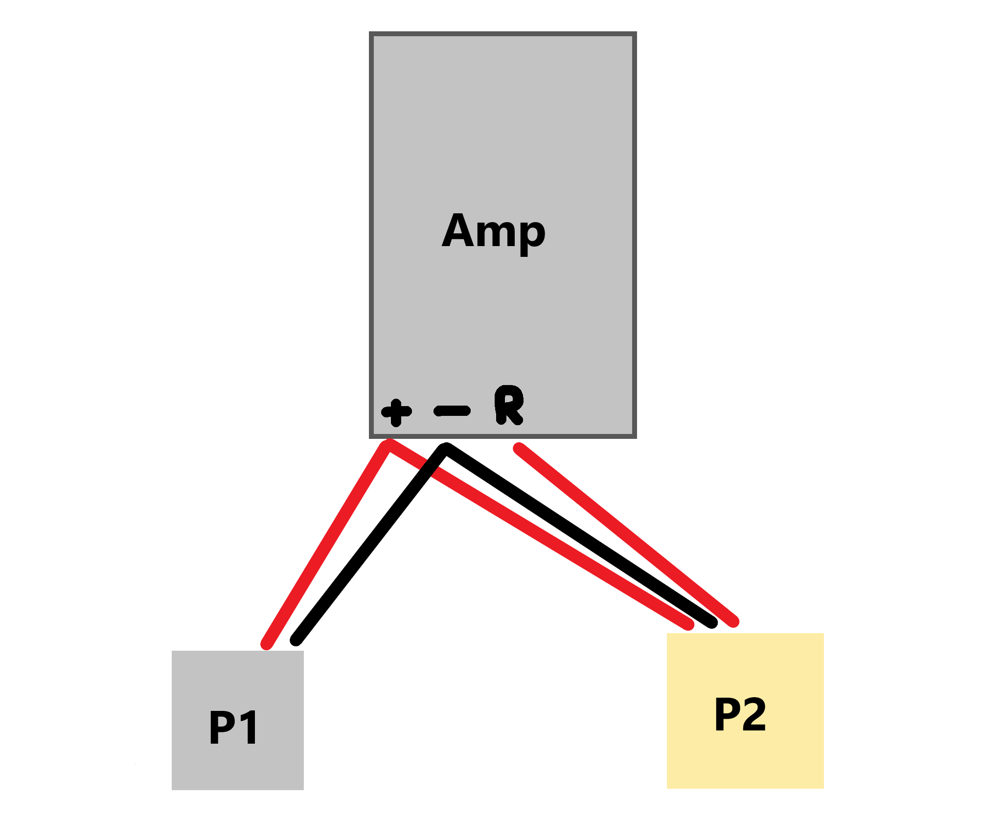

Going to give an update here
Purchased an in-line fuse, installed it, installed an additional switch on remote wire, and rewired my pc power supply as the extra factory cables were getting annoying and upgraded +12v and ground wires to 14g from whatever was factory
Power supply has issue that it shuts itself off when it powers on an amp (you have to turn it on/off a few times for it to stay on then its completely fine, this works for my x3 4channel but not the xxx, this was occurring before the rewire) my thinking there's an internal current limiter that i have to do some research on if i can find and remove it

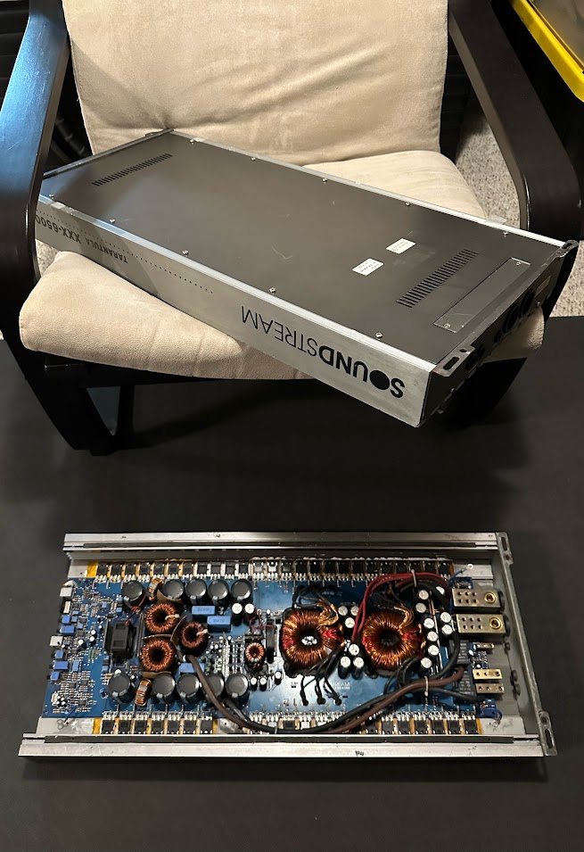

I brought in my other XXX amp so now we have a parts amp if needed down the road
Will update again when I get my power supply issue fixed, or I purchase a more powerful variable power supply

The small supply would only connect to ground and remote.

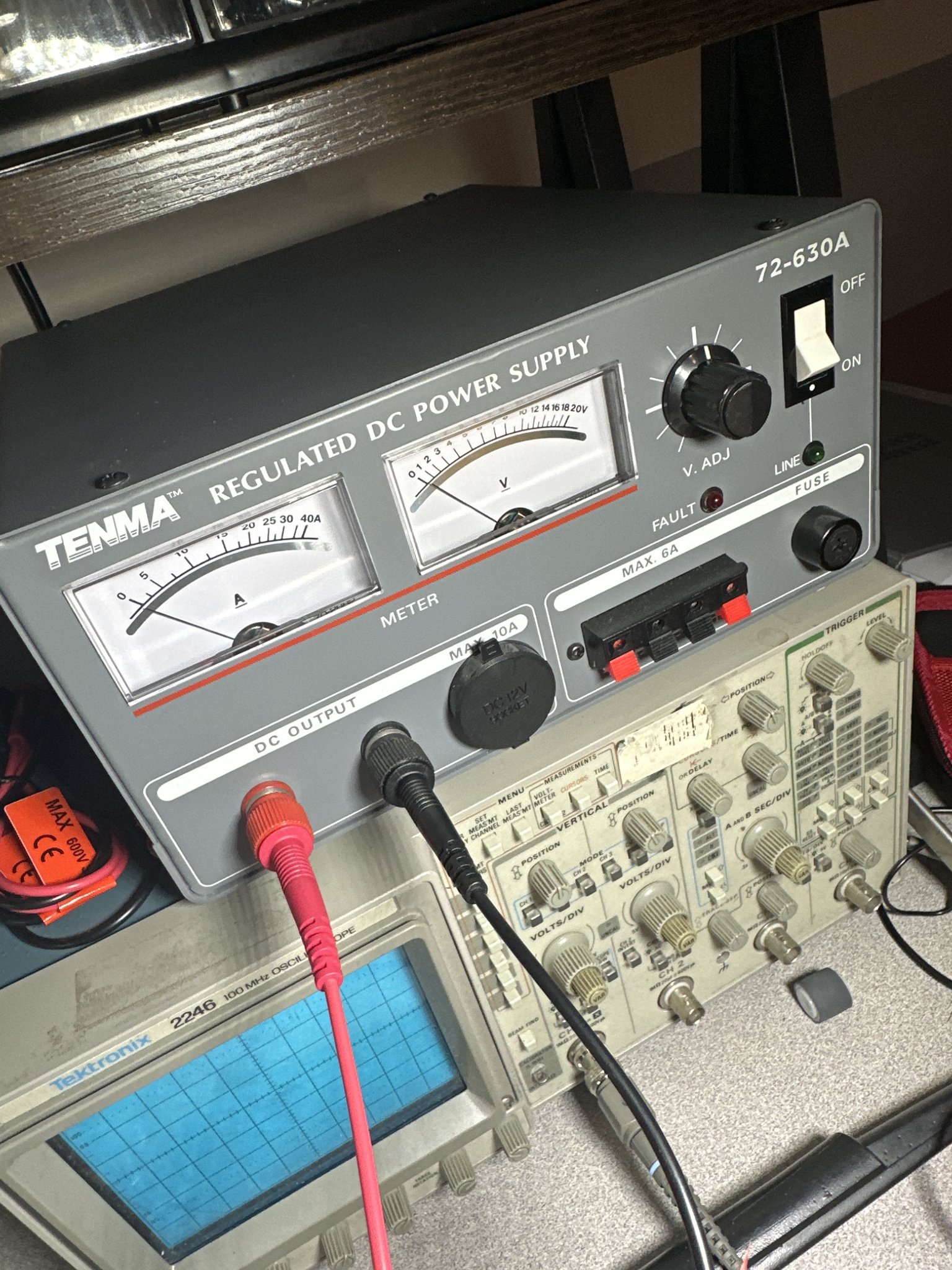

I bought the Tenma power supply it works great

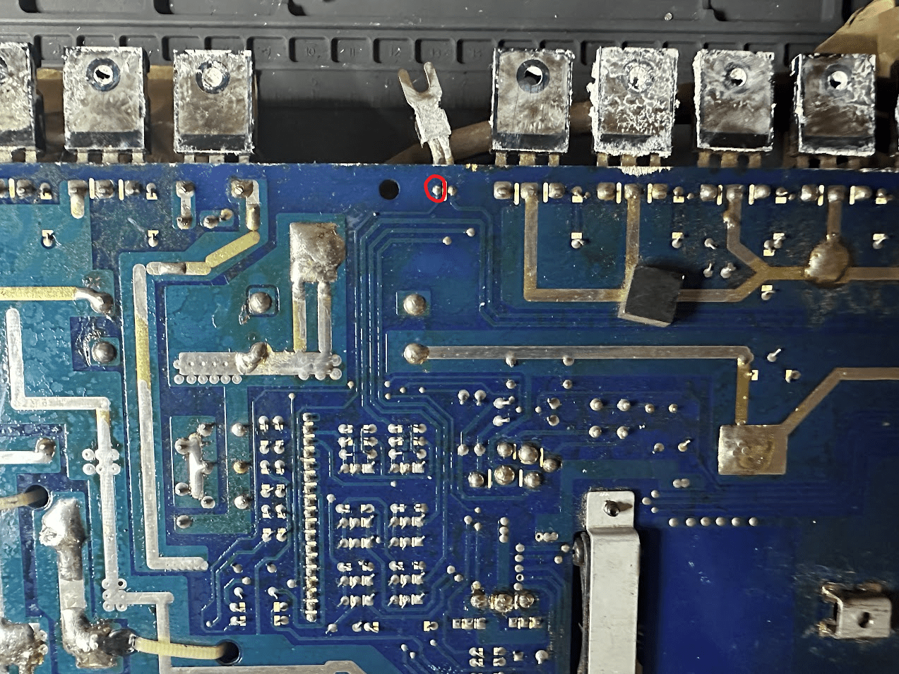

With 10a fuse amp turns on and idles at 5a
FET22, FET23, FET24 get pretty hot at idle, rest don’t get as hot
I’m getting a few whiffs of a smell I don’t like (“magic smoke” similar smell)
