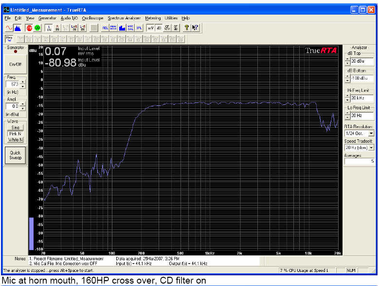

Here is a frequency sweep on the Azura 160hz horn.
Look at the amazing low end response from that tiny diaphragm:
