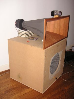

The JBLs are in 10 cubic foot sealed boxes, stuffed with fiberglass. They are made from 3/4" MDF. At some point, I want to make new boxes with more interior bracing and constrained-layer damping, but that will have to wait until I have a lot more time than I expect to have anytime soon.
I'll try and post some pics in the next day or two.
Re: PIC: JBL 2226H + TAD 4002 + Visaton TL-16
I like it!
have you more info about squawker horn?
garlandstephens said:They are bigger than this picture suggests - about 4 feet tall by 3 feet deep.
I like it!
Nice Job Stephens.

Re: Visaton TL-16 H
tnx for that,but nope 😉
I meant on mid horn
I meant on mid horn
sorry, not sure what you meant by "squawker."
I bought mine used, but they are frequently listed new on ebay.
Here's the listing where I bought mine, with a lot of pictures:
http://cgi.ebay.com/ws/eBayISAPI.dll?ViewItem&item=130037253513
