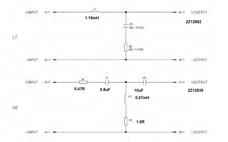

Right, thank thee for pointing it out to us! But transition is what matters most in a crossover. All series crossovers i have seen make at least Pi phase-turn. Behaviour far away from transition may be still important, but flanks should usually become steeper the farther away from the transition, not flatter.
Hi guys,
Appreciate all the info and really feel good to see people discussing a topic like this.
My understanding is that with one woofer having huge resistance spike at low frequently, two of them may make it a less load for the amps. And two woofers worKing at the same time at low range does provide more bass, as bsc does.
The huge inductor there is to damp the lower woofer at higher frequency and handover the work to the upper woofer.
It is a rather smart design for those who dont like big speakers with 8 or even 10" woofers.
A small room benefit from the design as i guess that is why b&w 603 is there.
How to calculate the l and c in a sxo please?Could you explain why? This is a more convential (electrical) 1st order LP, 2nd order HP, and it differs only in the placement of resistors.

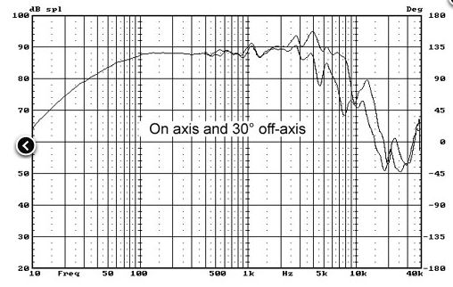

Overview F6 Bass-Midrange_HiVi, Inc.
Bit of a horror IMO. Wouldn't be my choice for a simple series crossover for sure, because your options are limited and drivers are best well-behaved. wolf_teeth did something with that HiVi F6 one in the Nephila.
A 2.5 way is quite a difficult speaker IMO. I'd start with a two way. Kevlar 6" bass and tweeter is not an unknown combination. B&W have made it their forte with stuff like the B&W 602 S3.
The tweeter filter is plain wrong for your 92dB Audax TW025m1, but a 4kHz crossover wouldn't be too hard. Maybe 4uF and 0.2mH and some resistors. Maybe third order. Bass loading depends on cabinet, but looks like reflex. Woofer is about a highish Le 1.8mH by my estimation.

- 2.5 crossover. Does it make sense?
