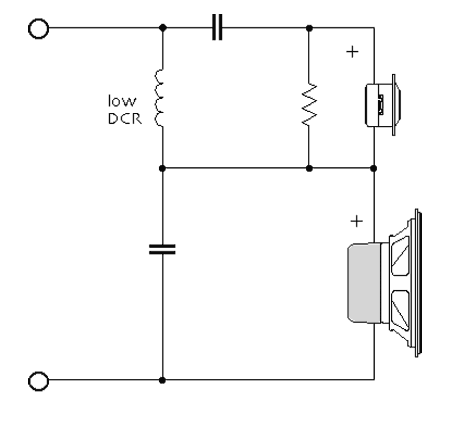

Recently I came across a very interesting crossover design for 2.5 network, which has positive feedback:
It was apparently evolved from this 2 way network:
My question is, what order is this?
It appears to me third order in HP, and 2nd order in LP.
What is the FC assume all drivers are 8ohm?
The 0.5 is not really a xover, rather a trick.
The 3.3 mh / 4.7mh coil on the woofer does not really makes for a low pass filter, it simply has a shelving effect that attenuates the mid range of the woofer and avoids phase interaction with the midwoofer.
For a proper xover you need to cross both channels, if you don't the result is an accident in the sum due to incorrect phase relation between ways.
Obviously, the mid/tweeter part of this set up has no xover, a 0.5 woofer affair is added/sticked in parallel to the 2ways series filtered mid/tweeter part.
Does it work? Yes, sure: Half works!😉
That .5 is there to compensate for the baffle step. The .5 woofer does double the SPL where it drops off due to the baffle step. This is not a more-or-less construction. It is a correct construction - except one detail: The .5 should be a first order lowpass but given that the woofer isn't a resistive load there schould be an RC series network parallel to the .5 woofer which helps to compensate for the effect of its inductance. Without it the lowpass is not really a lowpass but a lag filter.
The rest is indeed a series crossover with 3rd order HP and 2nd order LP.

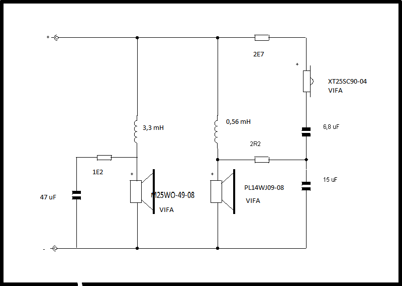

here is positive feedback of this xover:
My tower speakers are approx 52 litres each with a pair of Scan Speak 18W-8542 plus Dynaudio D28A-F in D'Appolito configuration. I implemented your 2.5 way crossover with the lower 8542 speaker handling the low range via a 3.3mH inductor. I found the D28 was a bit too bright with 2R2 padder so I increased this to 3R3. I also connected a 6 ohm + 2uF zobel across the D28 which I am convinced has eliminated its tendency to stridency in the upper range.

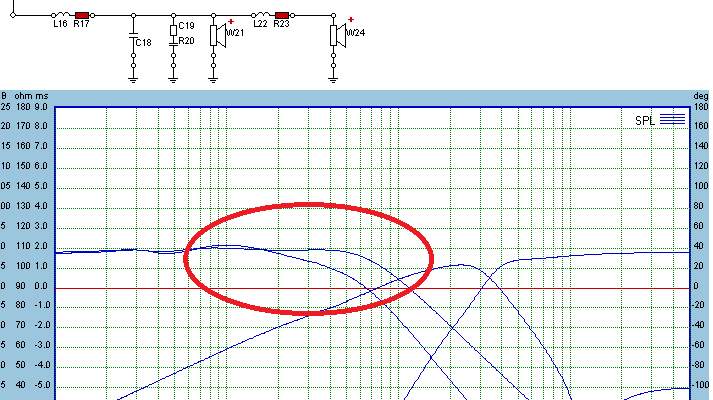

If you don't believe that a single inductor can make a low pass then look at this design:
http://www.zaphaudio.com/ZDT3.5-crossover.gif
http://www.zaphaudio.com/ZDT3.5-transferfunction.gif
The 0.5 woofer is clearly rolling off at a rate which is 6dB/octave steeper.
Feel free to see a 6dbs increase in the slope, i only see 3dbs, and let me insist on the shelving effect in the area marked in red.
Btw, i you have the funds to roll big heavy expensive ... and also resistive coils, feel free also to do so.
More over this filter is a fully 3.5 adhoc design ( a scary hairy one ...) intended for specific drivers and cabinets, not a supposedly universal 2.5 one.
I know that some insist in trying to buil speakers without any design/measurement effort and investment, and others insist in giving them hints that might allow them to achieve satisfying results without having to learn anything. Ok i know this is part of this hobby, but i personnaly prefer the learning part of it. Building for building sake, without understanding what i build is dead boring for me..😎
