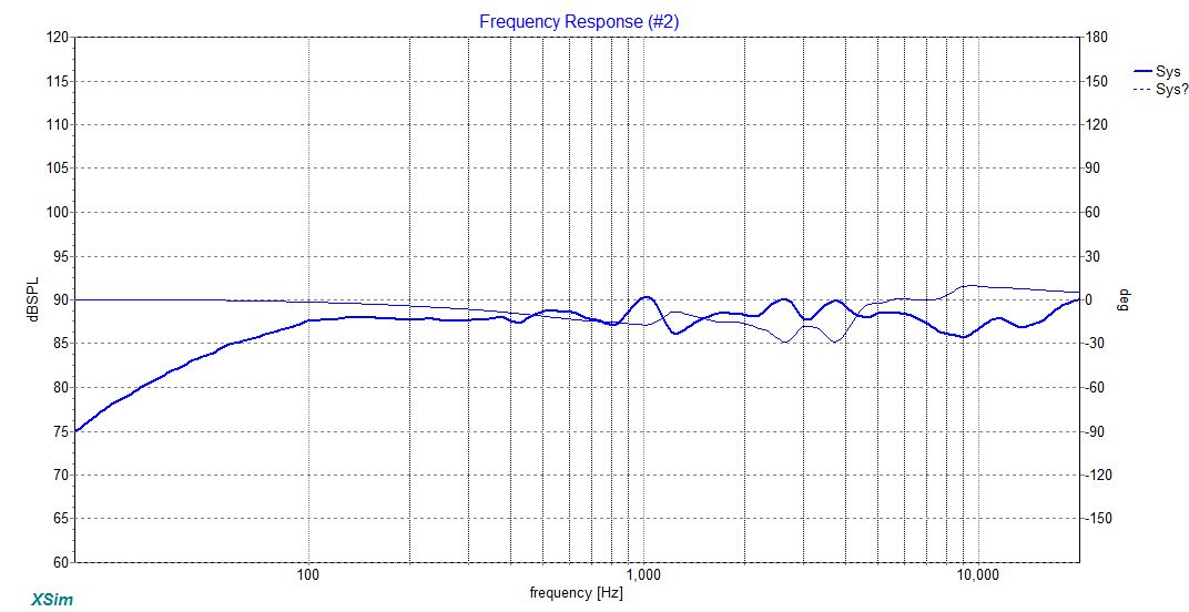

I don't think that series filters are intrinsically different to parallel ones regarding to driver 's impedance influence on slopes and on everything in general, meaning that you cannot exactly know how this ... xover behaves untill you know what ... drivers you are using, because this ... choice matters both electrically and acoustically. That's life, no miracle, you have to make some choices and know what the consequences of your ... choices will be. This is the only universal xover law that i know about...
If you see that 3 parts are shared depending on the route your signal takes, you have a damped second order lowpass, ie- a coil and CR shunt. Then you have a C-LR shunt-C in the tweeter circuit, ie- a damped third order.
Being that this is a SXO, and the parts do conduct AC both directions for a perspective. It's the resistor and it's placement, as well as where the drivers are located in the circuit that make this very different than an average SXO.

You do? It looks pretty damn close to a 6dB/octave roll off to meFeel free to see a 6dbs increase in the slope, i only see 3dbs, and let me insist on the shelving effect in the area marked in red.
Freq - woofer level, BSC woofer level = difference
300Hz - 89db, 86dB = -3dB
600Hz - 88db - 81.5dB = -6.5dB difference
1200Hz - 80db - 69dB = -11dB difference
2400Hz - 67db - 52.5dB = -14.5dB difference
Ideal 1st order butterworth
Fc = -3dB
2Fc = -6dB
3Fc = -12dB
4fc = -18dB
1.2 and 2.4k are probably off a bit due to guessing the position in between the lines on a logarithmic scale. Also the woofer impedance is starting to rise about 1kHz so you get slightly less than 6dB/octave from there up. What is important it that it adheres to a 1st order slope almost exactly for the first 2 octaves.

That will depend on the drivers for sure. I can't wager an Fc without a full sim, and this would require Xsim to simulate it.

Nope, you can't analyse a series x/o like its two parallel paths.
It is 1st order and 2nd order, not 2nd order and 3rd order.
Figure 1.1 - Series and Parallel 1st Order Filters (8R-1KHz)
According to your very misguided thinking 1st order series is
2nd order because the bass has a series inductor and parallel
capacitor, and the tweeter a series capacitor and parallel inductor.
Just plain wrong. The responses above are identical.
As are the voltages and currents for all components.
rgds, sreten.
Hi, Sreten, thou are right, that the series crossover thou posted is equivalent to the parallel one. But, if component values are changed (bigger C, smaller L), the result can become a cross-over of second order, because L and C are interacting now. If L and C sit in separate, parallel branches, they cannot interact.
In this case, it would be too hard to calculate the fc.Hi, Sreten, thou are right, that the series crossover thou posted is equivalent to the parallel one. But, if component values are changed (bigger C, smaller L), the result can become a cross-over of second order, because L and C are interacting now. If L and C sit in separate, parallel branches, they cannot interact.
The L and C are always interacting in a series crossover.Hi, Sreten, thou are right, that the series crossover thou posted is equivalent to the parallel one. But, if component values are changed (bigger C, smaller L), the result can become a cross-over of second order, because L and C are interacting now. If L and C sit in separate, parallel branches, they cannot interact.
Of course to some degree it could be observed that one takes over from the other, ie that without the C, the woofer sees a parallel RL shelving filter and the C then attenuates the shelved region at 6dB/octave.

Nope, the 1st order series x/o can never become second order,
and can never have offset x/o points like the parallel 1st order.

Lots of info regarding 'zeta' and 'quasi-12dB' SXO circuits in reference to SXO 1st-order are using a resonance at the Fc of the xover between the 2 parts to steepen the knee of the transfer function. Being that I've never done a xover based on zeta, I cannot say whether this is accurate or not.
My hunch is that the Q is reduced at the Fc, and even if the initial slope is greater than 1st order, that it will in effect asymptote to 1st order electrical + acoustic slope further down the rolloff.
Now- you refer to having offset xover points on a parallel xover. If you have 2 drivers, you have one xover point- period. You can use differing Fn* marks to spread the response out and reduce the peaking/dipping at Fc, but there is still only one Fc. This is the same for all 2-way approaches. 2 drivers = one Fc; where the rolloffs of the drivers pass each other. (*n= -xdB)

H]But, if component values are changed (bigger C, smaller L), the result can become a cross-over of second order
Yes, you can manipulate a series XO so that initial roll-off is close to 2nd order, but if you go far enuff it is still 1st order.
