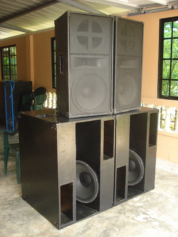

This is where I've reached so far..
Sounds awesome (very rich bass) without much eq ,tried it out with a car amp.
So it should be even better with my xover, eq, and power.
Someone said it should be called the cross-eyed monster :D:D.
Back in the mid 1980's I had a lot of L4 and L2 cabinets ( 24 4 x15", 4 2x15") that were similar to what you came up with here, though my cabinets came to a "V" all the way to the back of the cabinet, both sides had separate chambers. Separate chambers lowers distortion a little.
The design originated when we cut the last 15 inches off 4 x15" straight horns, then added ports. The cabinets went from 45 to 30 inches in depth, the 45" depth had been a problem in many venues we were working in.
The hybrid retained the "punch" of the horn, with the LF extension the bass reflex added. More bass using 1/3 less space, yay!
Later, we tried the same cabinet with two 15" instead of four, using cover plates over the two unused holes. The LF output remained almost exactly the same, just less upper bass response.
Still had a bit of a rising upper response compared to a standard BR, but the extra headroom the "horn" provides up higher is helpful in large rooms.
Installing the two speakers "cross eyed" gave more output and sounded better than mounting the speakers both on the top or bottom.

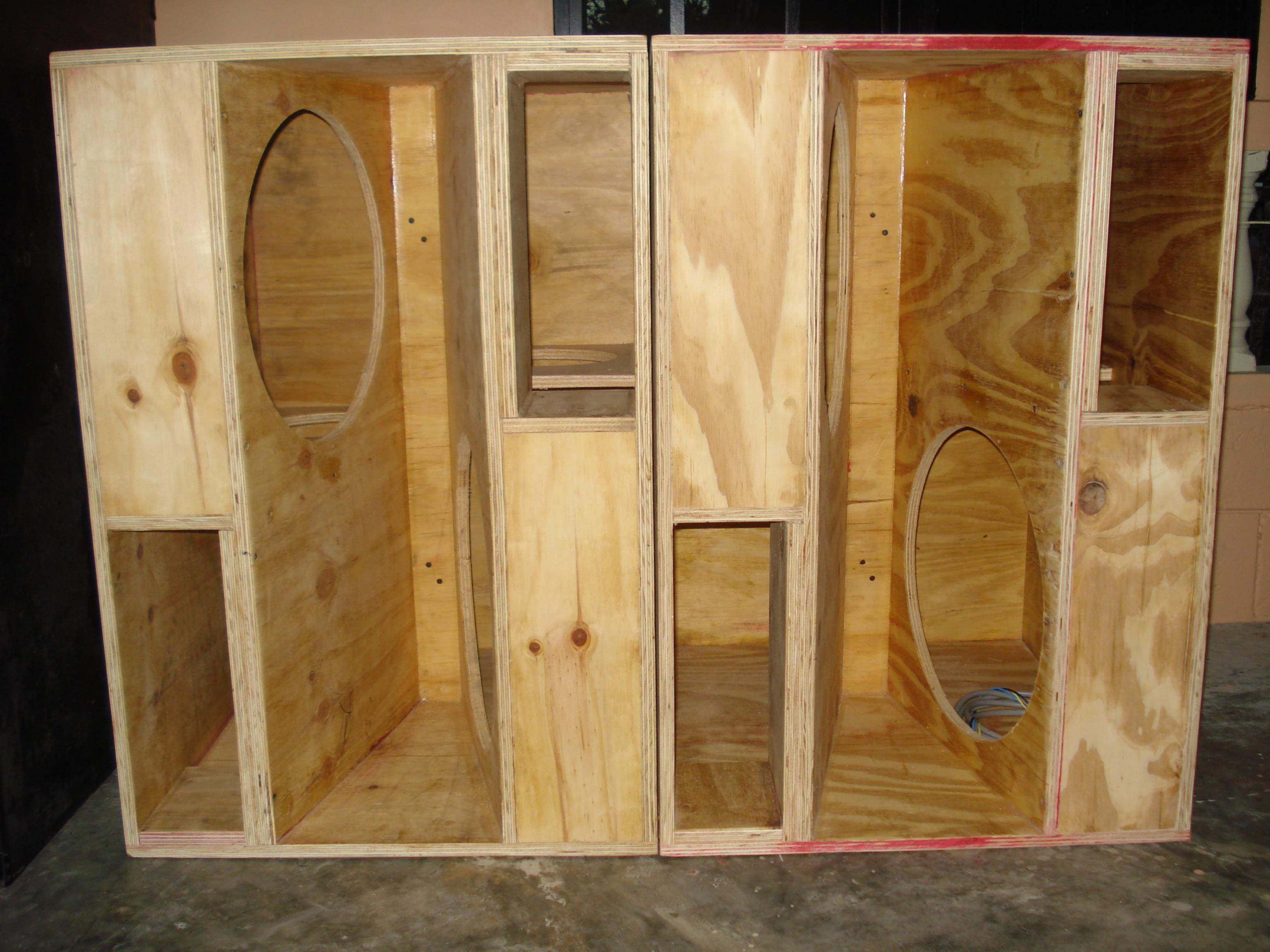

Well,at the beginning of this thread ,my idea was to have the chambers separated {as in the first pencil sketch}.Then with a lot of help of NeoDan who modeled and finalized all the plans for me ,came up with the manifold style i.e having a single chamber.
I am very curious about the difference although I'm very happy so far with the performance

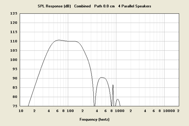

]I'm wondering how this enclosure would compare with subs like the eaw 850, sb 1000 and the g-sub in terms of loudness and clarity. FR.png

With separate chambers the ports would have been deeper than the box.
The volume per speaker and volume of cabinet to port ratio remains the same whether one large box with two speakers or two smaller boxes with a single speaker in each.
Separate chambers would not require any change in the ports, Fb would remain the same either case.
The only difference would be in sound quality, not frequency response or output level.

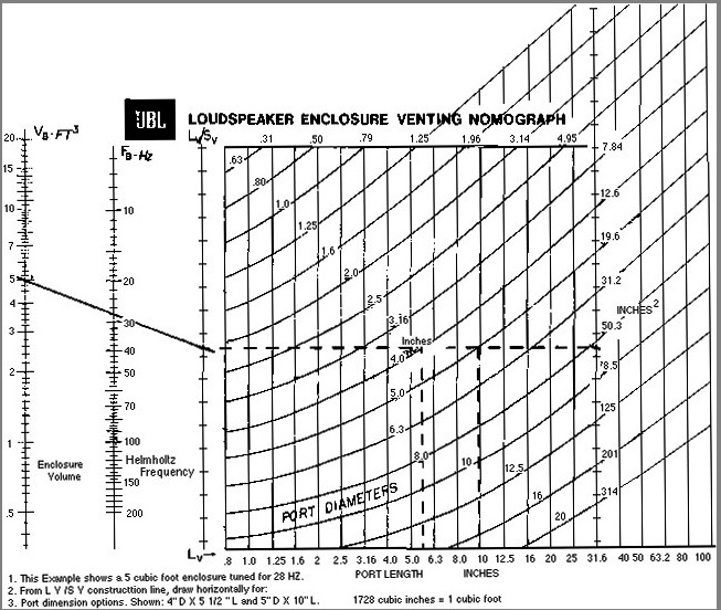

"The volume per speaker and volume of cabinet to port ratio remains the same whether one large box with two speakers or two smaller boxes with a single speaker in each."
Don't think so, it's not a linear function. Do you remember porting charts pre-computer era?
Those are the charts I still use, I love nomographs.
It does not matter if you build one big box with two speakers and two ports or two boxes half the size with one port and one speaker each, other than intermodulation distortion is reduced using separate chambers per speaker.
Do the math, you will see.
Art

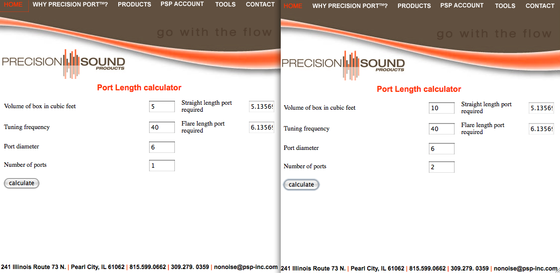

As well as my thought experiment being flawed, this port calculator:
Products Menu
and the JBL nomograph I previously posted, all the Electro-Voice TL cabinet designs plans in the 1980s, what I learned from Dave Gunness (EV, EAW, Fulcrum Acoustics) and Mark Gander (JBL) must be flawed too.
Oh well, can’t help bad luck.
Art
