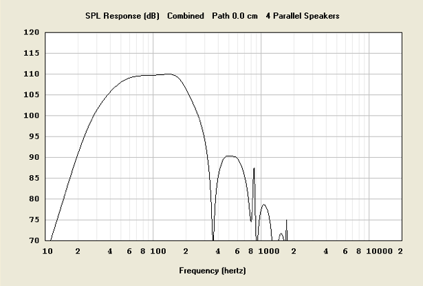

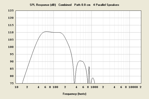

If you build his original pencil sketch with my port dimension and 40hz filter it will be -3dB at 42hz (low E on a bass guitar), about 106dB/2.83V/1M in the 80hz region, and a small peak in the 150hz region (probably 3dB or so). 1200W will be under x-max on program material.

It's not quite like you think, with mutual coupling the tuning is lower and driver excursion is at the limit. Running EQ @ 40 Hz would get him into trouble. The origional is at 40Hz and should be just fine.

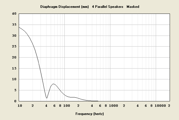

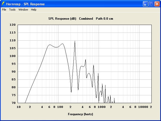

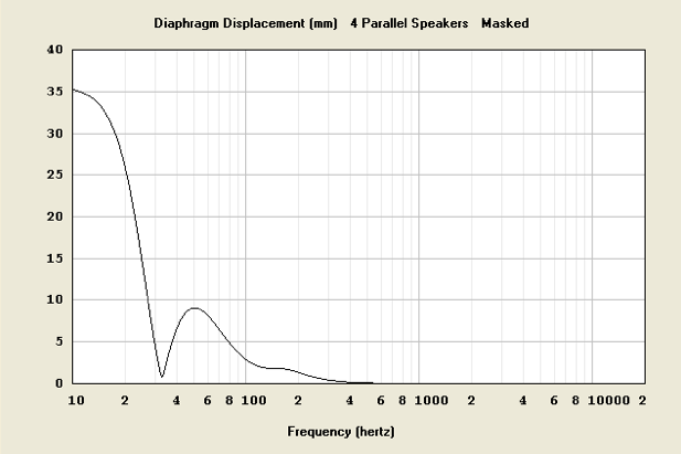

this's the graph i simulated with HR . i see it and think that it will ok . -3
db about 50 hz for outdoor. if it goes deep to 30 hz i don't sure i'll hear the low freq when out door.
Until you learn to draw I think you will have difficulty with simulation due to lack of accurate information, I recommend you watch the Google SketchUp training videos to learn SketchUp. Also see http://forums.sketchucation.com/ forums.
I trust BassBox Pro v6.0 for sealed, reflex, and BP4 enclosures. I'm not sure about BP6, it's very different than v5.0
I'm estimating 150hz cavity resonance bassed on known speakers.
"Running EQ @ 40 Hz would get him into trouble. "
how much boost do you think a Q=1 is anyway? Boost at Fb does not eat up x-max at Fb.
