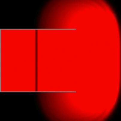

last week i posted manifold but likes planar front. the pic is this.

http://image.free.in.th/z/iz/frontoffsetdrivermanifold.gif

dan i started to use it a few weeks but never save it. don't kwow about the skp extension name. sometime i will change planar to hyperbolic.🙂
Your design is fine for live sound, though I wouldn't DJ with them. You will need a HPF at 40-45Hz for the cluster of 4. 110dB @2.83v into 4ohms is not tooo shabby for a pencil drawing 😉 Good job!

i use hornresp simulate it last week and save the gif file. djk 8 cu feet like you posted. use p audio the graph is ok. tune about 47 hz.
http://img571.imageshack.us/i/frontoffsetdrivermanifo.gif/

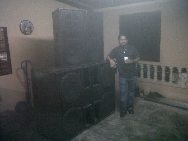

My present system ..
What is the spec for these boxes, same drivers?
The I wouldn't DJ comment was based on MY opinon that you need to get below 40, preferrably 30-35 for a good DJ bin. Although your proposed design will get stupid loud and have VERY punchy tight bass(good impulse response in HR) on a single 4KW amp @ 4 ohms.
These are boxes I built on trial and they worked out fine .I lost the spec sheet somewhere but I'll measure them and post it tomm.Same drivers .
Punchy is what I'm looking for .Carnival is coming up so I'll prob add the 4 to these 2 bass reflex since they go lower with 4 more tops .Think I'll be good to go .
