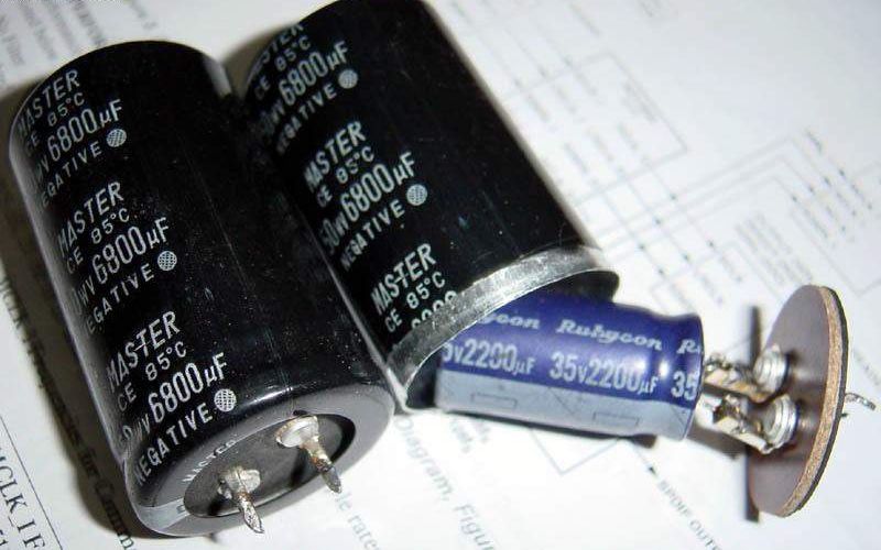

I purchased one of these kits and I could have sworn that the specs read that it could be driven by AC or DC.
I was hoping to drive it using two 12v lead acid batteries.
However, when hooked up, I get choked squeals and noise for a few seconds, then silence.
The same thing happened when I hooked up 12v 3A AC-DC converters.
I don't have any regulated AC supplies on hand, but what am I missing here?

I could barely get mine to work running it at the minimum voltage with the supplied parts. This is one of my favorite pictures I found on the net, I used to have it as my desktop background.
At +-12V you probably melted what were mostly broken chips to begin with. As you probably read in this thread, a couple of us have replaced the chips with ones from a different supplier and the good news is the amp sounds pretty good with real TDA2030 or one of the substitutes available like the TDA2040 or LM1875.
No one has taken me up on my offer to give away my extra chips. If you would like a pair of TDA2030 that are probably good, I didn't test them all, shoot me a private email with your address. Of course if you want to buy them new from a known good supplier, that is another option. The PC boards can only take so many heat cycles before they go south.

So, assuming I have good 2030s, can I use two 12v DC sources to drive this amp?
Should be no problems.

Mine works fine after replacing the ICs. I got my new chips from Jameco.com but probably any good supplier like Digikey or Farnell should be just as good. It's ~$10 for new chips which means the amp still costs about 1/2 of what a good kit would cost so I would still go that route.
About the only thing I would maybe do different is get a kit with a heat sink included. Hard to screw up a heat sink and to get one separately adds another $6-$10. to the cost.
