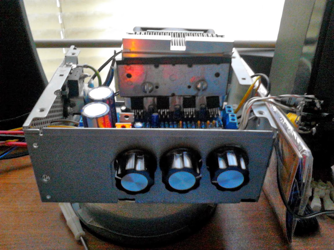

Hi guys, recently I bought and assamble this same kit from ebay (it's a clone but overall it looks the same), the thing is that I'm having a hard time finding a speaker for the subwoofer and I have another couple questions that maybe someone here could help me with as I'm not that good with electronics.
1. As I said before, what specs should I be looking for the subwoofer speaker? Currently I'm using a 7 inch, 6 ohm, around 50 watt woofer (not sub) but I can't crank the bass too much because it starts to sound awful
2. I'm using a 24v 3A transformer (center tapped so it gives 12V-0-12V). Is this enough? I hope so cause I had a really hard time finding anything bigger than 1.2A
3.When I crank up too much the subwoofer volume the leds on the board starts to dimm with the kicks of the speaker. I think it's speaker related but could it be that it ain't getting enough amps?
I'm attaching some pics of my assembled board:
The board before Assembly
Here you can see it has 2 leds, both turn on an keep that way
Assembled, fitting for some connections and ON/OFF switch still pending
The heatsink was from a 1.8ghz pentium 4 computer the base is made of copper (with some kind of silver coating) The fan runs on a separate DC 6V adapter

You are at the bare minimum with respect to your transformer. That is, the kit is sold at 18+18+36 Watts and your transformer is 24VAC @ 3 amps or 72 Watts. What's heat is Watts j/k! Chip amps are not 100% efficient, a lot of what they use is just wasted.
John8's post about his amp taking 2 amps at 12V on each rail at IDLE is a good example. That would mean he is using up 24 Watts of transformer<actually for test he used bench supply> just sitting there with the volume off. If yours is doing something similar, you only have ~48 Watts of supply left to run your 72 Watts of amplifier. Just tossing out a ballpark guess, amps other then class D are only about 70% efficient. That means by the time your getting sound out of your speakers, you only have ~30 Watts available from your 72 Watt amp.

I see john8's complaints where about the ICs being counterfeit, when I first tested my kit, I was trying some speakers I had laying around and one was busted. I ended up hooking that speaker to the subwoofer output and blew an IC, a friend of mine gave me a couple TDA's he had laying around. It can't be appreciated on the photo but I replaced both sub woofer IC's for two Telefunken TDA2030.
Also at first I tried hooking up only the subwoofer without the other speakers and it behaved just the same around the same volume level (before and after the replacements)
Also the speakers work great with or without the subwoofer.

Just as you said, my sub volume is usually around 7 to 8 o clock, my tone is at noon and the main volume at 10-11 o clock
I have 2 4ohm (20 watt) speakers and the 6ohm woofer as sub. The heatsink without the fan working gets warm gradually and I didn't want to risk blowing something, with the fan it gets barely warm (we've been having kind of a fresh weather in my country, so I'll figure out on summer if it really works)
I tried a diferrent 6ohm woofer from a Sony speaker (Maximum input power
80 Watt) and it seems to work a bit better and when the subwoofer volume is louder (past 9 o clock) even as the speaker distorts the leds don dimm as much as before. I have a 2ohm ceramic resistor, would it be better if I make the sub 8 ohm?
I salvaged a lot of stuff so I think I just invested US around $29.75... the transformer was the mos expensive item ($14.25)
Lights dimming is the power supply running out of juice. One could add more capacitors for storage of bigger power supply. For me what I bought this amp for I can live with the inadequate power supply because I can always turn on a bigger amp if I want one.
It still sounds better then the $40 2.1 system that came with my computer so I'm happy

Thanks for the reply Ricortes, it's been very useful the feedback from you guys.
Maybe later I'll try to replace the transformer (or the capacitors). For now I'll have to settle with my current setup (I'm a married man with a limited income trying to survive the holidays)
My final Setup is the following:
- 2.1 Tda 2030A amp kit (replace default subwoofer ST ICs with telefunken 2030 ICs)
- 24V 3A Transformer with center tap (12-0-12)
- For the Mid/treble: RCA speakers (with tweeter) from a home thather (20 watt 4 Ohm each)
- For the subwoofer: Sony SS-M33 Speaker without the tweeters (just the 80 watt 6 ohm woofer, but with a 2 Ohm ceramic resistor to make it 8 Ohm)
At first I was using the Sony speaker with a generic speaker cabinet... the bass was sounding just awful... I found the original cabinet at my parent's and the bass improved A LOT (really A LOOOOOOT)
I like a lot the results so far, when I was in my early teens I was always trying to mix and repair parts from old audio systems and this proyect really brought back those memories 😀
I only paid for the kit, knobs and trasnformer, everything else was scrapped so I was very cheap
The sound is amazing. I Like my music to be loud and I had very crappy 2.1 USB speakers before this kit so it was a huge improvement.
