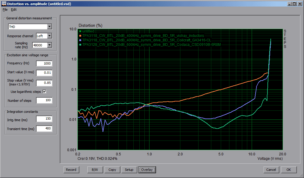

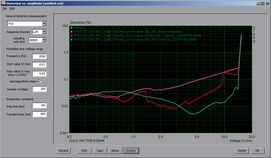

Soft saturation cores tend to add hormonics rights from the begining, even at low currents. From my personal measurements, it is mainly k2 - which may "richen" the sound, as it is the same harmonics triodes add to the sound.
The best inductors regarding THD i had used in small size so far are "Codaca CSD0910B":
CSD0910B
These are ferrite-based.
Unfortunately sourcing these parts is difficult, as Codaca don't have distribution channels outside China, you'll have to oder from Codaca directly with a minimum of 50+pcs. They also sample smaller batches but shipping is expensive.

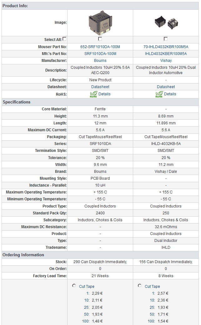

I use Vishay, but Bourns offers exactly the same:
https://www.bourns.com/docs/product-datasheets/srf1010da.pdf?sfvrsn=d6027df6_2
https://www.vishay.com/docs/34381/ld40kb5a.pdf
attachment.php
The core material for the SRF1010 listed on the screenshot above is wrong, they're both same iron powder cores.
Carbonyl: add K2 harmonics, colours the sound like triodes
Ferrite: being higly linear until saturation current is reached. Keep temperature derating in mind, as saturation point shows to lower current when hot.

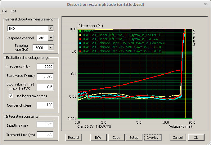

Please see the attached documents from my measurements done in 2017.
