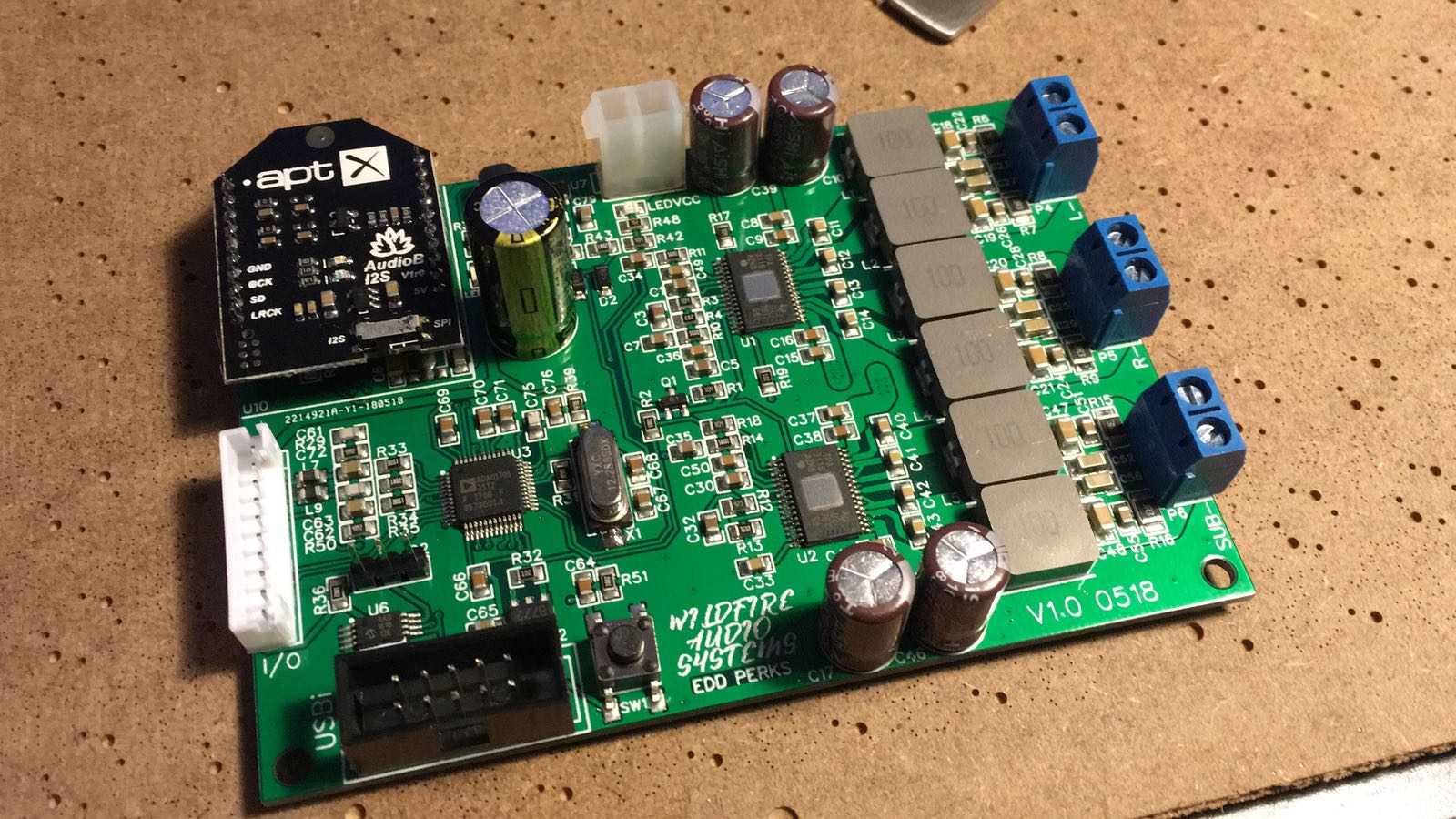

Hello everyone,
So I thought I'd share a project i've been working on because I feel that you guys may have opinions and comments which might make me realise i've wasted many months of my life! I've been a great fan of making my own portable speaker systems over the years but I have always found the market offerings for the amplifiers, bluetooth modules and DSPs either too low a quality or not integrated/controllable enough.
For one example the Sure JAB Boards seem great on paper, but after implementing them i've been left with odd bluetooth clicks and pops, bad gain structuring and difficulty controlling them in more than just a basic way. Also the provided indicator LEDs are crap for various reasons. There are many other systems I have tried and can report similar findings.
I wanted a board that can accept bluetooth (4.2/APT-x) and line in, signal process it in any way necessary and split it out to 2.1 (or 4) amplifier channels. All the while the board needs to manage its battery pack, charging and user interface (i.e Pots, LEDs).
I toyed with the idea of using TI's amplifier chips with integrated DSP, but I love the ADAU1701 & SigmaStudio and I am not aware of a DSP/Amp combo IC that has a 2.1 channel mode. For this reason my current design uses analogue input TPA3116D2s, one operating in PBTL mode. Another revision exists which outputs to 4 channels. The bluetooth is received with a CSR BTM625 module, sending audio to the DSP via an I2S bus. The bluetooth module is also designed to be fully user configureable.
Control and indicator LEDs are handled by spare GPO pins on the ADAU1701. It's stretching what this chip can do but I decided that including a microcontroller which could instruct the DSP could cause too many programming issues for the end user. Keeping all the programming in Sigmastudio's visual interface was a design goal.
The system is designed for a 4S LiPo battery, and can plug straight into any RC style battery via its balance connector. Off the shelf battery management boards (BMS) always seem to under and/or over charge the cells so I wanted to manage that on my board as well to keep things simple and safe. I have two board versions, one with an external BMS and charge controller and one with it integrated. The charge controller is robust and takes 19-28VDC.
I really like the idea of somebody picking up one of these boards, an appropriate battery, a few speakers and that it essentially all the electronic hardware that is required to build a great boom box with everything down to the turn on beep customisable. I suppose I am posting this here now as I have been working on this a long time and I wanted to see if you guys think i'm barking up the wrong tree. Is this something you would use?

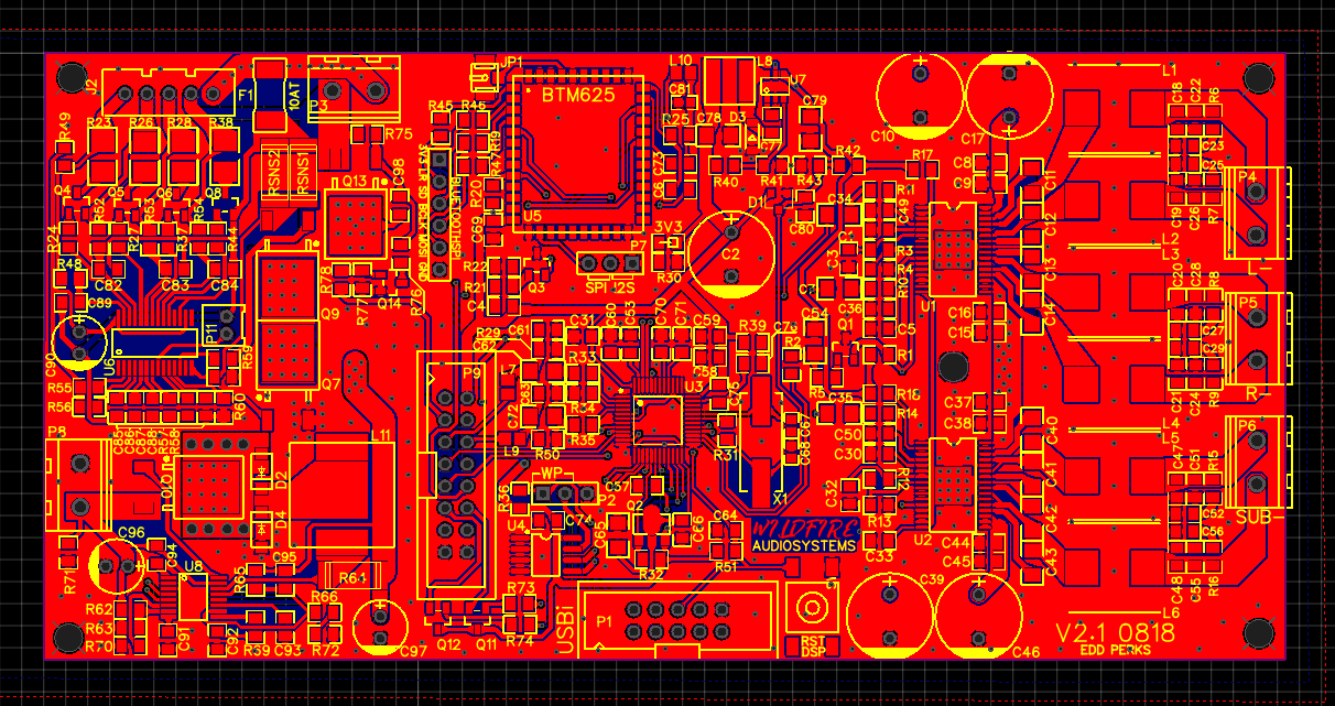

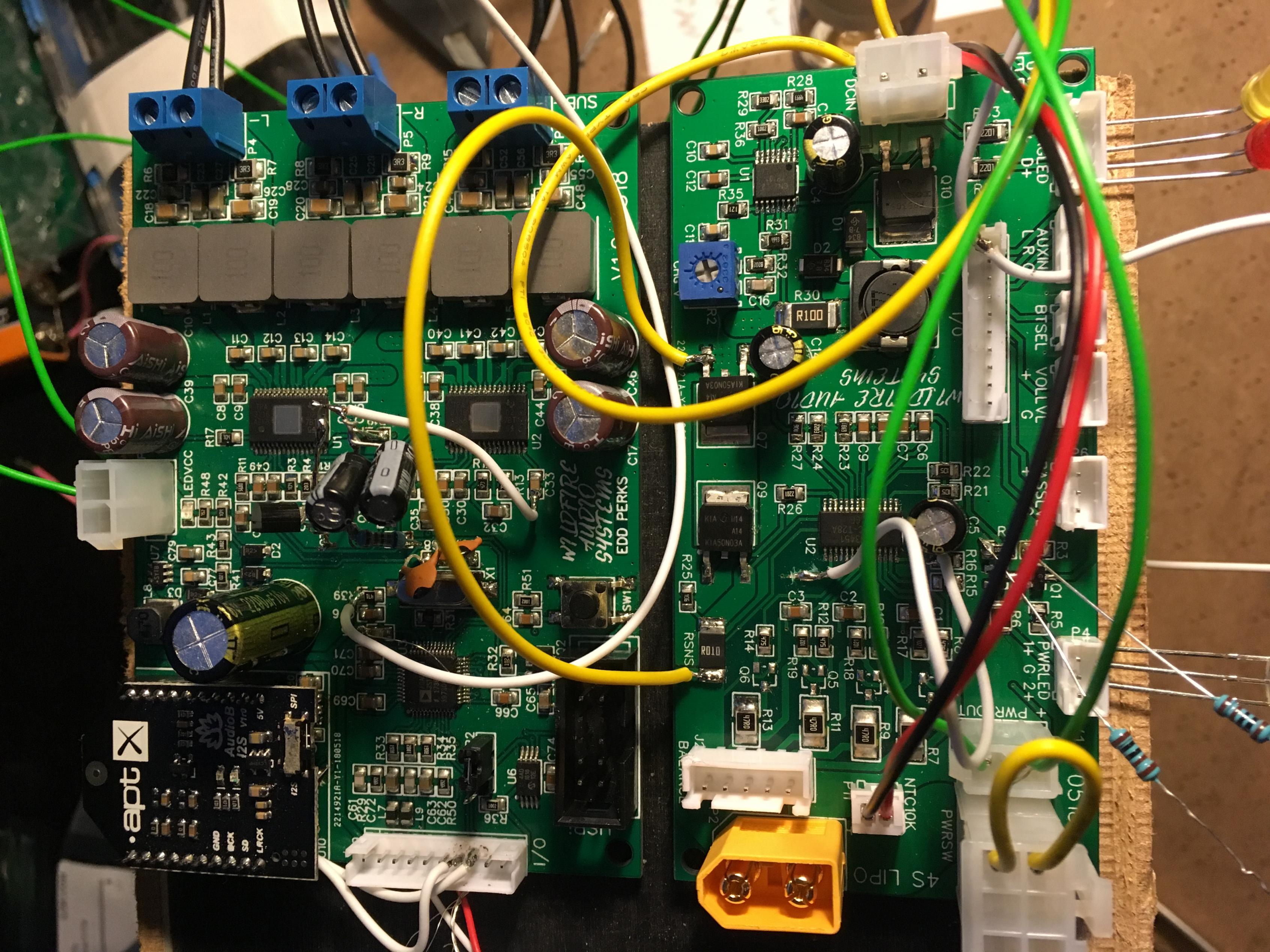

Photos include a couple of the prototypes of the 'split' battery management and amp/DSP boards (which after a lot of bodge wires are working really well) and a screenshot of the integrated layout. The prototype boards in the images are using a TinySine APT-X bluetooth receiver, but this has now been changed to using a CSR module on the board.
Cheers! 😱
Edd

Congrats - that looks impressive work to me. From a look at your pics I had 2 suggestions: Chose twin ferrite inductors - the carbonyl types are not very linear. And do place the speaker terminals in a row, not separate, to increase stability while tighting the screws.
Thanks for the suggestions, I think I agree on the inductors. These ones were chosen as I can source them for pennies rather than pounds (for an equivalent part made by CoilCraft). This choice was made mainly in an exercise of keeping the cost of the finished boards low.
Being an electronic service engineer by trade I know of the problems that can arise from twisting solder joints on terminals, but this is something I've only witnessed on single sided PCBs. These double sided boards should be fine and spacing the terminals as they are keeps the tracks chunky and even.
There should be alternatives to coilcraft. But to be honest, personally I do not expect anybody can discern the THD increasing over frequency related to carbonyl cores. Do you intend to post the circuit diagrams? And are there measurements available?

Don't know how open-source you want to go, but if you post a screenshot of your schematic we can maybe help you with some improvements.
Do you have more details on the battery board? Looks interesting. Why does it have so much headers?

So, the headers are:
P1, USBi programming for the DSP. (Baldin) For programming you can use either the FreeUSBi which is an adapter for the cheap CY7C68013A MINI BOARD, or the complete programmer that Sure Electronics sell.
P3, Main I/O for connecting the aux, LEDs, volume pot etc.
SPI Bluetooth, bluetooth programming with a CSR-USB SPI
J2 is the balance lead connector of the LiPo pack, then P3 is the connector for the high current battery wires.
I don't think the layout is optimal yet. Work in progress.
Battery management ICs are expensive, so i've chosen Chinese chips which so far are working well. BM3451 (BMS) and CN3722 (Charge controller). I am now working on a 'soft' power switch via a mosfet as the boards capacitance is causing arching on switches.

BMS Update
Just posting to let you all know i'm still working on this as and when I can and a few changes have been made recently. I have decided to split out the battery management and DSP/amp functions to separate boards, just to make the system more flexible.
Part of this increase of flexibility is going to include making the second TPA amp chip configurable as either mono (PBTL) or stereo, so the amp board can be used as 4 channel or 2.1, routing the audio appropriately from the DSP. The challenge here is keeping the board small with 4 lots of LC reconstruction filters.
The battery management board is designed to be completely user configurable, 3/4/5 cells of LiPo with user programmable charge current and discharge limit (Max 15A). Here is the board so far, prototypes will be in the post soon:
