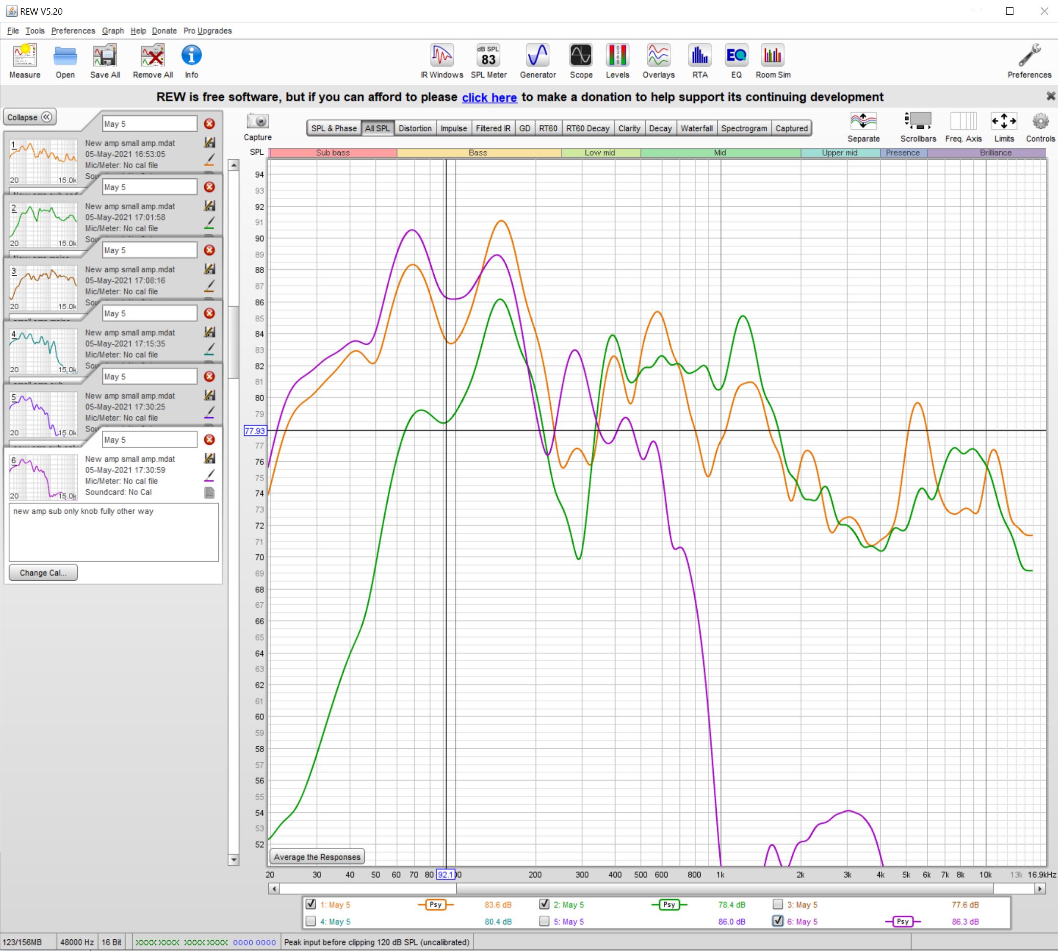

Hiya I bought the 5 knob amp with switch, bluetooth and 3.5mm / 3 pin header inputs. I am using Morel MW164 and MDT39 plus one Tang Band W6 1139SIF.
Good things:-
Bluetooth works well.
No pop on switch on or off.
Bad things:-
The hi pass switch for the main speakers indeed does absolutely nothing.
The sub channel doesn't start to drop until 450Hz.
The sub frequency cutoff adjustment does nothing.
Really bad things:-
Big dip between 2 and 5K due to the bad tone control design. You cannot level this off using the treble control.
Instructions exist for visually identical (I mean identical) versions that says it has a proper 2.1 crossover and how to adjust it with nice frequency charts. All lies.
Usual Chinese design with ranks of tiny caps, most of which are probably duplicates or redundant. Impossible to trace and modify in any reasonable timescale.
It has a part number on the board:OPA31162120200201
AVOID! :redhot:
