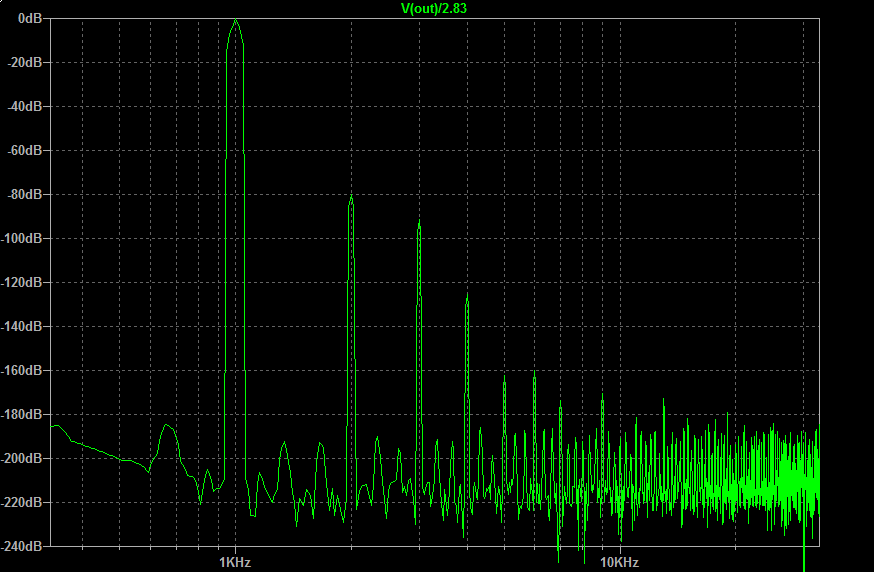

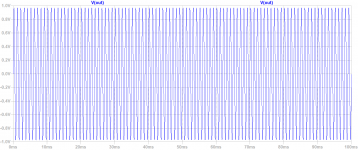

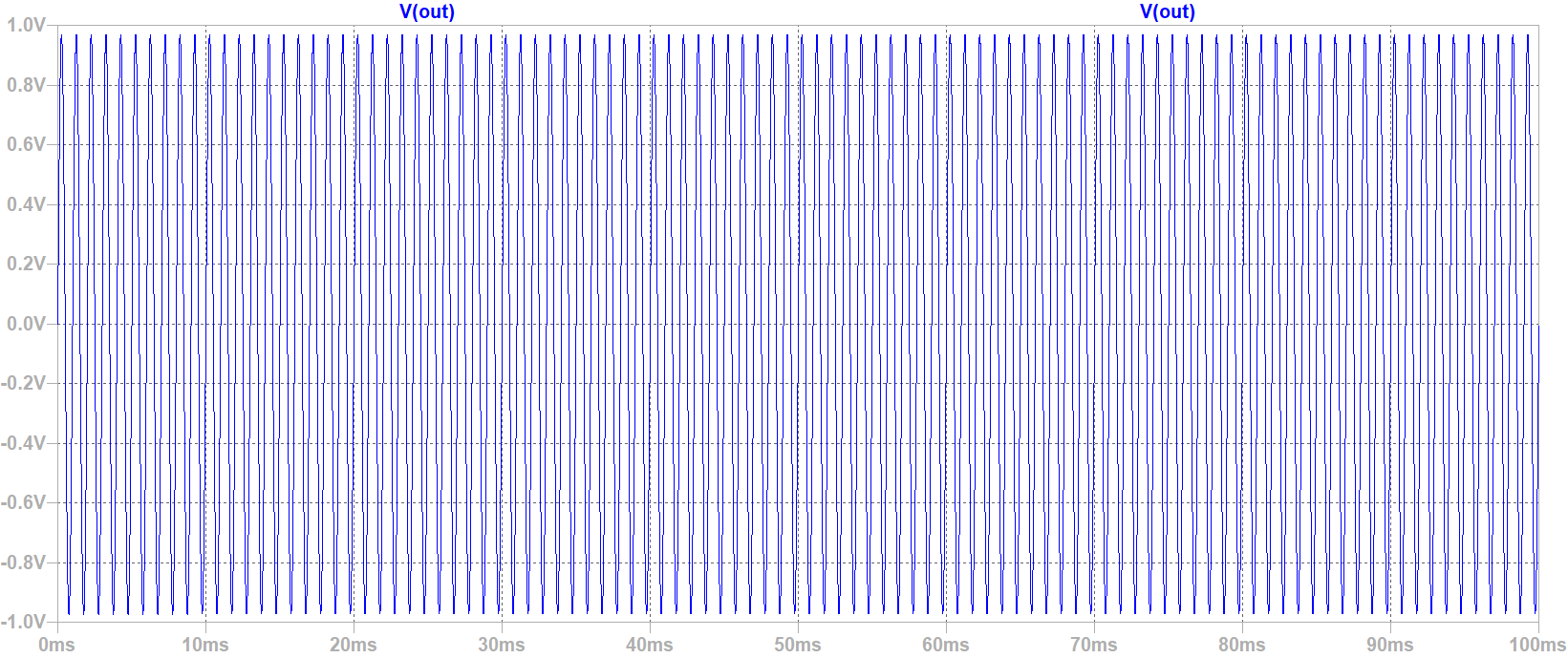

I think Hann window is also good, but you need > 8 cycles for a good plot, 16 is better.
Do you mean 8 cycles of the 1kHz? Or 8x more than what I have above for the time series as I have a pretty long one already (see below). I am not sure I am getting anything useful given my limited -130dB noise floor when using these other windows. I suppose it is good to see where the higher order components are, if I could see them.

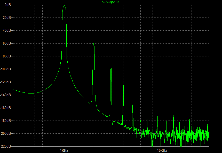

With a 1.1R drain resistor on the top MOSFET for 560mA bias current and using +/-18v rails, and dissipating about 10W per MOSFET, I am getting some pretty neat results driving 8Vpp into 8ohms (1Wrms) with 0.005% THD.

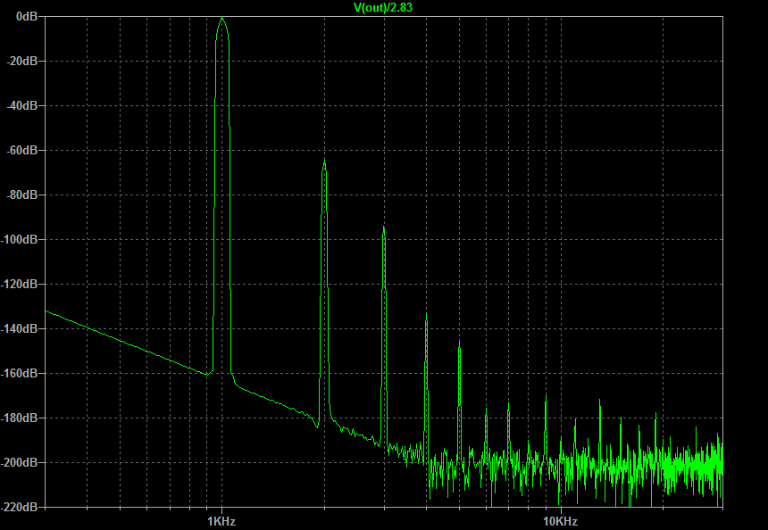

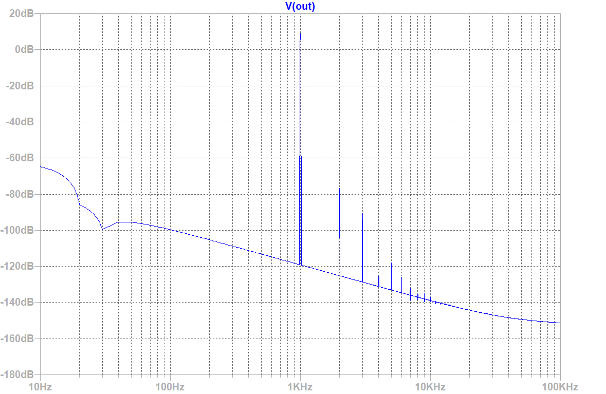

So, for a HPA, this is pretty nice that it can double as a low distortion fleawatt amp for high sensitivity speakers. Profile looks great too. Here is 8Vpp into 8ohms (Hanning window):
attachment.php
Just 8 -16 cycles of the sinewave. Distortion spectrum is also useful as indication of inherent smoothness of the transfer function. The point of windowing is to see below the noise floor with fewer periods on simulation.

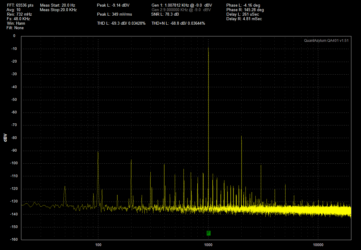

Here the QA401 result (Hann windowing) at 1Vpp. THD is around 0.034%.
Power supply is 12V with 4.7R bias resistor. Those little heat sinks get hot. I'm going to put on some better 'sinks and try it again at 15V

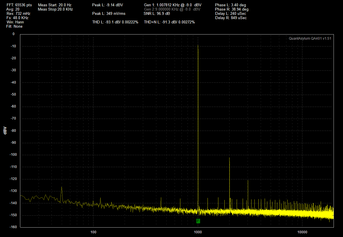

I went ahead and built a TO220 version (albeit with IRF520 and 9520, as they were what I had in my parts bin).
Going to run it through the QA401, and I'll post results when I'm done 🙂

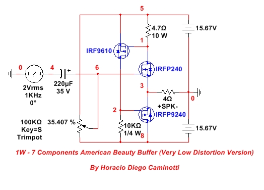

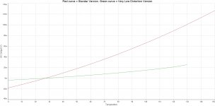

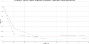

How many advances I have missed in my absence! Let me bring you a version for those whose inefficiency does not represent a problem. The version that I bring here, allows to greatly improve the distortion and the DC shift in the output. Only one parameter is reduced and it is the PSRR. Because it is a low power amplifier, a stabilized and well-filtered power supply voltage would be suggested.

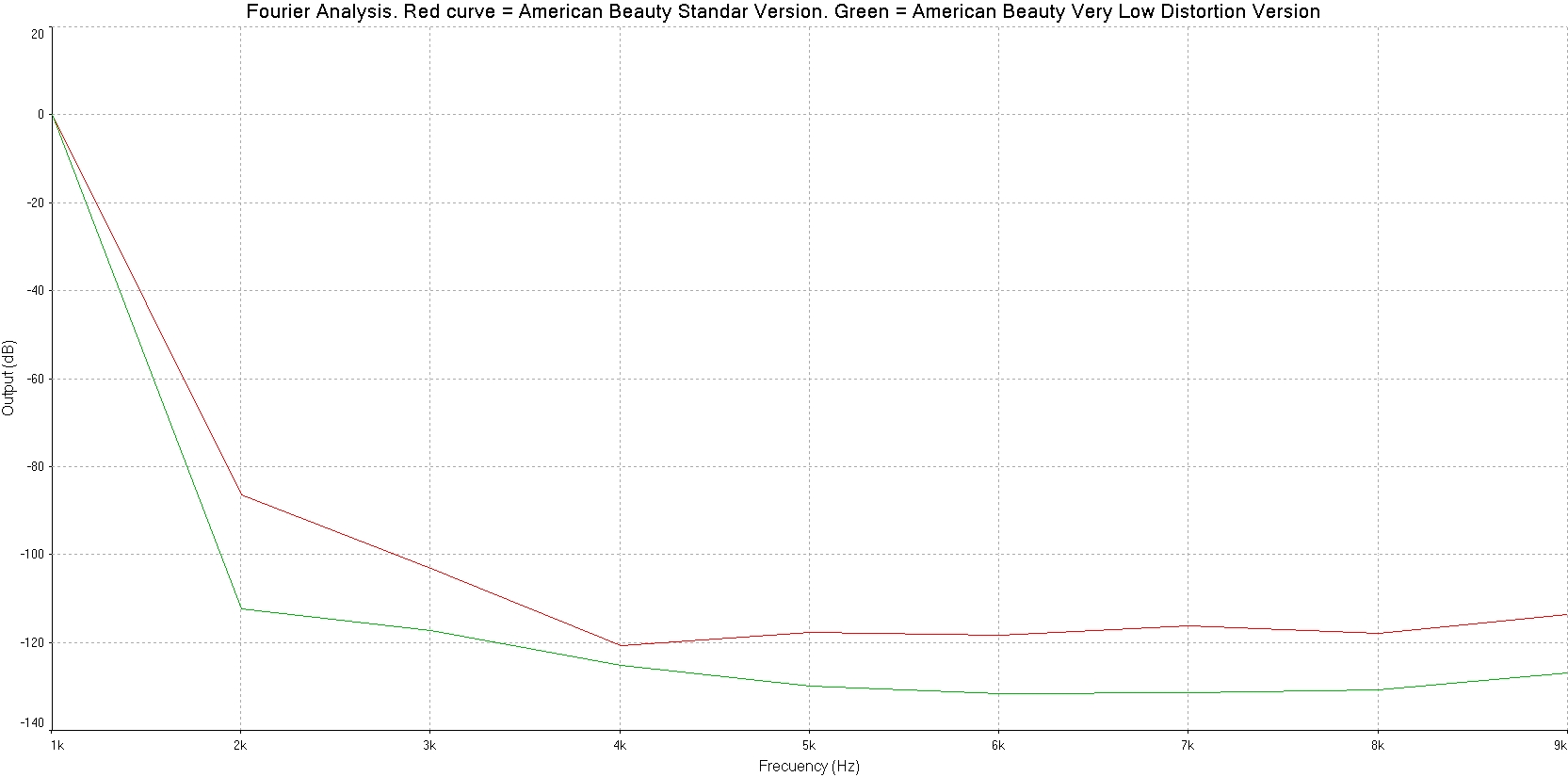

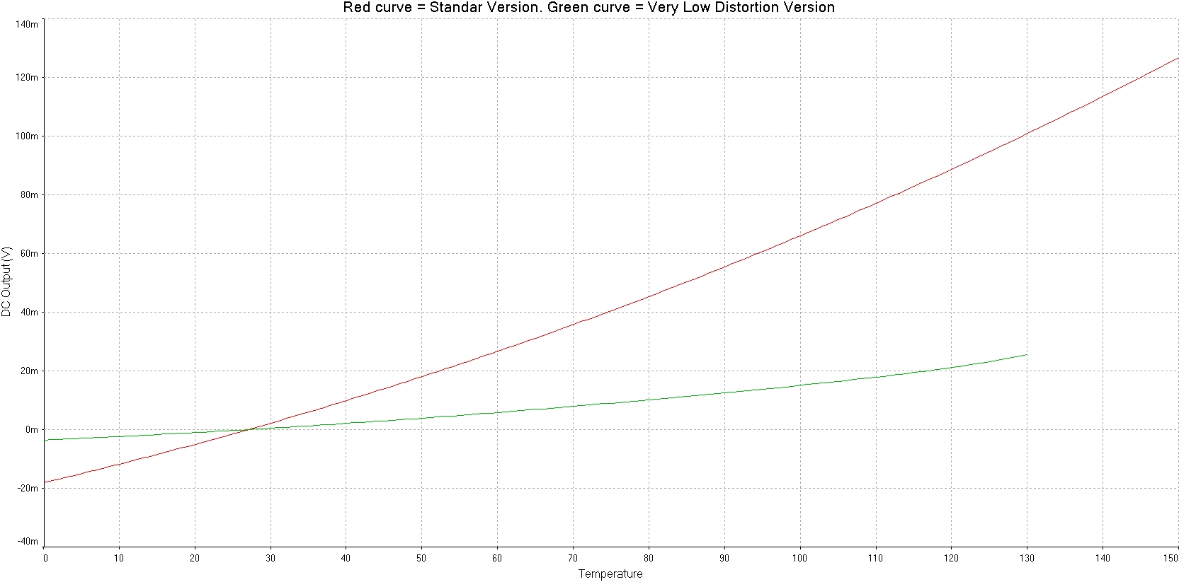

The drastic reduction in the distortion is mainly due to the decrease in the current variation between drain and source of the IRFP240, above and below the static level, with the variation of the input signal 😉. THD is now 0,000292471 % at 1 KHz, 1 W, 4 ohms, 2 V RMS input / output signal.
attachment.php
attachment.php
attachment.php
