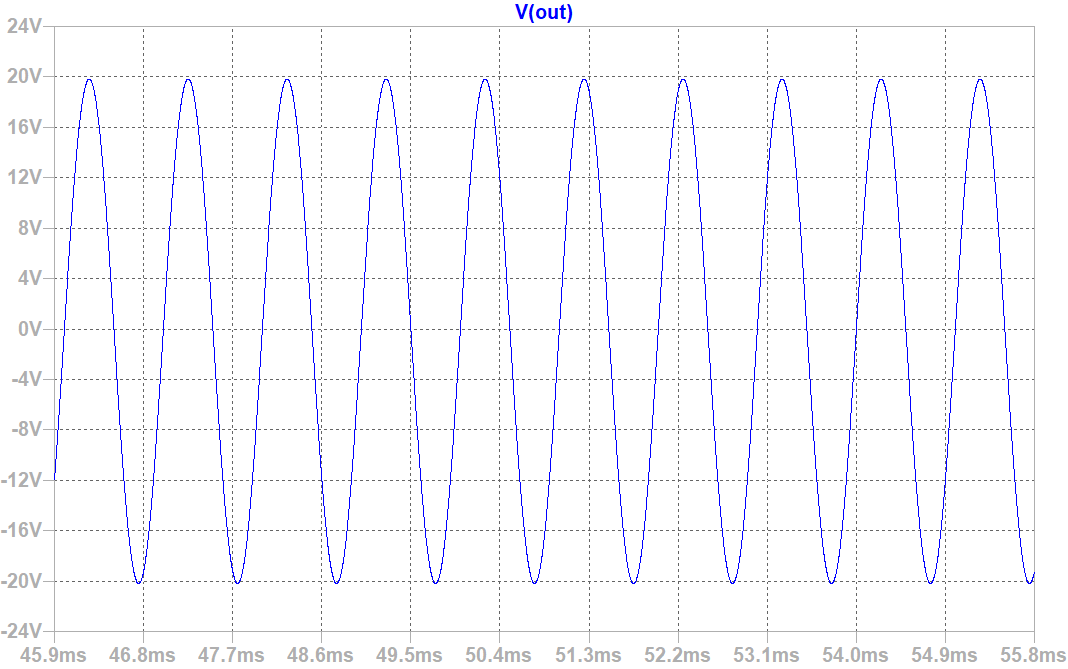

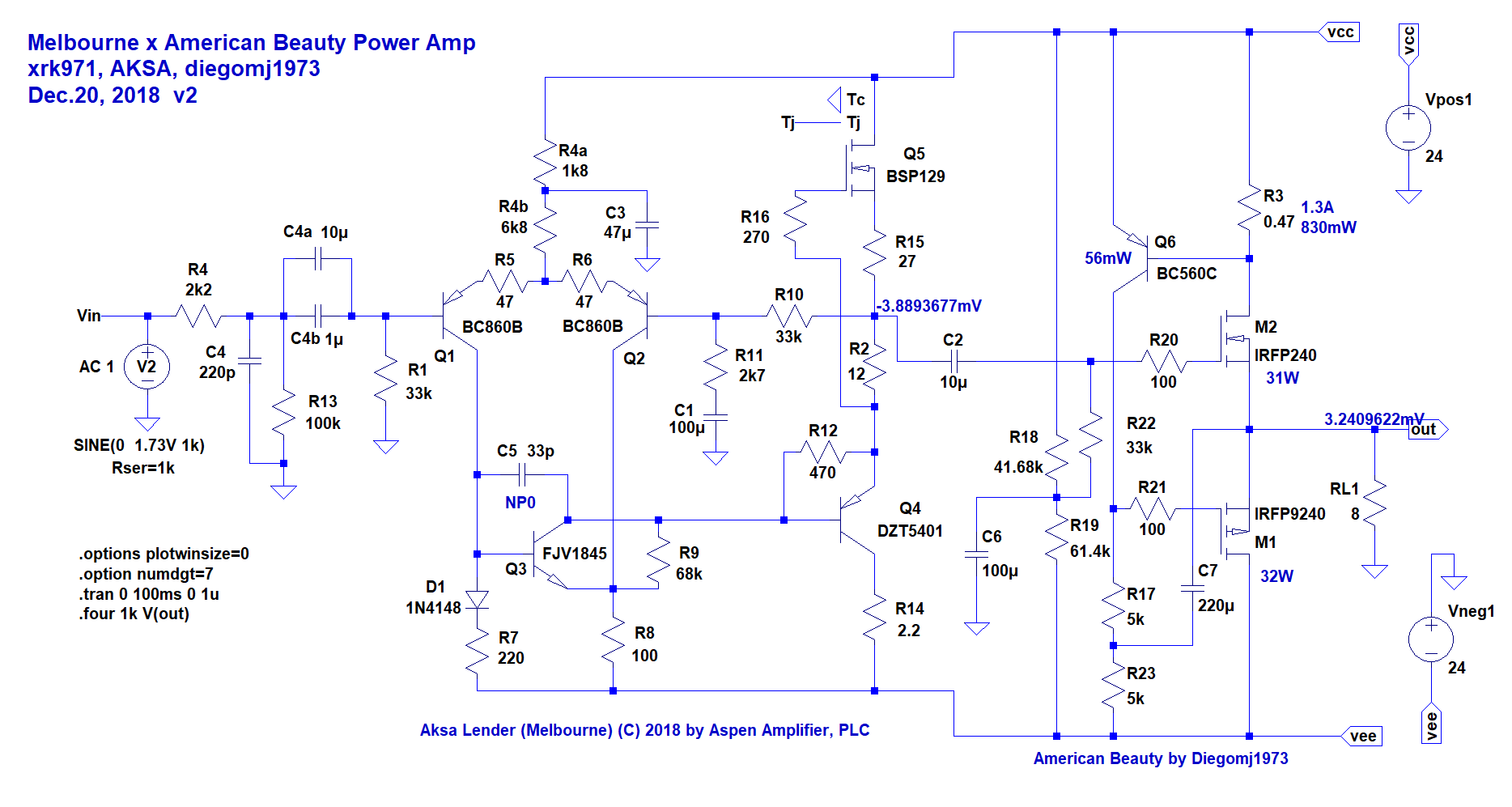

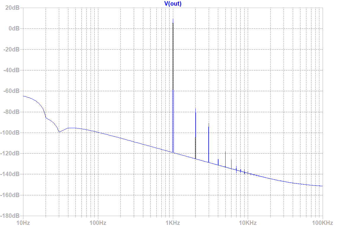

Ok, I put a 220u bootstrap on lower MOSFET to avoid lower clip. At 1.3A bias and 24v rails it is getting to 40Vpp without clipping. THD is about 0.51% at the max operating spot. Still H2 dominant but lots of higher order stuff.
attachment.php
Predicted O-scope trace for 40Vpp into 8ohms:
attachment.php

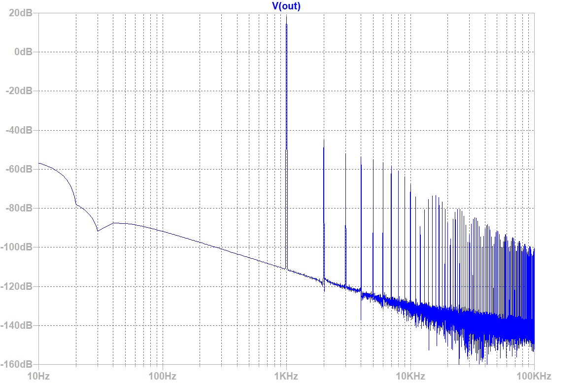

But FFT looks not very good - too much higher order stuff going on here:
attachment.php
And even at 8Vpp (1wrms into 8ohms), it doesn't look as good as when I was running a lower bias current at 18v rails:
attachment.php

Monitor current of M1 and M2. You want a diode in series with R3 like what I did on post #13 and adjust various resistor values to stay in class A operation up to clipping to avoid higher order harmonics. Takes a little time but achievable. Versatile circuit, can be set at various operating points to fit different sonic preferences and other needs.
723366d1545324243-1w-7-components-american-beauty-buffer-melbourne-ambeau-schematic-v2-bootstrap-png
723367d1545324255-1w-7-components-american-beauty-buffer-ambeau-40vpp-scope-v2-bootstrap-png
723368d1545324674-1w-7-components-american-beauty-buffer-ambeau-v2-22-6vpp-bootstrap-fft-jpg
723369d1545324944-1w-7-components-american-beauty-buffer-ambeau-v2-8vpp-bootstrap-fft-jpg
Recall, this was 8Vpp into 8ohms with 560mA bias and 18v rails:
722736d1545063815-1w-7-components-american-beauty-buffer-melbourne-american-beauty-8vpp-8r-fft-hanning-png

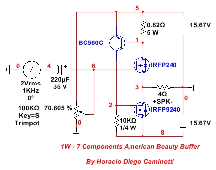

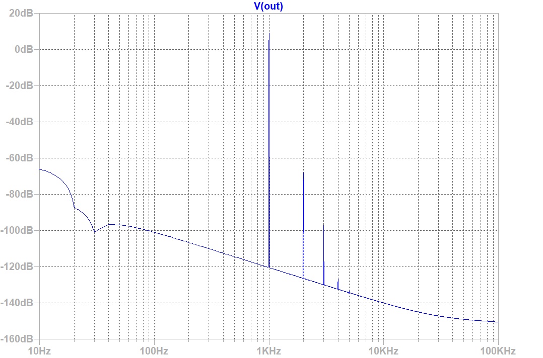

The bootstrap implemented with C7 helps significantly in reducing the THD, but it is also a fact that this bootstrap visibly modifies the spectrum of that distortion. This bootstrap tends to decrease the H2, but it alters the desired ratio of this H2 to the higher Hs.
You could see that by substituting R17 and R23 for a trimpot of 10 K (result of adding R17 and R23 values) and looking for how the spectral distribution of the point-to-point distortion is modified. Something similar to what happens in the DLH.
I noticed that when testing bootstrap on the Melbourne X M2 as well, and decided not to use it. The Mu-follower might be worth a try though - but not sure how to implement that here as the CCS feedback is the base of the BC550.
The bootstrap tends to raise the levels of H4, H5 and H6 and, according to the type of specific adjustment, can raise the levels of H3 and H8, in relation to the case that does not use it (where the H2 predominates over the level of the higher Hs). What the bootstrap can effectively do is reduce the THD markedly, but with a profile that we may not like, necessarily.
I upload a version with a minor change in the connection of one of the terminals of the trimpot (assuming an alteration in its adjustment as well). This change reduces the power dissipation of the trimpot to only a quarter of the previous one. Some changes not visible in simulators, but possibly visible with measuring instruments, are the distortion and thermal noise that now would have to be reduced very marginally (any small effort, although small, is welcome).
Regards

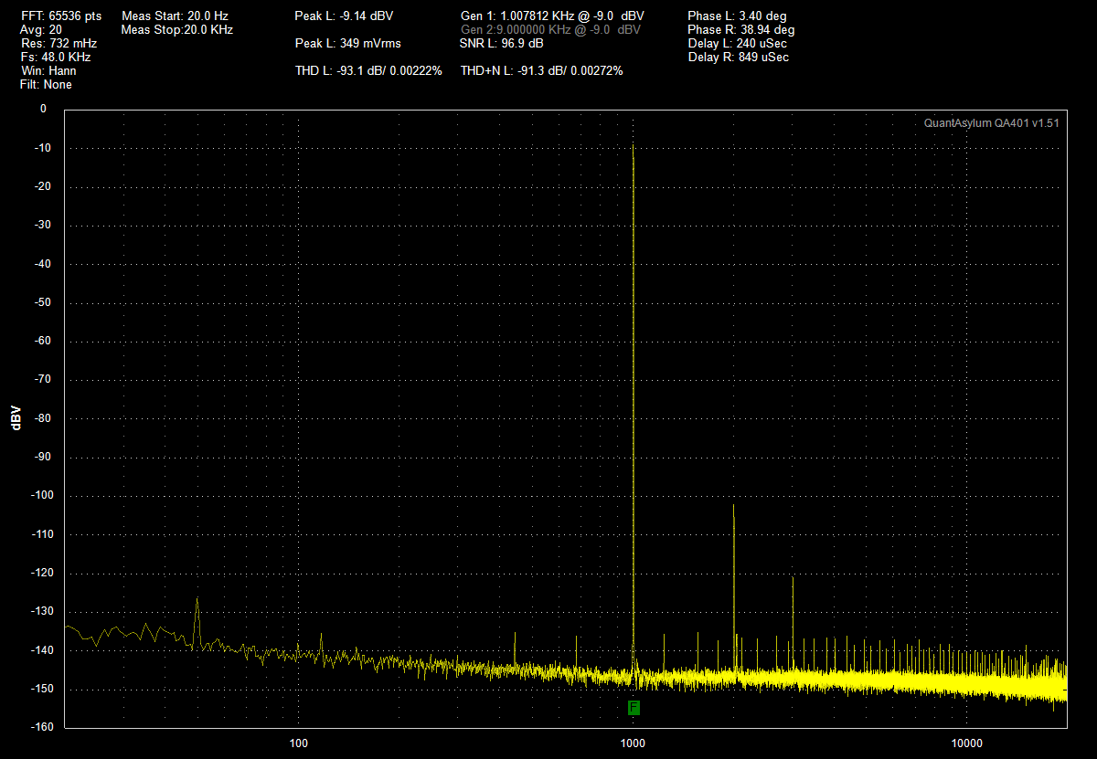

Ignore the plot in post 24! I forgot to connect the power supply bypass caps 😀. Looks much better now - THD down to 0.002%
Sorry for off-topic posting here but this got me curious. Is it generally accepted that power supply bypass caps (I presume these are small film or ceramics across the main filter caps, but correct me please) helps get rid of 2xmains frequency noise from the PSU? I am seeing a very similar noise pattern from my F6 PSU and wonder if this is worth trying...?
