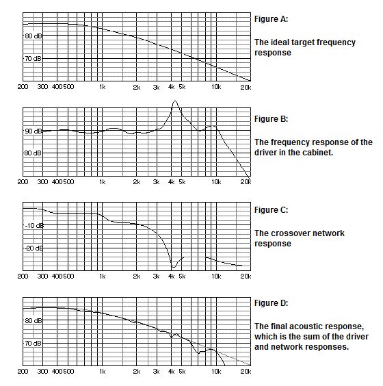

An accurate 1st order acoustic Xover designed for flat SPL normally requires dozens of components(fig 1&2 from Thiel).
I realise that a 1st order acoustic XO is much more complicated than a single series reactve component.
However, given the large number of components on that Thiel board, I could end up being flat broke after achieving a flat SPL in my restoration project!
… a 1st order acoustic XO is much more complicated than a single series reactve component…
Typically it is. Tysen V2’s passive 1st order XO has 3 C, 3 L, & 2 R in it (the design is proprietary so no XO map will be posted).

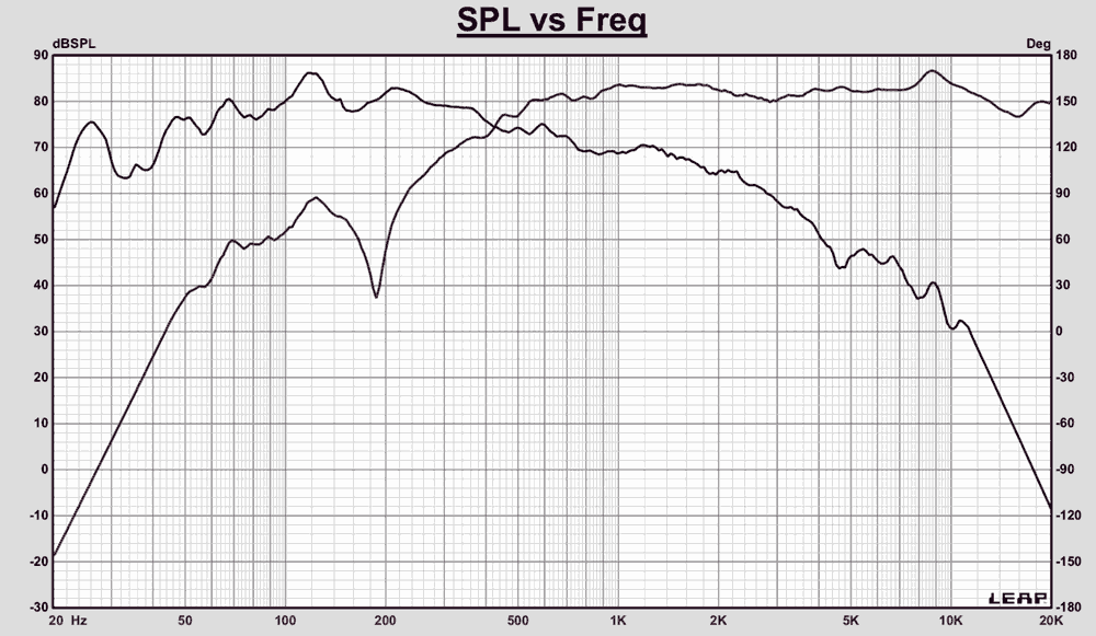

Is it the consensus that true 1st orders are rare and difficult to obtain due to the need for added correction networks ?
Not only that, but they fail to control diaphragm excursion. The usable lower frequency limit of all drivers is determined by the maximum amount of linear excursion. Each halving of frequency requires 4 times the excursion to achieve the same SPL. A 1st order slope only halves the excursion for each halving of frequency, therefore the diaphragm excursion will still rise out of control with reducing frequency. The only way it can work in practice is if the slope steepens from 1st order into something else and because a 1st order slope is so shallow, this will have to occur several octaves below the crossover frequency to avoid notable cancellation with the LF driver (due to phase no longer tracking). Therefore to cross two drivers 1st order, there needs to be perhaps 5 or 6 full octaves where both drivers have near-flat amplitude and phase response, and the HF driver doesn't run into a distortion issue due to over-excursion. That is a rare scenario.
edit: Here's excursion for 1st (Red), 2nd (Green) and 4th (Cyan) order highpass filters, all Butterworth @ 1kHz.
Note that even 2nd order must steepen at some point to avoid introducing distortion due to all the out-of-band frequencies. 2nd order can steepen much closer to the crossover frequency without being noticeable: just two octaves away it is -24dB which will cause a negligible ripple in the system response if it becomes out of phase. 1st order is only -12dB at 2 octaves away, so any deviation in the phase will cause noticeable ripple.
