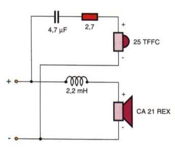

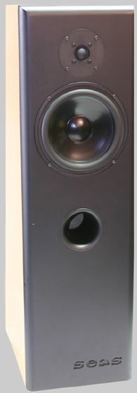

Always good to find a proven design like SEAS Njord:
Most SEAS 8" woofers and 1" tweeters should work with that idea. The second order tweeter solution would add a 0.2mH shunt coil after the series cap and possibly put 2.2R in front of the circuit rather than 2.7R after.
About 3kHz crossover just because of the natural rolloff of a 8" bass. Which shouldn't faze most good tweeters.
The CA21REX woofer is no longer available and I am happy kits exist for them who don't want to experiment, play around and learn, but rather just want a developed project - I actually want to learn, develop and get my hands dirty 🙂
