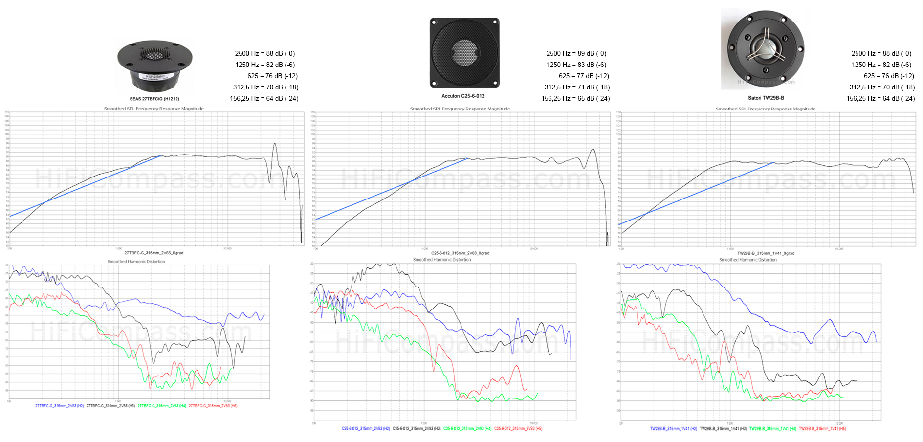

I will use tweeters to kickstart this debate and have provided an image with 3 different tweeters. There is one aluminium, one ceramic and one beryllium tweeter. Each tweeter is presented with its frequency response (on axis), harmonic distortion aligned to the freq.resp chart and in blue, the virtual 1st order slope with xover target sat to 2500 Hz.
So what is my question you might ask, well, it is this:
I will assume that 1st order compliance and the "rule" behind how it handles the -6dB slope has a linear relationship. As such that for a midrange, the mirrored slope is applied at the top end. Here cone breakup place a much larger role than for the tweeter, so I am aware of this and if such is important for the definition, do add that information.
I guess that is it for this entry, I hope people here at diyaudio.com has some answers to clarify the issues I have.
We can by looking at the freq.resp and distortion plot tell that the degree of flatness or neutrality differ between them, also when and how severe the cone breakup is. I have not included the Fs for these drivers if this matters, but that is easily done.If we use the 3 tweeters provided, how does one see or tell without listening if it can deal with a 1st order crossover network ?

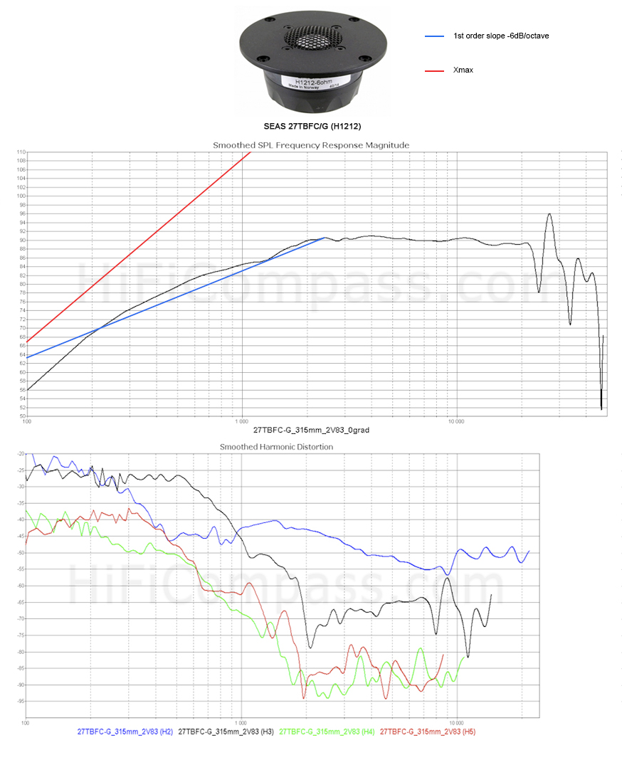

Okay, lets do some calculations then - yes, I can put in the effort of calculating in order to find some answers.
I will use the SEAS 27TBFC/G which was one of the tweeters I included.
I will use the 1st order plot to map out Hz and excursion in dB within Xmax which gets us the following:
Sd = 7.5 cm^2
Xmax = 0.25 mm (p-p = 0.5 mm)
2500 Hz =123.8 dB
12500 Hz = 111.8 dB
625 Hz = 99.7 dB
312.5 Hz = 87.6 dB
156.25 Hz = 75.6 dB
100 Hz = 67.7 dB
At 100 Hz, the Xmax is at 67.7 dB. This is an gain increase of (67.7-56 = 11.7 dB). If we apply an 11.7 dB increase from the baseline at 2500 Hz which is 88 dB, we would produce 99.7 dB.
a +10 dB is x2 volume loudness and x3.16 SPL increase. Normal listening levels in the home is 70-90 dB. 99.8 Hz is fast reaching the tolerance of what we normally endure.
Very important measurement, besides frequency response and distortion, is impedance vs frequency graph. Very high impedance peak at resonant frequency can make otherwise excellent tweeter unusable with first order filter (serial capacitor). Serial first-order crossover may be much better option in that case.If we use the 3 tweeters provided, how does one see or tell without listening if it can deal with a 1st order crossover network ?
Without listening, simply put serial capacitor and tweeter measurements in a simulation software (Vituix CAD is excellent and free), and see what is happening. Monitor how much distortion harmonics (especially the third) are attenuated below crossover point.
You are assuming ideal resistance for the tweeter impedance - it is not.Okay, lets do some calculations
So, impedance at Fs and harmonics distortion bellow x-point. This suddenly shed some light on the matter so let me ask you this.
Besides Xmax at any given frequency, is it correct that if the driver goes beyond a certain THD % bellow x-point, its considered unusable for 1st order ?
Again, If I knew everything that is involved, I would use it or calculate for it. But since no one is spoon feeding me info, I must guess and use what I know.
I do understand that the impedance on the voice coil changes as the temp goes up, but that is not part of the equation which is under ideal situations.
Yes, but you need to measure distortion at higher SPL, say 95 dB/1m. Some very competent experts are not convinced in the importance of low loudspeaker distortion, but my experience tells otherwise.Besides Xmax at any given frequency, is it correct that if the driver goes beyond a certain THD % bellow x-point, its considered unusable for 1st order ?
Other very important point is that with high impedance peak at resonant frequency and a serial capacitor as a filter you will have there a huge peak in the frequency response below crossover frequency - it will not decrease monotonically at 6 db/octave. This peak may be almost at the same level as the normal tweeter output above crossover point.
