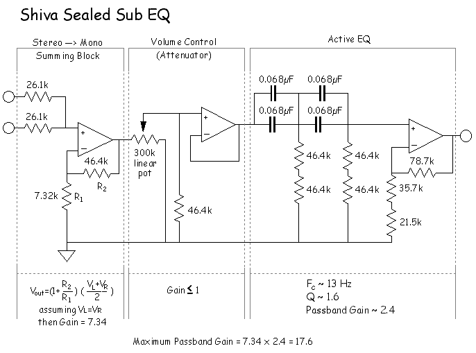

Attached is a schematic that illustrates the level control addition (ignore the summing stage up front & substitute your XO for the LR EQ section)

It looks interesting Dave, nice diagram actually. But for now the baffle step correction is temporary, so I won't be changing it.planet10 said:remember that the LM3886 is also an OpAmp and you can use it to implement your filter (baffle step in this case) -- unlike PM, i'm always trying to avoid devices in the signal path if i can. People seem to be getting good results with a buffer in front of their GC so you could also just use the active BSC as a buffer

I made a buffer with TL071 (in a socket) last night, on veroboard. I used + and - 6.7v, off the shelf bridges, 15,000uF at trafo. end and 1,000uF on the board. I decided to test it by placing it between my volume pot. and the lowpass filter I made.
To make the thing, I shorted OUT to -IN and connected the output from my volume pot to the +IN pin. I placed a 22k resistor from its psu 'GND' to the input. Otherwise GND comes straight from LM3886 (main power amp) along a wire where it meets the 22k to the buffer's psu GND and carries along to meet the lowpass filter's GND.
This works, but produces CONSIDERABLE hum. I guess I have the basics right, but have ******ed up the grounding scheme. My problem is that schematics often don't show what to do with ground connections. And not really understanding much electronics, things tend not to work quite right...
Should I introduce a resistor in series with ground from one circuit to the next? Should I remove my 22k resistor to ground in the buffer circuit? Does ground in the buffer circuit need connecting to anything at all?
