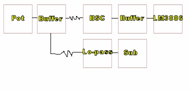

Next question - I see on Elliot's diagram, that the volume control goes *before* the buffer stage. I thought it might have been the other way round.
My main question is - how many buffers do I want, and where do I put them, when I (currently) have:
input > baffle step correction > pot > lm3886 + active lowpass/sub
Should/could I use:
input > pot > buffer > baffle step c. > lm3886 + lpf/sub
Would I not want to somehow isolate the precious low-level signal that goes to the power amp chips from what goes to the x-over circuit?
Could I place one (100R?) resistor in series with the buffer and LM3886, and another in series with the sub x-over? Am I just imagining this would somehow separate their signals?
What I worry about is contaminating one of the LM3886 inputs with noise picked up from the sub x-over wire - which will lead quite far to a separate box....

The first place you need to put a buffer is between the passive volume control and the filter input. This buffers the filter from the volume control and stops the volume control's variable and relatively high source impedance messing up the filter.
EDIT: added diagram
Input - volume - buffer - baffle step - chipamp
............................... - filter - subamp

Crikey Al, you like yer buffers 😀 IMO you could easily lose half of those IMO as the baffle step and filters will be able to drive stuff OK, and the first buffer will drive a couple of stages without bother.
I like buffers! When you have friends like mine that steal half your projects to be used live or go into studios, you take nothing for granted - you never know how long or what quality the cables are that they will plug in. Buffers are our friends! 🙂

Thanks for the suggestions!
I don't think I could cope with building 6 buffers PM
This amp is destined to find it's eventual home at the office, to prodive background music (from PC, probably no BSC), and I don't want to spend tooo much more time or money on it. It's only temporarily in my main system, for evaluation and experimentation.
The sub x-over is long term though, and will probably be plugged into future chip-amps.
I like the setup suggested by richie00boy - much more simple!

Great, sounds good to me. All apart from "If the baffle step circuit is active, it will probably have a buffer function of its own." -- the circuit does not have any buffer, it's just a couple of resistors and a capacitor. Perhaps I need to take this into account too.Jennice said:Simon,
Ah, yes. My mistake assuming it would be active. IMO passive baffle step circuits are a waste of time. Just tack a buffer on the end of it, no need for an input resistor to ground on this one as the DC bias current will come through the pot and preceding op-amp.
I'd recommend some 22-47 ohm resistors on the outputs of the op-amps driving any interconnects (so the baffle step buffer and filter?), to guard against possible capacitive instability due to the cables.

Hi Simon,
I do not know the input impedance of your LMxxxx based amp. If it is high enough, you can do without the buffer between the BSC and the amp. Other than that (of if in doubt about the amplifier input), your setup looks fine to me. Good luck with it.
