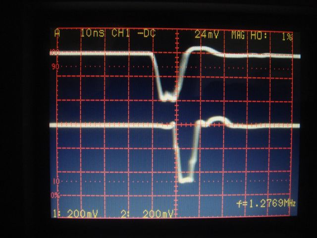

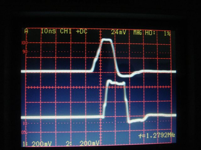

I examined it and decided not to use it.
The overlap can be serious.
Especially if the pulses are short...
If you feed this into the inputs of the driver...
Upper trace: High Side Input with 2V/Grid
Lower trace: Low Side Input with 2V/Grid

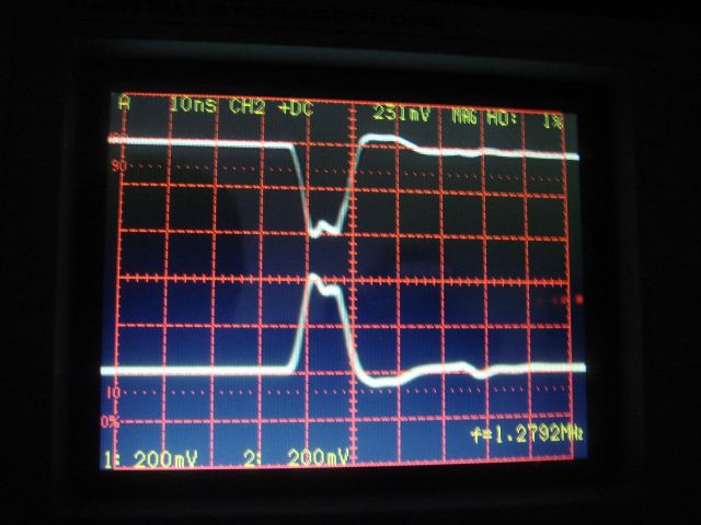

...then you do not just get slightly longer ON pulses at the output... it may happen that the High Side Driver does not notice at all that it should move down, while the LOW Side Driver is delivering an enlarged pulse....
Upper trace: High Side Output with 10V/Grid
Lower trace: Low Side Output with 10V/Grid

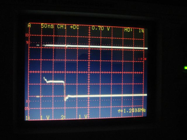

The HCPL9030 is really looking nice, and up to now I was not able to cause any seriously wrong output signals.
Here a screen shot with a short HIGH pulse.
Upper Trace: Input, 2V/Grid
Lower Trace: Output, 2V/Grid
