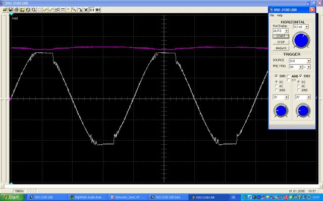

The clipping behavior is slightly suffering from stronger overall feedback, but still not bad.
The strongest power supply, which I have on hand, is sagging at 500W fro,+/-55V to +/-48V.
Clipping happens at 500Wrms into 1.9 Ohms.
So in bridged configuration you will get 1kWrms into 4 Ohms, if you have a strong enough PSU.
The red trace is the positive rail.
The white trace is the clipped output signal.
You can see roughly 4V difference between rail and clipped output. These 4V are lost in the current sensings resistors, the switches, the filter choke and wiring (still some room for improvement).
I used 10:1 probes. So the scales are 20V/grid.

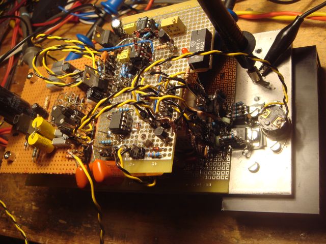

So far the results are fine.
I should be happy.
But.... Ughhhh, what's this?!!!
...may be I should now really think about making a proper PCB..

I agree. Especially for class D a proper PCB is helpful, but doing the fundamental design is so much more fun.
P.P.S:
I needed to do this fundamental learning exercises.
Without this proto, I would have missed many important basics and wasted several time consuming and expensive PCB design loops.

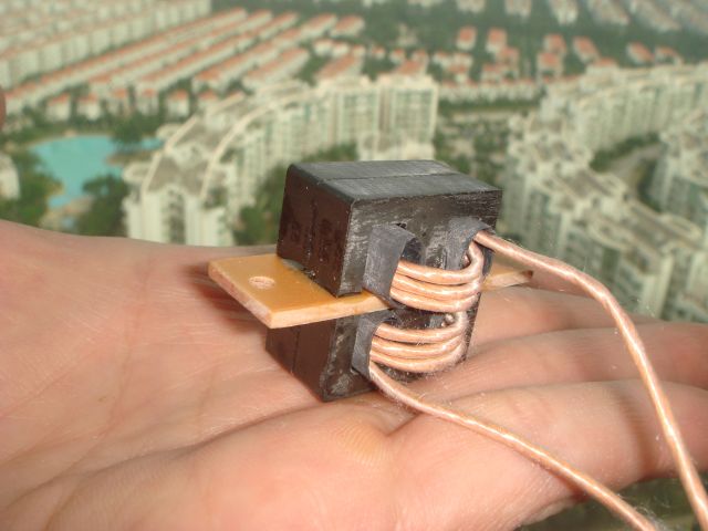

Anyway, this is good news to me because I have a new version of my coupled-inductor magnetic snubber for +/-200V class D that achieves much less copper and core losses, like only 25ºC temperature rise for 2500W output at 50Khz 😀 Since magnetic snubbers impose variable delays, your results imply that I could get low THD with my approach too and enough feedback 😀 I have even better cores in the way that should theoretically allow to get similar losses at 100Khz, so cool full-range 250Khz operation may be practical now.
