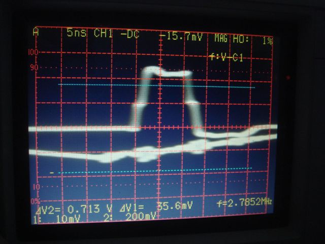

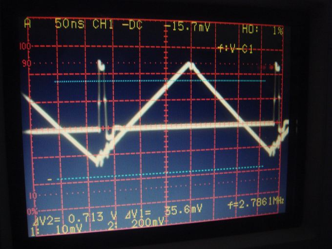

I started to play with a triangle modulator followed by a fast level shifter.
The comparator was the LT1711 and the isolator/level shifter a HCPL9030.
The HCPL is known as fast, but critical with.
AD has made a comparison and is stating that with noise you might cause the HCPL to go for wrong HIGH signal at the output.
http://www.analog.com/UploadedFiles/Product_Highlights/5406830898840Agilent_NVE_FMR_IsolatorsF.pdf
Up to now I was not able to force this misbehavior. HCPL9030 acts like a nice guy so far in my breadboard set up.
More difficult seems to be to settle a blameless triangle modulator for pulses below 10ns. In myexperiment the pulses are becoming instable and jittering below 10ns.
Please note that my screen shots show the triangle and the output of the HCPL, the output pulse of the LT1711 happens a few ns earlier,
First screen shot unzoomed with 50ns/Grid.
Triangle is shown with 100mV/Grid
Output of the HCPL with 2V/Grid
