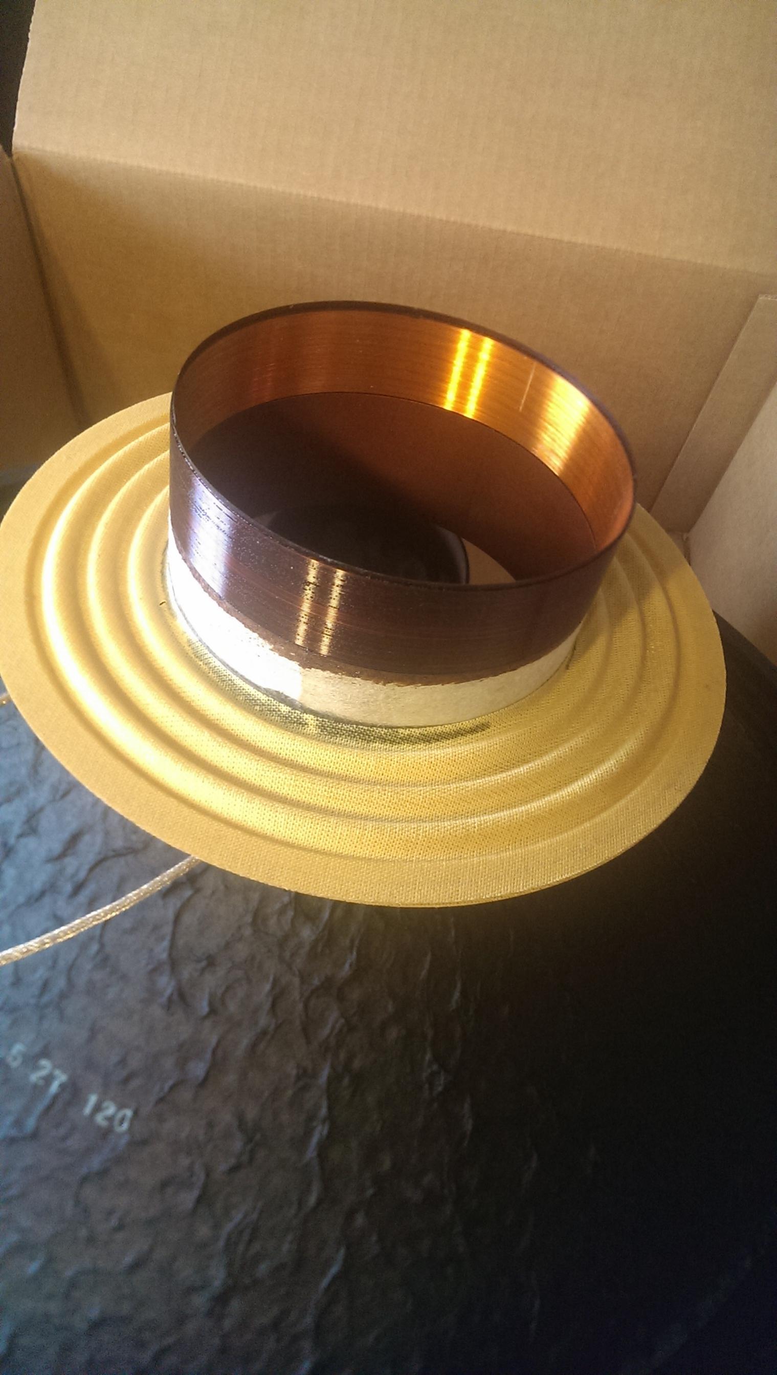

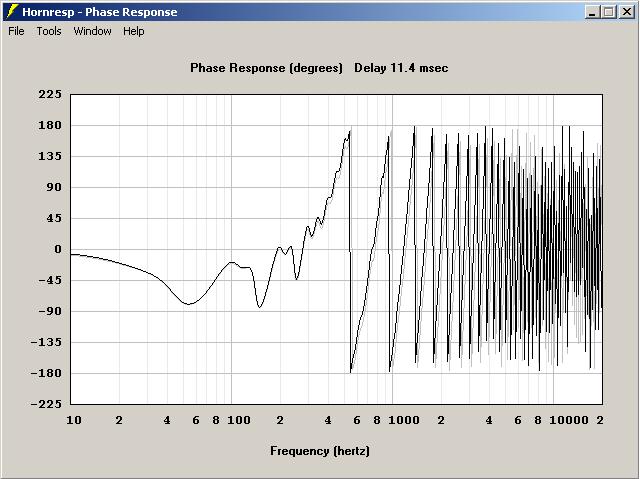

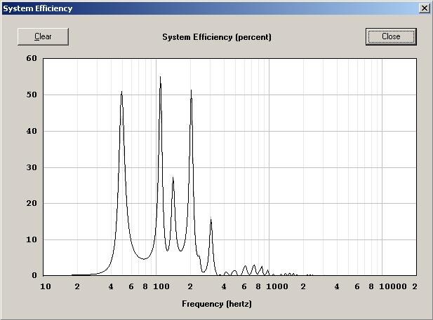

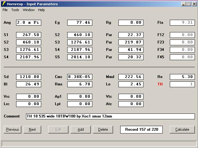

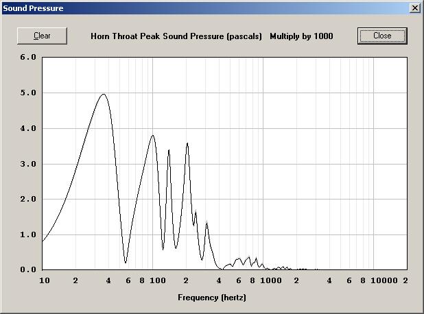

Thanks, all, fo your input. I know the driver most likely didn't burn up from that one night alone. The proof is in the pictures and the driver has taken a lot of long-term heat.
Now, I'm buying a replacement driver for the meantime and I have a question about acoustic coupling.

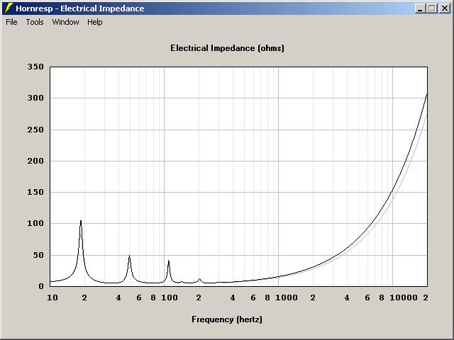

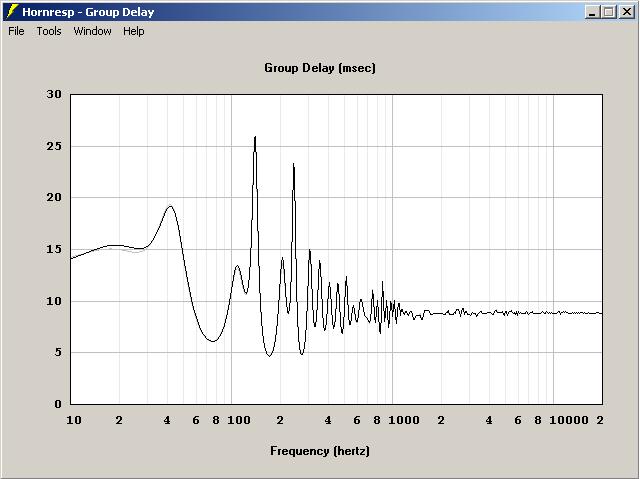

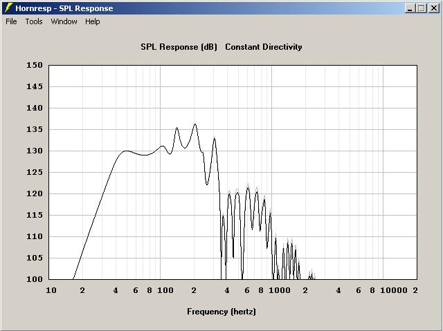

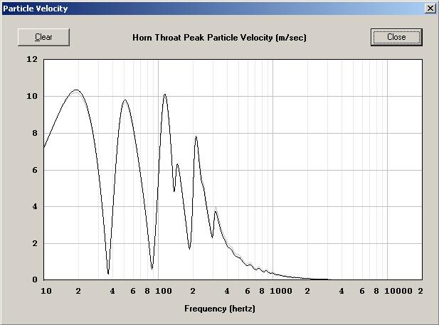

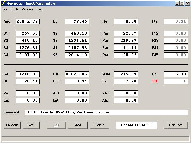

The 18TBW100 is just shy of $50 cheaper. It and the 18SW100 sim nearly identically in hornresp. How similar? I've included the screen shots below.
Will this different driver allow acoustic coupling with the other TH18s loaded with 18SW100s? Are their differences so minute that it's practically the same as panels inside the cab being 1/16" off, due to a non-robot built enclosure? Is there more to it than that?
Or is this small difference just enough to push it out of acoustic coupling mode? I'd rather spend the $50 to keep it.
I'd like to hear your thoughts & similar experiences.
Black trace - 18TBW100
Grey trace (if not completely covered by black trace) - 18SW100

1) Yes.1)Will this different driver allow acoustic coupling with the other TH18s loaded with 18SW100s?
2)Are their differences so minute that it's practically the same as panels inside the cab being 1/16" off, due to a non-robot built enclosure?
3) Is there more to it than that?
4)Or is this small difference just enough to push it out of acoustic coupling mode?
2) Yes.
3) The cabinet design largely determines the phase response, unless a driver is loaded in it that won't work with the design and results in a totally different (like unusable) frequency response.
4) No, as long as the phase response is within about 90 degrees (1/4 wavelength) at a given frequency, the cabinets will acoustically couple.

And then two days later, I catch wind of a very small (out of his garage) speaker repair company who claims he can get the recone kit (which is unavailable to me for 4 months) in 7 days and have it reconed for less than the price I can buy the kit for... Too bad I didn't find out sooner. Oh well - guess I'll have a spare/one to experiment with..
like has been repeated a couple times in the thread, hit that driver with enough voltage at excursion minima, and the heat will take its toll (around 34hz).

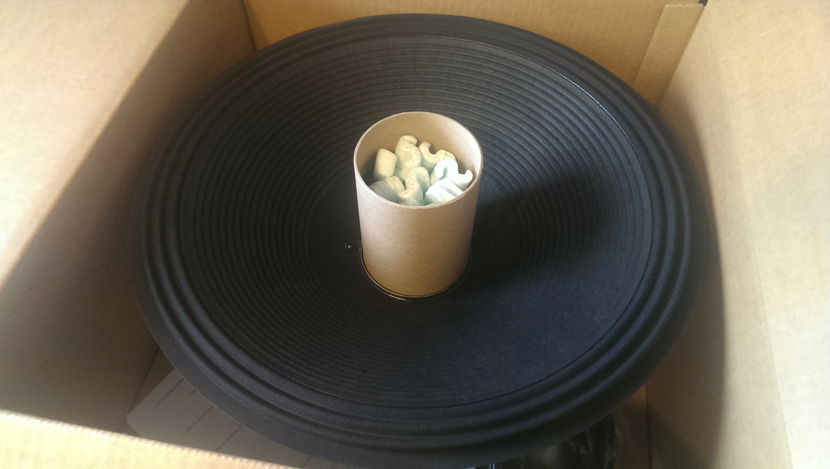

My MacKenzie recone kit came in (5 day wait (shipping time) vs 4 month wait) -- they claim they're built to same standards as the OEM kits. Anyone have experience with MacKenzie? Another engineer in town with experience didn't have anything negative to share w/his RCF recone kit.
These don't come weatherproof'd -- they informed me that B&C does this after production. Would 'Wet Look' from Parts-Express be a reliable option? Do you suggest a different weather coating product?
On B&C I think they use epoxy to seal up the cone on both sides, you might call them and ask about how many grams they apply.
