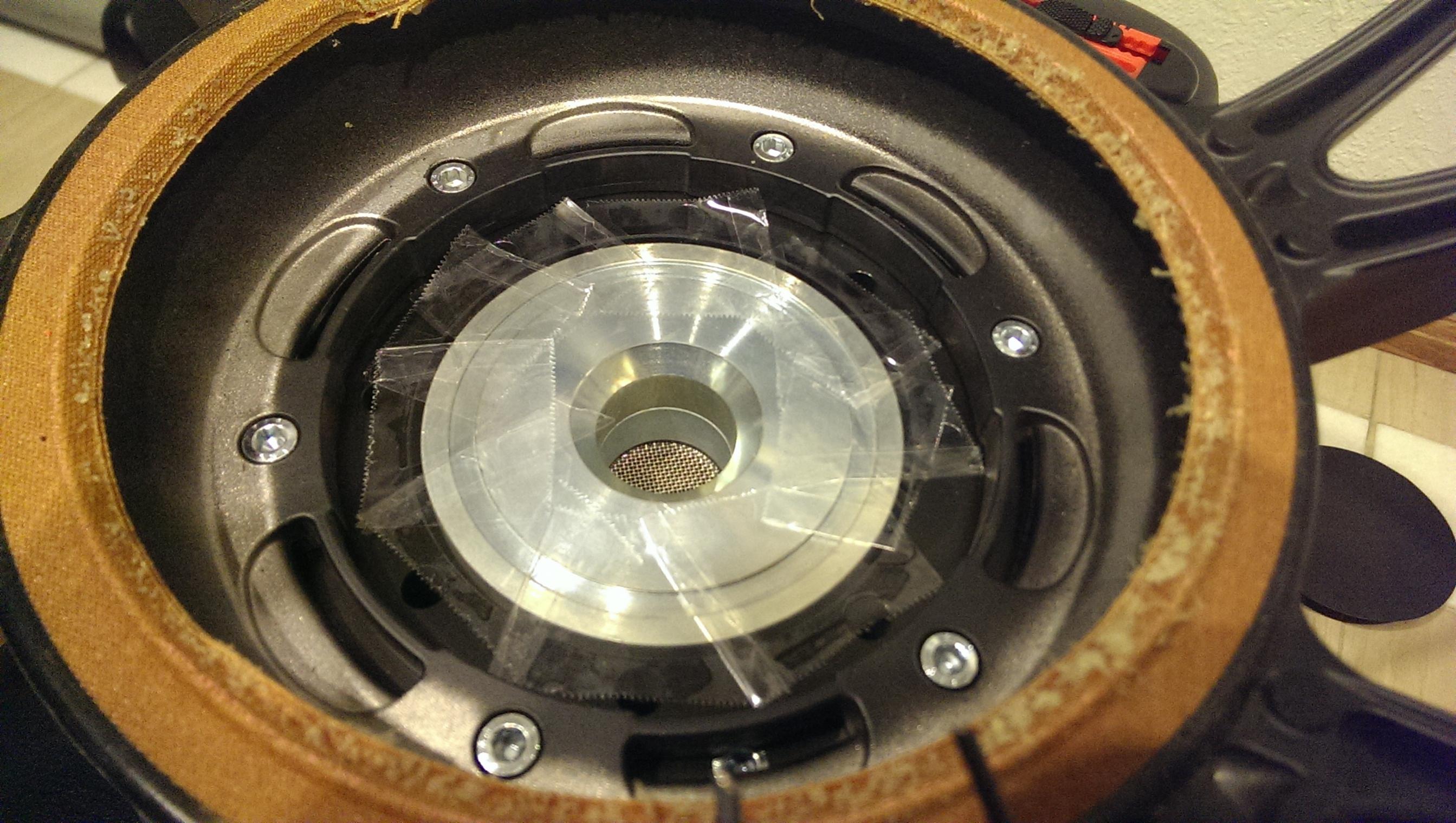

the damage on the plate looks like its outside the gap>thats no problem.
if it is in the gap,you have to remove that bit.
don't use sandpaper! maybe a hammer with screwdriver to gently tap it .watch out for the magnetic force.
make sure that no iron flakes get in the gap.

I don't claim to be an expert in this area, but the damage on the top of the machined pole piece/plate does not look like it would result from the voice coil wire rubbing. That's a comparatively hard steel, and according to B&C a copper voice coil, if I had to guess this damage was there when the driver was assembled. It looks like a manufacturing defect to me.

I agree with TB46 that the indentations look to be a manufacturing defect, and if they do extend in to the gap, could be responsible for scoring the inner voice coil, which could cause arcing which would make the coil open.
That is doubtful though, as you would have heard some scraping, and the sloughed off coils just indicate too much heat from being presented too much average power.

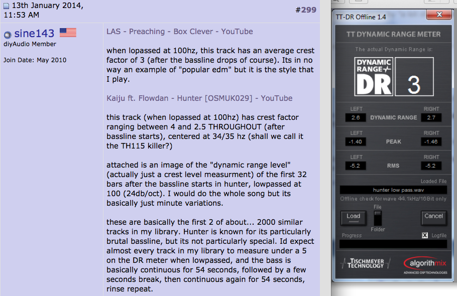

Since the thermal limit of the 18SW100 is around 750-1000 watts if the music has only 3 dB crest factor, the voice coil could be heated enough to melt the adhesives without any clip/limit lights illuminating.
Until recently I had not thought any LF music would have less than 6 dB crest factor (the dynamic range of the AES test signal), but sine 143 showed an example (and says he has about 2000 similar tracks!) of LF with only 2.7 dB dynamic range, even less than a sine wave!

Many DSP (and most analog comp/limiters) have RMS limiting, if the attack time can be set quite long, like 200ms or more, and the ratio is high, like 10/1 or greater, the peaks will still get through and the amp limiting will take care of them, but the RMS level can be set low enough so music like the "Hunter" won't "kill" your voice coils.
RMS limiters can be set easily using a 50-60 Hz sine wave and measuring amp output voltage. This can be done with no load, but should be confirmed with a load similar to the impedance the amp will be loaded with, as many amps will put out less voltage with a load.

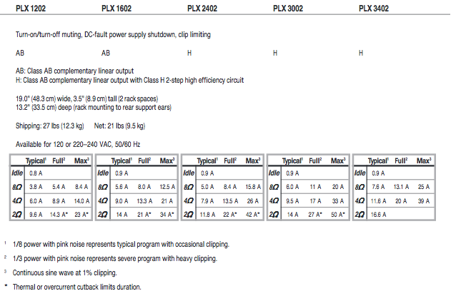

I still wonder why the amp wasn't giving any warning signs. At 1/3 power, those amps draw over 30A off the wall socket. Not to mention, putting out the heat of a blow dryer... which should only be allowed to go on for a few minutes before something trips.
The PLX 3402 draws 39 amps full tilt with sine waves, which would pop it's breaker in a few seconds.
Putting out 1000 watts of sine wave like material (enough to cause thermal damage to the speaker), the amp would draw about 11.5 amps.

I took some pictures after cutting away the surround & spider. I'll attach them here:
i sugest to immediately put some tape over the gap.
