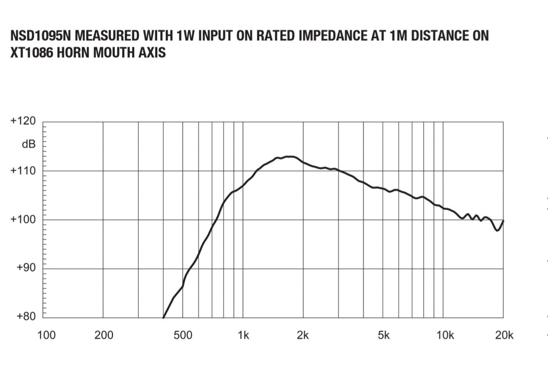

Looking at the 18sound data sheet, with the XT1086 horn, the response over 10k is down to 100dB. This will be a close call to eq flat with passive xover (cap + R shunt). The response is remarkably flat and the primary driver resonance is at 1k with much smaller secondary peaks at 1.7k and 3k. Based on the primary 1k impedance peak, the driver should be able to go down to at least 1k with a suitable WG and treating the 1k peak with an LCR notch. The limiting factor in the published FR curve is clearly the XT1086 WG. Looks like a nice option to the DE250 as a higher end 1 inch driver. I wonder if the TI diaphragm option for the DE250 is in some ways better than the polymer diaphragm?

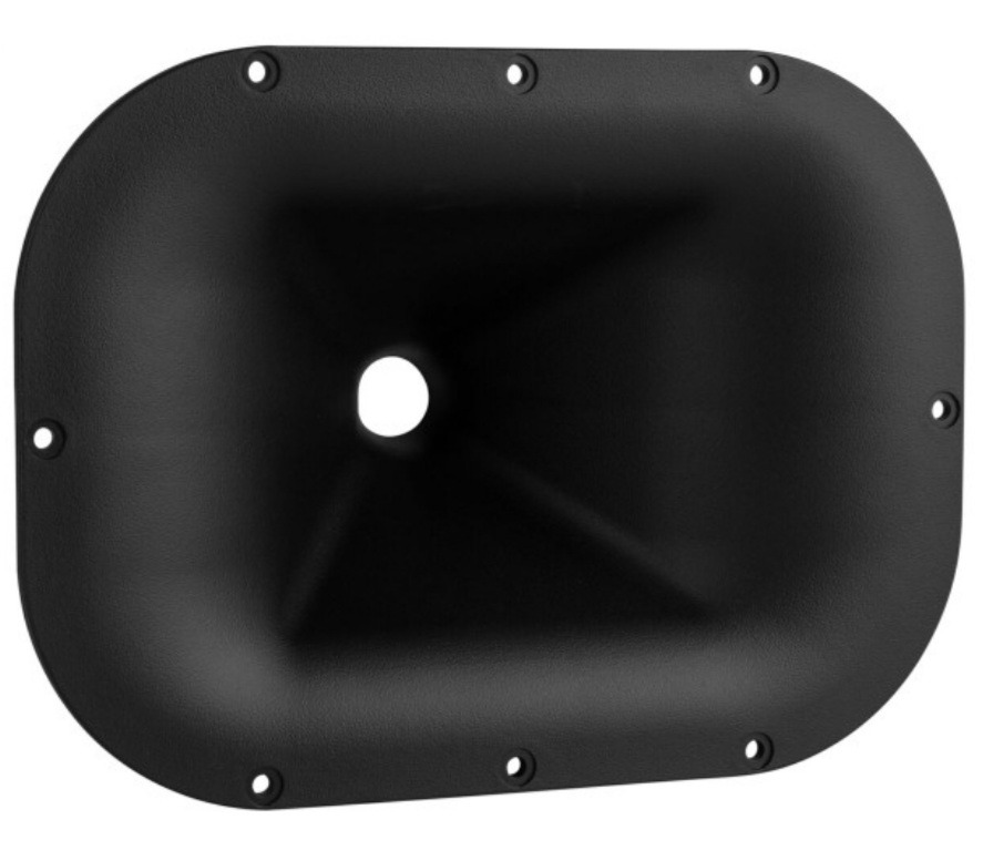

The main things I like about the WG10 are rounded over mouth and the standard bolt on flange, which makes getting a precise fit easier to the CD. The DE250 has an exit angle of about 14.7 degrees according to the spec sheet. The NSD1095N is a little less, which should favor a deeper WG, so we'll see how that pans out with the rest of the WGs. The SEOS 12 got my attention too. I have a few Martin OEM WGs coming as well, plus a few leftover Selenium HM25-25 expo WGs.
