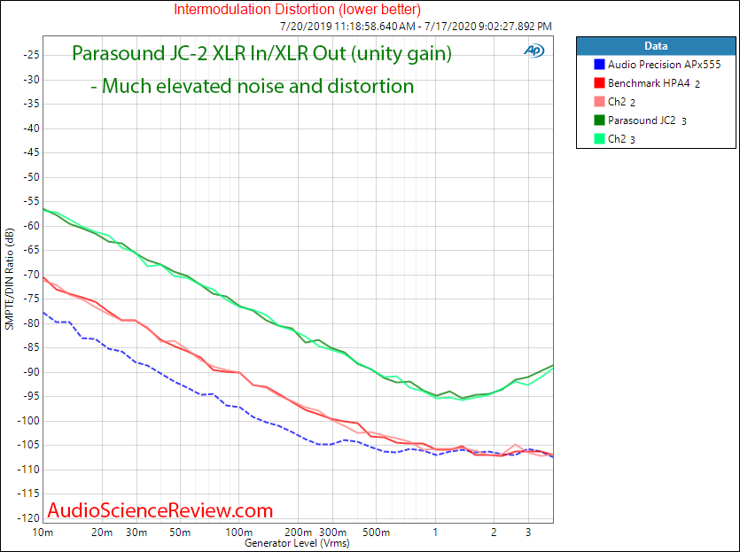

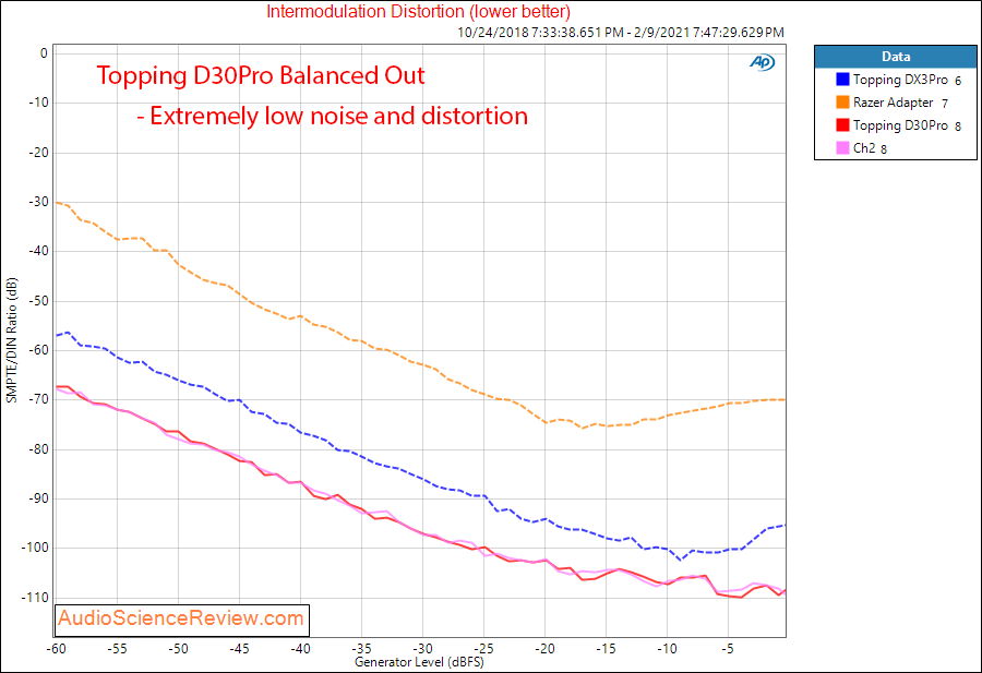

Thinking about gain structure one might want to ultimately to remove +gain in the analog path as opposed to do a lot of digital attenuation - A DAC is (often) at its best at near 0 dBfs - no? E.g. many class D amps use a pre-stage with a gain of appr. 10-15 dB to reach typically 27 dB amp gain.. one could start to remove this if the exposed impedance is not to low for the proceeding node.
I have done both, but can't say what is better...Thinking about gain structure one might want to ultimately to remove +gain in the analog path as opposed to do a lot of digital attenuation //
Of course, often around 0dBfs the best but the same is true to active analogue attenuation and which is better, depends on the actual design:Thinking about gain structure one might want to ultimately to remove +gain in the analog path as opposed to do a lot of digital attenuation - A DAC is (often) at its best at near 0 dBfs - no?
Anyway, I am using passive, speaker level attenuation for a CD+horn on a DSP based crossover system (like the OP) and liking the result, although it was not bad without passive attenuation but some noise was evident bacause of the very high sensitivity driver.
