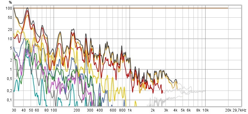

Okay, here is a sine sweep, the driver is in a 90 l sealed box, filled with fibreglass insulation. The noise originates from the woofer, not the box or the environment. Full of cr@p and distortion from bottom to top.
I've also tried the 1Hz sine wave and it sounds like the voice coil is rubbing, but if I gently move the cone by hand, there's no rubbing noise, only when the amp moves it.

OK, that sounds not healthy. At what frequency is the noise worst?
Next, I would mount the driver in the box, but magnet out in the air. Run sweep again, then feed it the frequency it is worst, from low to high volume. You should be able to find the exact source of the sound.
Are these used speakers? Did you buy them from a regular dealer or private person, described "new"?
Double check your measurement setup. That sounds alot like when REW is glitching out. If you have another computer with REW or some other way to test I would try that first. Normally when I hear that crackle sound in a sweep I have to change the speaker channel to another in REW then change it back. You could even go to youtube and find a video with a sweep and see if it still makes that noise.

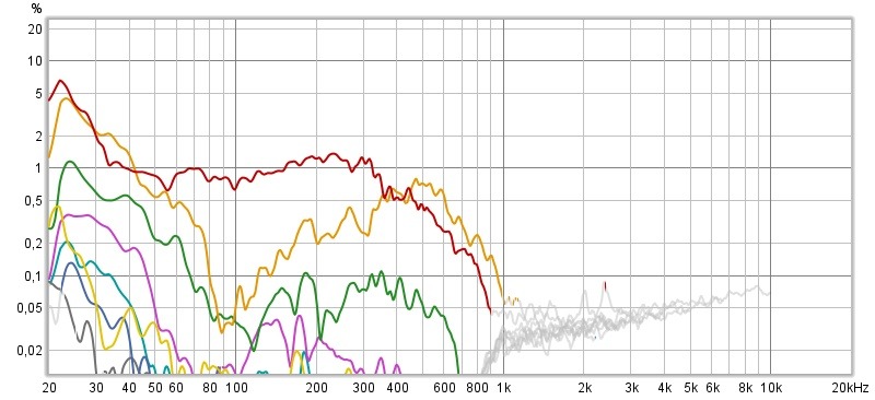

Thanks Samps, indeed it was a REW problem with the previous measurements, I changed the output device and the sweep is clean now, at least from the software side. The VC is not rubbing and the problematic aera is in the midrange I think. Maybe I hear the elevated 3rd HD around 500Hz or some IMD or both?
Here is a measurement with 500Hz LR4 low-pass (that's I will want to use with the completed speaker), the low-end distortion is probably due to the flimsy test box:

I think the problem you found out on your own is that 400hz is pretty high crossover point when it's also a steep crossover,
and this is more of an issue than 3rd harmonic- a low order HD that's just masked by auditory system.... It's not too exhilarating trying such crossovers with earphone/headphone either unless you are below 200hz or so.
Please, how many times I need to write down that other woofers (e.g. Eminence Kappalite 3012LF) in the same situation with the same crossover don't sounds problematic/distorted at all.
But yeah, maybe the crossover is indeed too high for the Faital 18FX600, because it's not a midwoofer and that huge cone can resonate/distort easily.
Well my point was that filter order has a sound regardless of driver the higher the point the more objectionable. And IMD from 3rd order HD should be less objectionable than IMD from 2HD anyhow.
Of course, each filter order has a different sound, which is why they are called different filter orders and thus can perform different functions. I don't think the crossover order itself is the problem here, because I wrote many times in this thread that other woofers I tried with the same filter order do not show this problem.Well my point was that filter order has a sound regardless of driver the higher the point the more objectionable.
Moreover, even without any filter, the distortion is still audible, but it slightly masked by higher frequency content.
I don't think the crossover order itself is the problem here, because I wrote many times in this thread that other woofers with the same filter order don't exhibit this problem.
Realistically if you asked someone else to rate 400-500hz steep crossover with diff drivers the answer might just be it's just different kind of bad...
IMHO a filter order and crossover frequency means very little without knowing the drivers used with it. I heard many speakers with 4th order crossover within the 250-1000Hz range and none showed a problem like this, so please go out of this thread with this theory. As I said, the distortion is there even if no filter is in use.
Even the manufacturer himself stated that this driver is a subwoofer, the smaller brother 15FX600 is good for up to 400-500Hz crossover but the 18" version is (probably) not:
