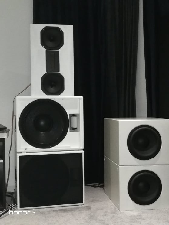

I got the idea to build a large, DSP controlled 3 driver 3 way speaker by using a 18" woofer (namely the Faital Pro 18FX600). The midrange driver needs to be used from 400 Hz, otherwise it's distortion is high. My initial problem is the 18" seems to resonate/distort if I run a sine-sweep in free-air mode. My Eminence Kappalite 3012LF doesn't acts like this. But recently read somewhere a similar problem, and when the 18" was secured to a baffle/box, the distortion had gone.
The 18FX600 is a relative low Mms 18" with not too high Le, so I thought it may be usable up to 500 Hz, where it not beams yet, according to the factory off-axis response.

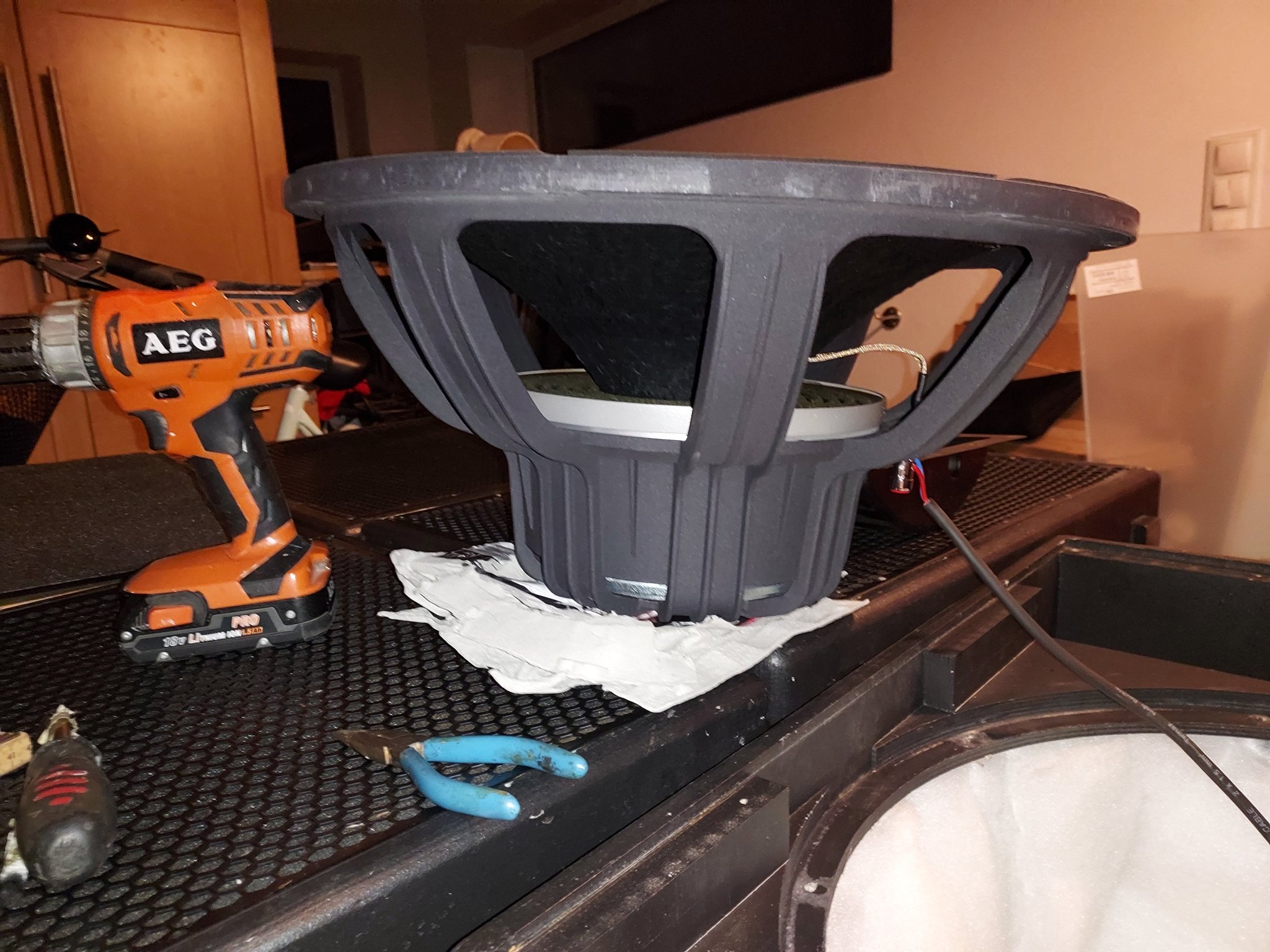

Okay, it seems the Faital 18FX600 is noisy. It's not as bad as when the voice coil is rubbing but similar, even at 1-2 mm excursion. The noise comes from the motor and/or spider, not from the cone. The noise is like rustling combined with some rattling, although this is still in free-air without box.
Does anyone experienced similar phenomenon with other woofers? I bought these brand new by the way and I didn't damaged them. Might even be VC rubbing from the factory?

Could be forced air cooling causing the noise. Some woofers aren't suited for open baffle because of this.
B&C 18PS76 is very quiet in open air....Eminence NSW6021 has lots of noise outside the box.

It seems like the noise of the 18FX600 is coming from the forced air cooling as mentioned by ErnieM. There are narrow slots below the spider where the air moves in and out if excursion occurs. I hope it won't be audible when the drivers get boxes.

I did some tests with the two 18FX600. It seems like not just the cooling produces noise, but also something else, maybe the spider. This is different than the air whistle noise and not generated by high excursion but high frequency. Here is a short recording, 20 cm in front of the cone, 500 Hz LR4 low-pass, woofer in free-air, all electrical connections are secure, the noise is coming from the woofer, not from the environment.

Once you install a woofer in an enclosure, the airflow noise should greatly drop and remain low down to the lower cutoff, where it unloads and noise / HD increases again. The lack of pressure balance in the VC gap, when a driver is played in free air, is the source of most excursion induced noise. Decrease in pressure difference means lower airflow velocity, hence less noise. There are very few drivers which are very quiet in free air. The ones which are quiet in free air usually have higher Qts, thanks to a wider VC gap.It seems like the noise of the 18FX600 is coming from the forced air cooling as mentioned by ErnieM. There are narrow slots below the spider where the air moves in and out if excursion occurs. I hope it won't be audible when the drivers get boxes.

I did a temporary enclosure for the woofer, filled with fiberglass damping mat and it seems like the noise (not the cooling airflow noise) comes through the cone, although maybe not as loud as in free-air mode. I also gently wiggled the lead-in wires, but it didn't make any difference.
