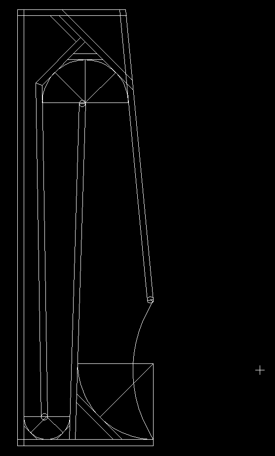

Making progress...
The basic dimensions are all in, I used exactly 0.7" for the ply thickness. Everything is lining up very nicely now, I had to shave a few hundredths of an inch here or there, but such fine trimming should be of zero consequence. There is only one significant difference - I ended up with a slightly shorter 2nd divider vs. the original, so the total horn length might be a few tenths of an inch shorter. Again, I would say this is probably of no consequence, given the wavelengths. Most important, the cross-sectional areas through the horn should all be spot-on now.
OK, it's late now... bedtime. So tomorrow evening I'll work on the actual drawing layers, driver hole placement, baffle, etc, and hopefully start adding some dimensions.
And just a note: when I add the dimensions, I'll also specify each bend center point + radius, so that you can build either a curved version, or the sectioned flat-pieces version from the same plan. I'll do a separate detail drawing for the teardrop flare at the horn mouth.

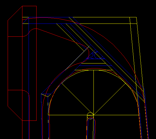

Okay, I did the import of layertone's drawings into mine. So now I have three versions overlaid (well, 4 actually, but I'm discarding my earlier drawing)... the panelized drawing in the pdf, Tony's curved version, and my reconstruction from Ron's rev G. dimensions.
All three match very closely except, as expected, around the second bend... with the corrections noted by bobmar and the dimensions from Ron's original plan, the partition extends up farther than it does in the existing plans, such that the width around the second bend is a continuous expansion, rather than getting wider at the top, and then narrowing again at the exit side of the bend.
I also note that Tony used a slightly thicker panel for his curved version, so in his drawing, things are shifted around slightly.
So, for those who are interested, here is the methodology I used to reconstruct the horn profile from Ron's rev G drawing / dimensions:
As in Ron's plans, I put the x,y origin at the lower left corner. I used 48.00" inches total height, and 15.00" (Ron's drawing shows 15.01") total depth. And I made all panels exactly 0.70" thick.
I then worked outward along the horn path, starting from the horn throat entry point. This is specified in Ron's drawing as x,y coordinates (2.00,39.93). This point matches precisely in all of the plans I have seen.
Next, for each bend, I calculated a radius based on the specified width at the start & end of the bend. For the first bend, start=1.92", middle=2.13", end=2.45". Adding 0.7" (panel thickness) yields the diameter of the curve... so first bend radius = 2.535". I then position a r=0.35" circle at the appropriate point to give the correct start/middle/end widths, and that circle becomes the rounded end of the panel.
For the second bend, widths are: start=4.05", middle=4.46", end=4.72", so the curve radius is 4.735" for a 0.700" panel thickness. Since I wanted to keep all the panel thicknesses as 0.7" for simpler construction, rather than making that first 45 degree piece 0.5" thick. So again working from the horn throat entry point, I drew a 45 degree angle, and offset that by 0.7". I then positioned the correct radius circle tangential to that and the first divider panel. The position of the second divider's end point followed, as did the position of the remaining panels to form the rest of the bend. This is where the discrepancy arose - my second panel is slightly taller (by 0.06") than shown in Ron's plan, but as a trade-off, all the panels can be made exactly 0.7" thick, and the corner dimensions remain correct per the original drawing.
For the horn mouth, I positioned a r=0.35" circle for the panel endpoint - 15" up from the bottom of the horn mouth (y=15.7") - and connected a tangent from that circle back to meet the second bend curve at a tangent. Since there were no dimensions for it, the horn mouth curve was found by drawing a 45 degree angle up from the bottom corner of the horn mouth at (15.00,0.70) to it's intersection with the second divider panel., and fitting a radius to round off that corner. It's not quite tangential where it meets the vertical panel (pretty close), but it does meet the bottom of the horn mouth at exactly zero degrees.
Anyway, here's a screenshot overlay of the three versions of second bend. Blue is the old panelized version (available now as pdf on planet10's site), red is Tony's layered / curved version, and yellow is the new profile I built up from Ron's original rev. G drawing.
There is more work to do on my end before the plans are ready. Stay tuned...
Just to summarize:
Overall, the dimensions I reconstructed worked out very well, and agree within 0.06" of Ron's original drawing (most dimensions in my new drawing are actually within 0.01" - better than anyone could hope to actually cut from real wood!). So I think I'm happy with the reconstructed horn profile.
One thing I just noticed needs to be addressed is the volume of the compression chamber. for some reason, after I put the tangential lines in place to build the second bend, and extended those out at 45 degrees, the position of the compression chamber rear wall no longer agrees with the older plans (or Ron's dimensions!). So I'll have to look closer at that, but I'm confident the horn profile is good, and that's the main thing to get right.
