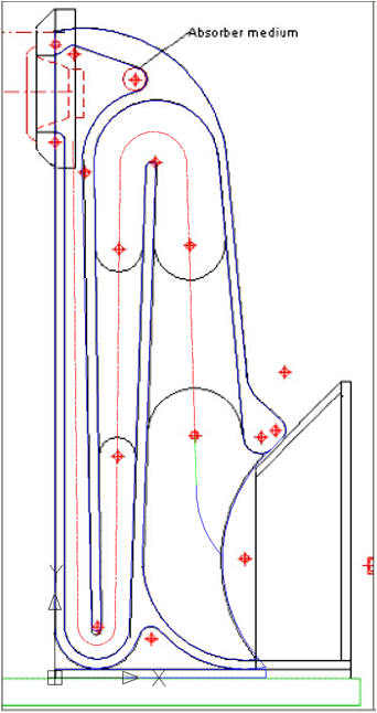

Is it possible to get a copy of your drawings in dvg-format? I´m trying to make new drawings my selves in order to build a pair A166 mkII “Layertone-style”. It would be very useful to have your drawings to verify my drawings so they mach the original as much as possible.

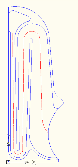

Hmm sorry, AutoCAD (at least, the old version I have) does not have an option for exporting to .dvg format.
If you would like a .dwg file I am happy to provide it, though I'm not entirely sure you should use my drawing as a reference - it's currently the version most removed from the original design. I don't feel especially confident with it, and would still like to get my hands on whatever dimensions, handwritten notes, or other drawings anyone out there has, which refer to something closer to the original design.
Update:
I just found bobmar's notes in another thread... looks like there is at least one dimension correction which is missing in my current CAD reconstruction. I'm going to try and work that in, will update again when it's ready.
Sorry for my bad spelling. I mean .dwg (AutoCAD).
I have full understanding if you don’t want to share a drawing that doesn’t feel accurate enough, especially in respect to Ron’s original design.
However I would be very grateful for any drawings of the curved design as well as the flat panel design, to compare and work with. I’m looking at the drawings I can find and I’m trying to figure out how the curved design should look like. But the only thing I’ve found on the curved design is the pdf-file posted on planet10´s site. I took that pdf-file and imported the picture of the curved design into AutoCAD and have tried to redraw the drawing, see the image below.
As far as I understand, that curved design in the paper is labelled Rev: D and the flat panel design in the same paper is labelled Rev:G. Does any one knew if the drawings labelling are complying with the design order Ron is explaining or is the curved design labelled Rev: D actually the re-design (no.3) made by Tony?

REC1 said:Actually the curved version is first as used in a sim(1). All i did was to adapt flat panels to the curve as close as possible. Tony has the actual curved programming as he developed it from my calculated radi points.
So , the original order was:
(1). a straight expansion (no curves)
1. A curved design extrapolated from the straight.
2. A flat panel design developed from the curved version.
3. Re-design from the flat panel design to another curved version by Tony.
/Fredrik
No problem about sending you the CAD file, I just don't think it's ready for prime-time yet. Anyway, it seems I have one more correction to apply, so I'm working on that. Send me an email, and I'll send you what I've got.
Yes, I would love to have the center points and radii from that rev D plan - it appears to correspond to no. 1 in Ron's lineage... the curved design extrapolated from the original straight taper, but that's a guess on my part.
Reading the other thread, it appears as though maybe bobmar has those curve dimensions... I've emailed him to ask if he can send me that info.

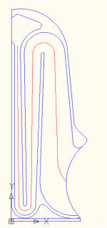

Good news! Turns out, Bobmar had a hardcopy of Ron's original rev G. drawing, complete with all the dimensions - x,y coordinates mostly - and was kind enough to send me a scan of it (Thanks Bob!).
So, now that I have the original dimensions to work from, I'm pretty sure I can straighten out the errors in my existing plans, and produce something faithful to the original design. 🙂
Stay tuned folks, I'll be re-working the CAD file this week...

Yes. I'll post the final drawings here when they're ready.
First step is to re-create an accurate set of plans for Ron's original 166e version. This is almost done.
Then I will produce a second plan, modified for the 166es-r. I am thinking this should include a slight re-shaping of the compression chamber, for better airflow around the huge magnet. With the existing design, the magnet blocks most of the area between the cone and the CC. Maybe this doesn't really matter so much, but looking at the plans I have made so far, it seems too restricted.
Probably I will add a bit more height, and maybe slide the driver up a smidge. The final piece of the puzzle is to reduce the total volume of the CC. I'll leave it deliberately oversized, and then add filler blocks as needed. This in turn means that I will probably design in an access hatch to the CC, or maybe a removable baffle instead. Not sure which - right now I'm focused on getting the basic plan right, and I'll work out the other details later.

I have no better material to work with than the plans posted on planet10 site and the drawings posted by hifiZen in this thread. I’m putting my hope in hifiZen´s work with the hardcopy from Bobmar.
Still, I would be very happy if someone had a copy of the curved design, labeled Rev: D on planet10 site, in high resolution or a hardcopy. The drawing posted there is in .pdf and in not so high resolution which makes it hard to redraw it in AutoCAD.
