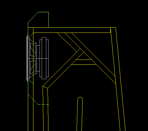

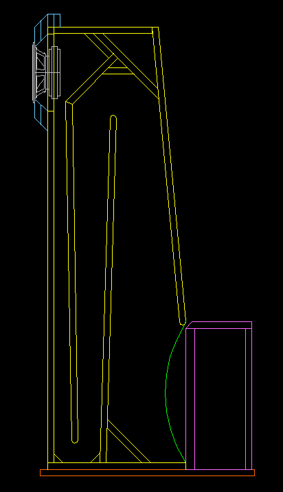

Well, it only took a year, but I finally got 'round to re-drawing the Austin A166 plans in AutoCAD.
I had a difficult time reconciling the dimensions spread across the four pages of the rev G PDF plans from planet10's site. So I don't think it's quite correct, per the original drawing. But, I tried to account for all the dimensions that were shown, plus the correction noted on the front page, in some cases compromising or splitting the difference from what was shown and what came up in CAD when I actually drew it out. So far, just a 2D side view plan, and not dimensioned yet... I'll add dimensions shortly (tomorrow, if I get time).
I took the time to accurately draw the FE166ES-R as well, so I could model how it would fit in the baffle.
And as you can see, I also made the side profile more rectangular, instead of truncating the 45-degree bend at the upper rear. Two reasons... I prefer the look of it this way (less "hunchback"), but also because I may eventually want to experiment with a rear-facing tweeter, so the extra chamber would be useful for that. If not, it can be filled with damping material, which hopefully won't make the whole thing too top heavy.
I intend for the suprabaffle to be removable via 4 large bolts, which will double as magnetic attachment points for a fabric grille. I like magnetic-attach grilles, since they can be left in place for protection / dust cover most of the time, and easily popped off for listening.
With the suprabaffle unbolted and moved forward, the top panel will also unbolt, to provide direct access to the CC and rear chamber... this should be a big aid when tweaking, and then I won't worry about gluing up both sides straight away.

If it helps any a while back Ron Clarke ran the numbers for me and came up with, "CC volume=2.74 liters when a 12.7"x12.7"baffle is used for that driver. Either that or a 12.7 "round baffle."
Would be interesting and great if Ron C. were to give us his opinion of the new es-r revision.
I am planning to use 3/4" baltic birch ply as well. I used 0.7" as the plywood thickness for the CAD drawings, which I hope is accurate (same as the original plans called for) since I don't have a physical sample of 3/4" birch ply to measure.
Thanks for the CC volume info. I'll see if I can calculate what results in the current drawing... do note, the magnet on the back of the es-r is so big, it really blocks off a lot of the entrance, necessitating a large cone / cutout on the inside of the suprabaffle. If you look closely, you'll see that the innermost cutout actually drops down past the top of the horn throat! Hope that's OK.
Only if you space the driver out from the front of the cab.
If you mount the driver flush with the cab, and build the supra baffle back around the sides and top that won't happen.
Also you won't have to stuff the compression chamber so much.
The first thing I noticed was how much clearance there was in the compression chamber; I had to stuff mine a lot to make it sound right with 166es-rs (even with the round foam in back, and damped basket, felt covered magnet, etc.).
Robert :)
More like this you mean... with the suprabaffle flush instead of proud of the front panel? I had to move the driver centerline up to prevent the magnet crashing into the back of the CC, but with a single layer of ply, the inside cone diameter is indeed a lot less.
Hmm, I'll have to think about how to build this. It complicates construction of the front panel and also the removable top panel I am planning.

...but it makes more sense to me with it flush to the cabinet. only prob. is that i didn't know how to calculate for space occupied by the driver/magnet when figuring out volume of the compression chamber for a revision of the org. plans (of which i found no usable version). i don't see the need for a removable front/plate baffle unless you're planing on different driver options. i'm thinking there will be plenty of room to reach into it as is. glad you're going to incorporate Ron C's c.c. numbers. hope we get a good set of workable plans soon, looking forward to building something with the promise of taking the 166es-r to another level beyond the fostex rec. blh.

After much correspondence with REC1/ronc/ Ron Clarke on other threads and forums, I built the A166s as drawn, with "12.7 minimum supra baffles, and adjust the compression chamber to the changed magnet size (and room size)."
Also; (looking from the top), the rear deflector was made square, not triangular, and the speakers were corner loaded.
This sets the proper distance to the corner/rear walls, and the rear walls become the last part of the flair, extending the lower frequency response.
It is smooth to ~40Hz then rolls of smoothly.
