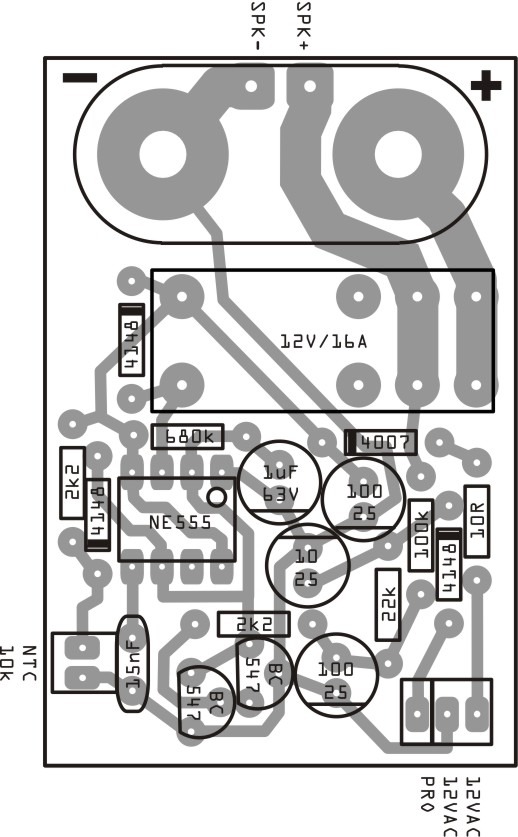

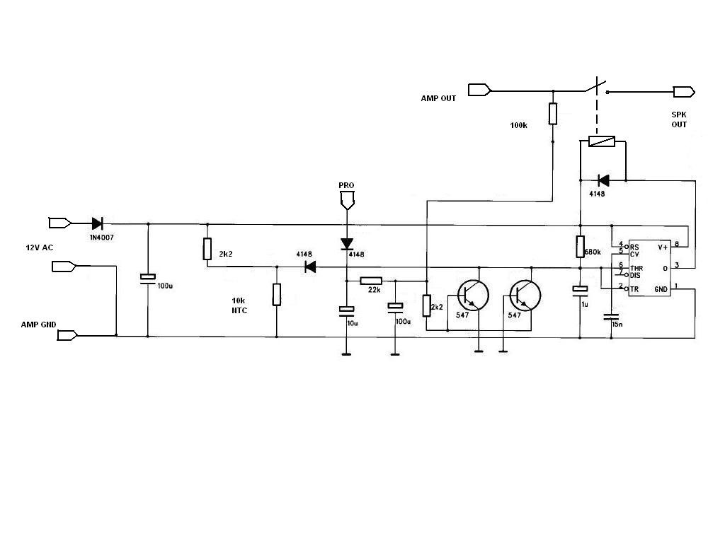

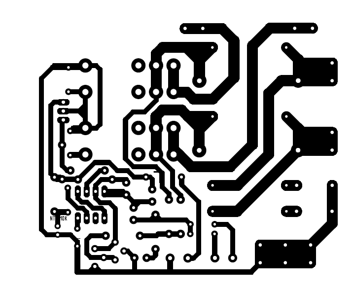

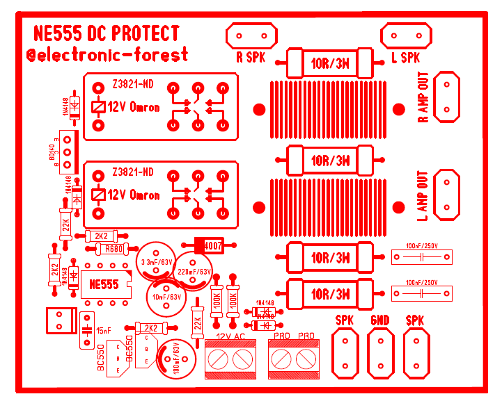

Hi normaly, at least you have two protections, one for shorts and the other is to protect loudspeakers from DC. For shorts you can see Apex AX20 detection pro. This is in amplifire section always and the power resistor R24 act like detection.As you can see in this Apex AX20
Thank you for your advice. I have built the NX400 amplifier and it works well. Which shield should I connect the PRO to?

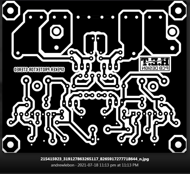

This Apex protection is DC protection, short protection and temperature protection.Ok here you have.

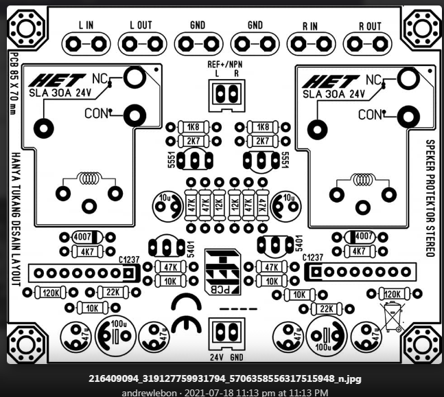

Hello and thank you. The first protector I put was made with upc1237 and I think it also has a short circuit protector.

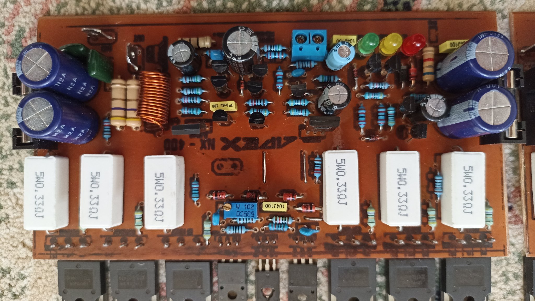

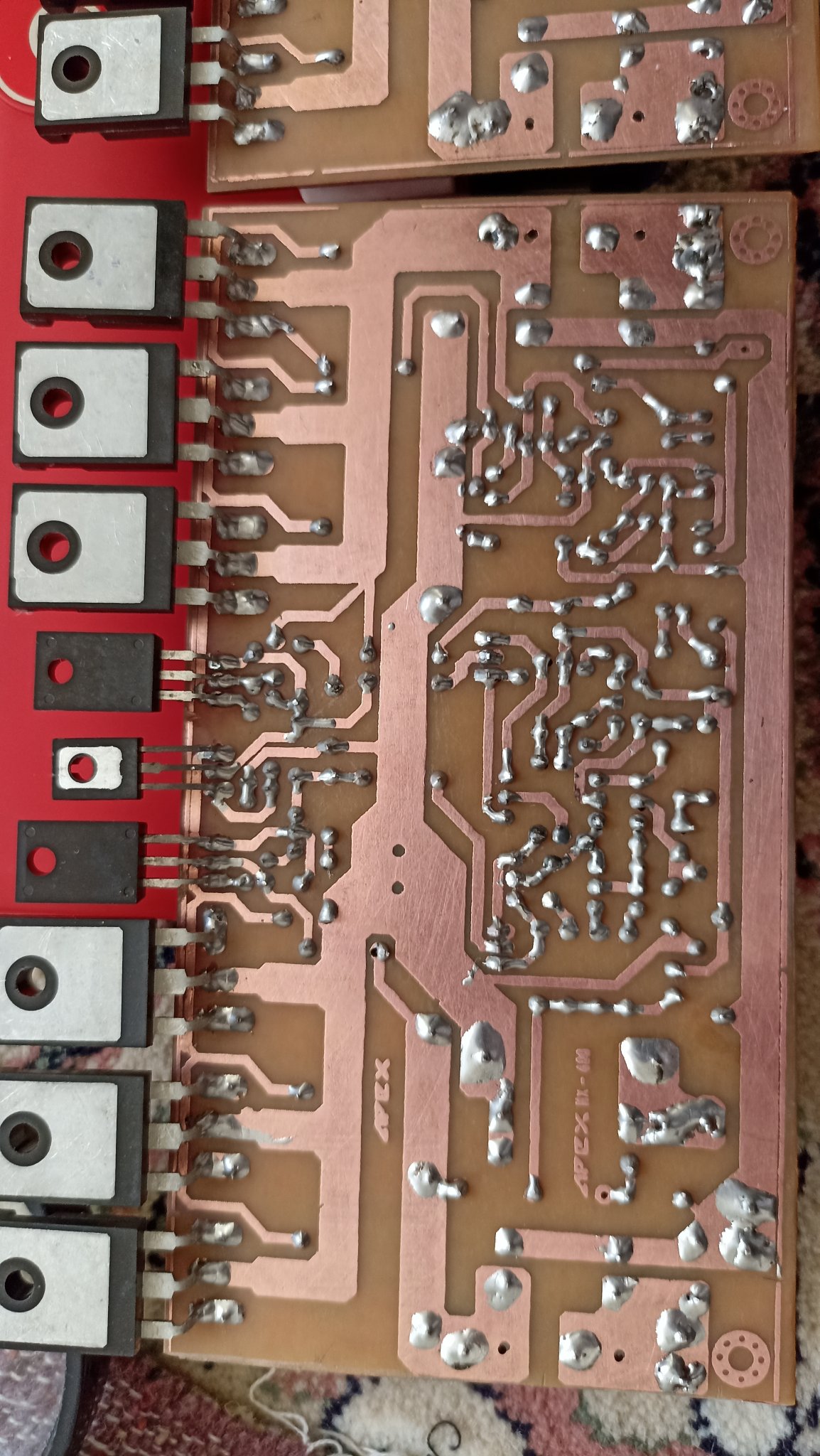

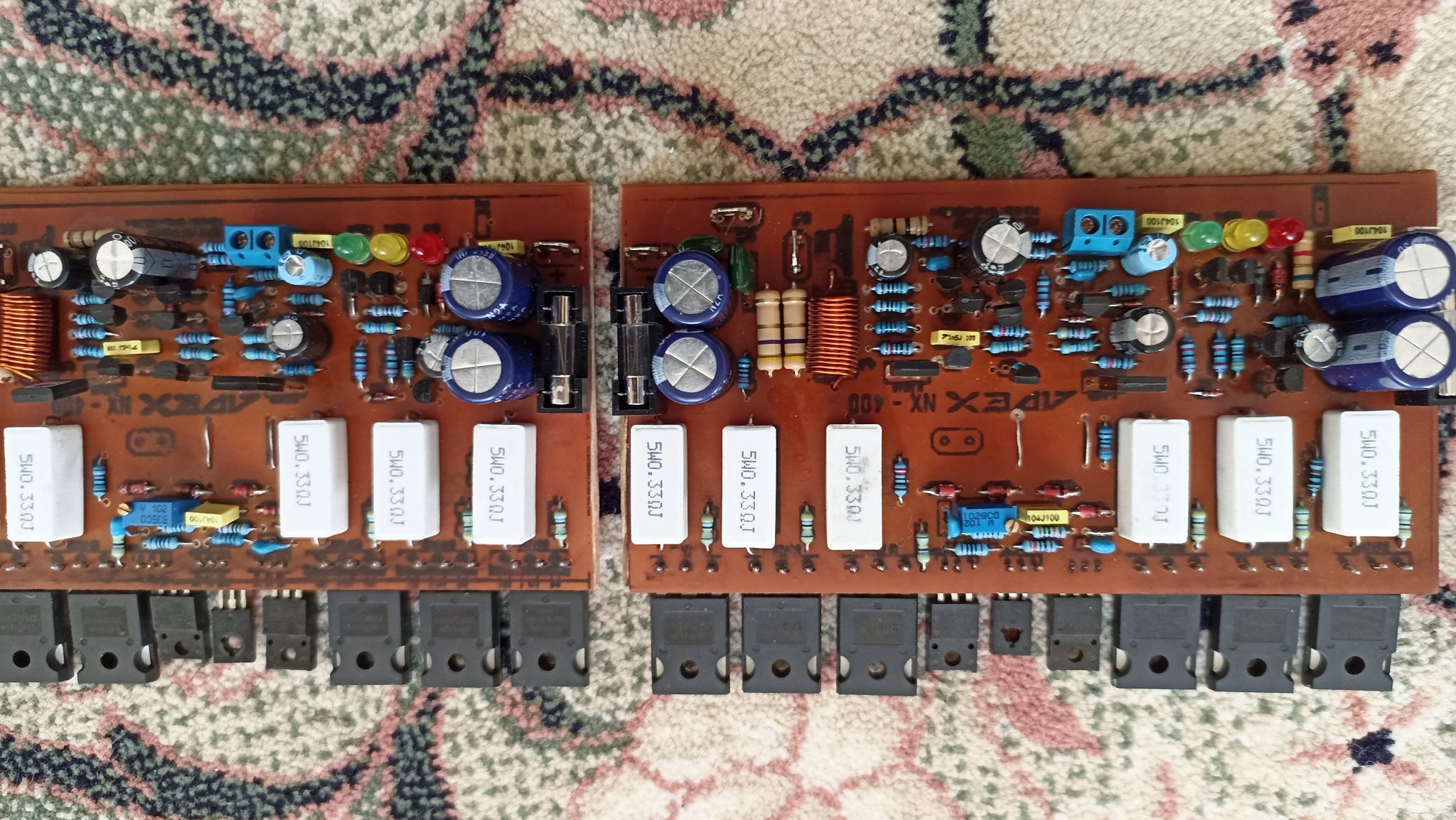

Hello. I built two nx400 amplifiers yesterday. Unfortunately, there are dc voltages in the output, what is the reason?
Hello. 13 volts in one of the amplifiers and 42 volts in the other.Does the amplifier protector I made with upc1237 not have short circuit protection?

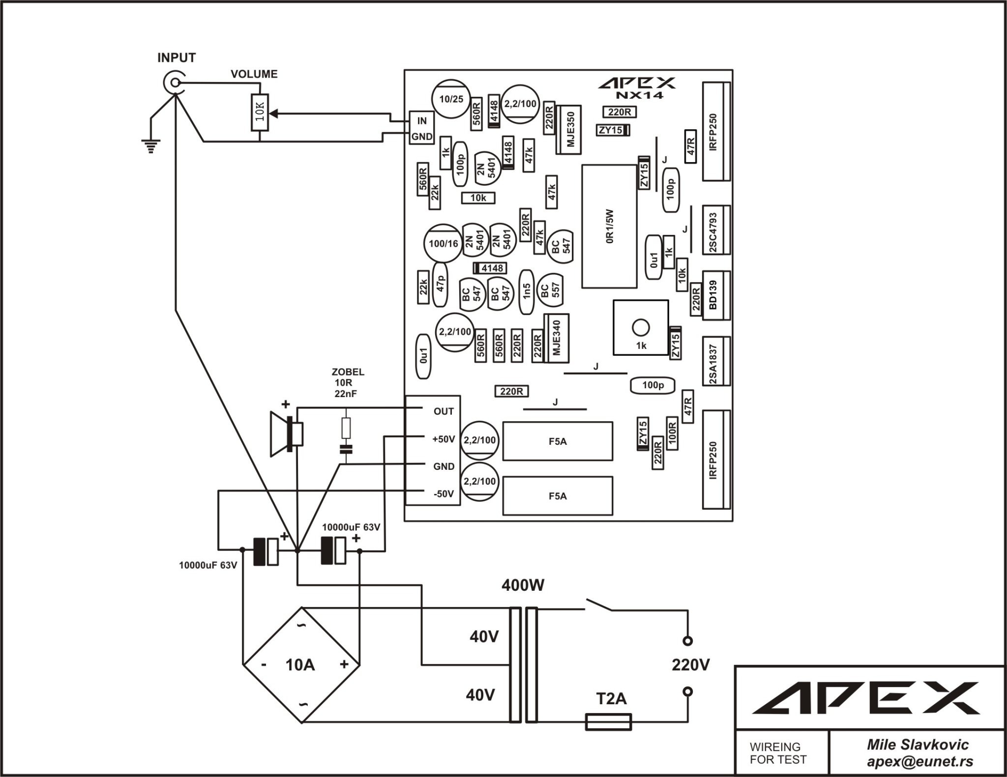

Nice work, did you conected the signal ground to the main ground, if you did so you should have to see your work again.Do not forget the signal ground conection

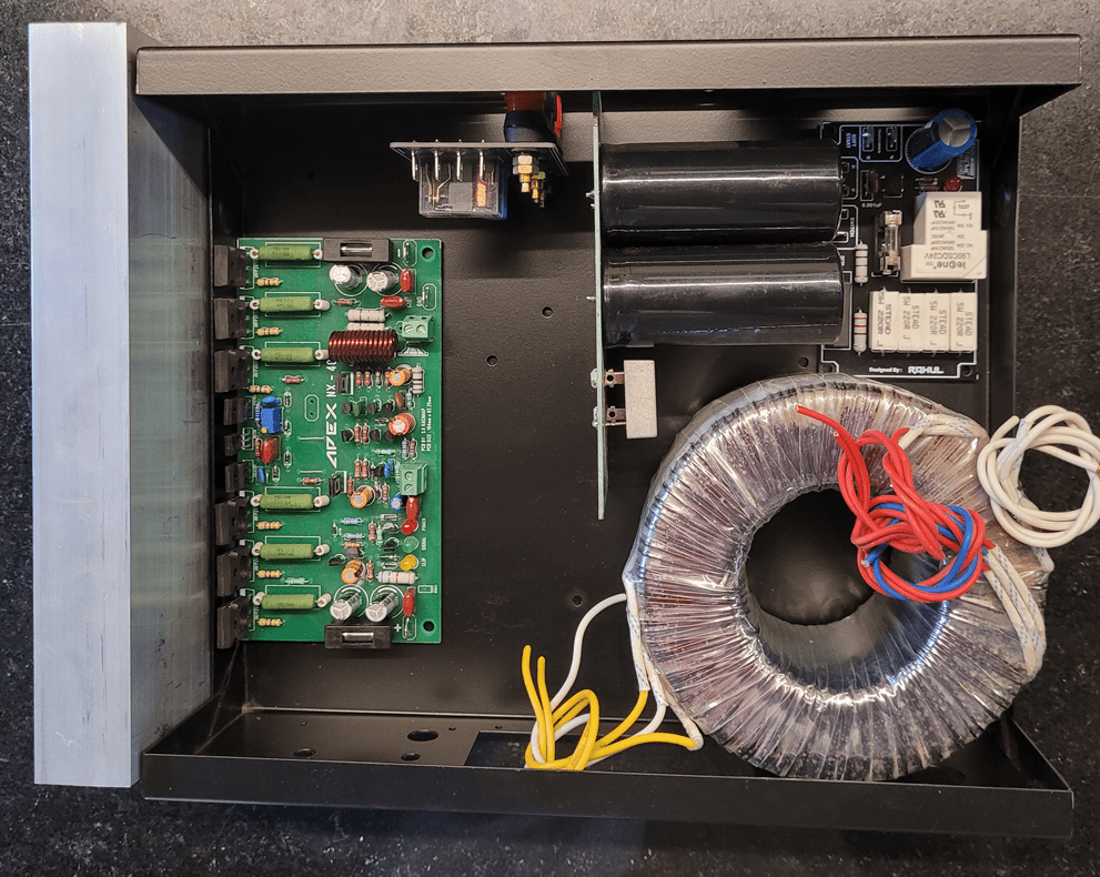

Hello. To power the pre-amp-fan-mp3 player-protection and other things, should they be powered separately?

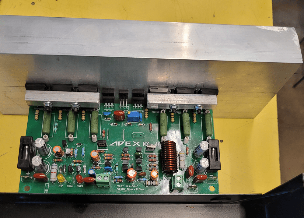

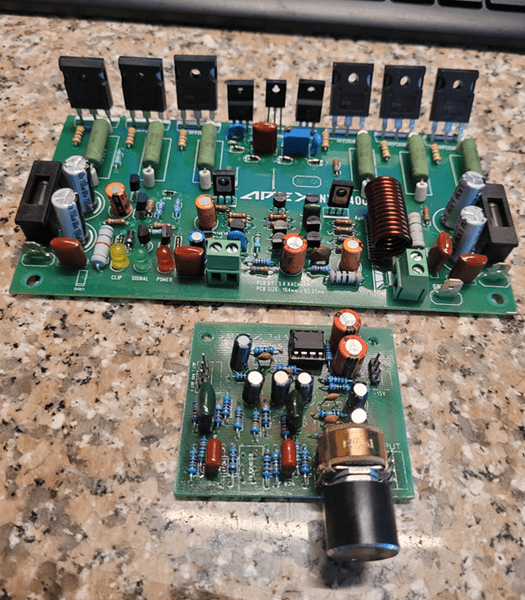

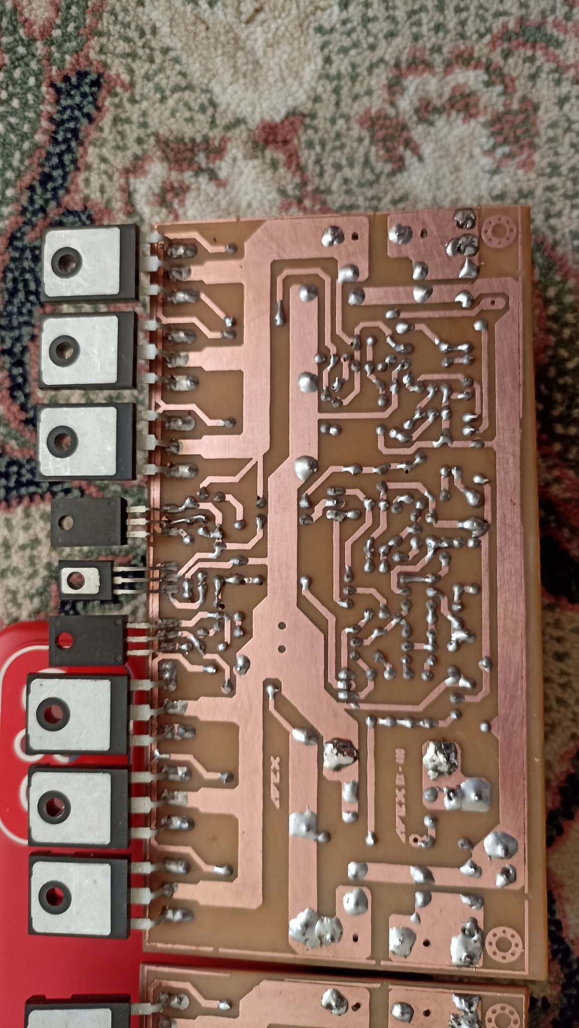

Received the NX400 and small preamp modules recently.... started the build..
This is how I clamped the mosfets to the heat sink:
The layout:
The layout:
