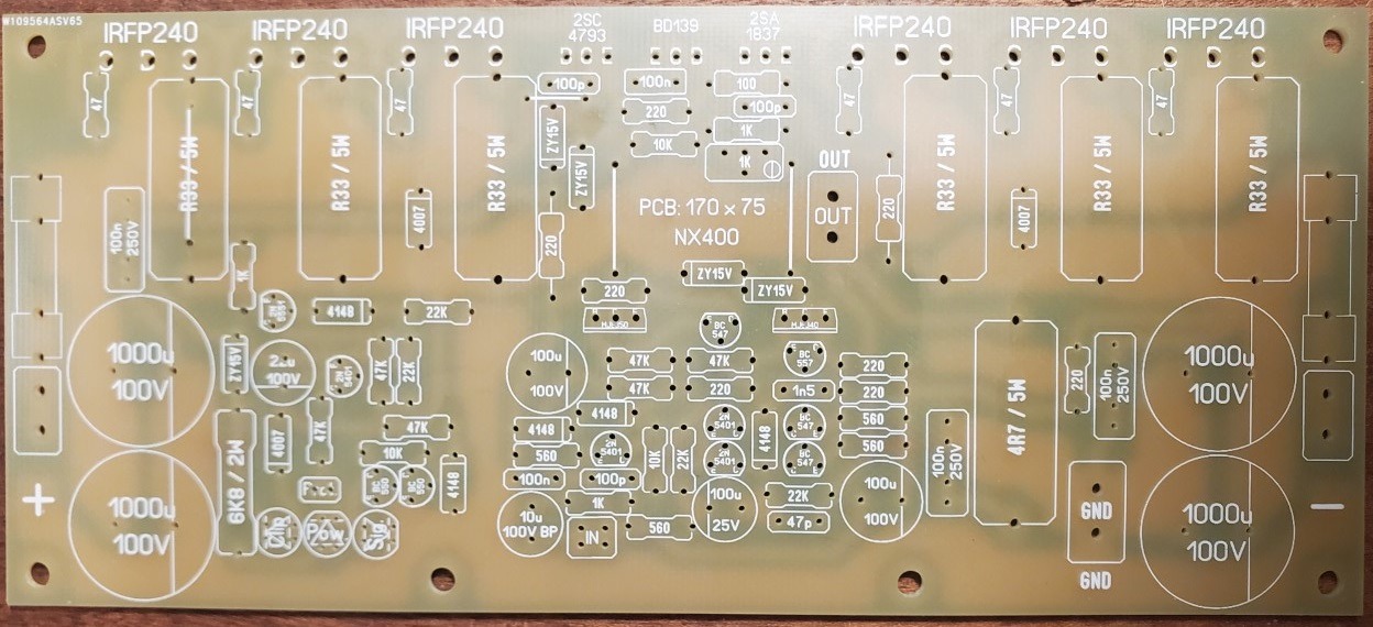

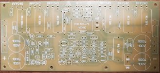

I'm looking at having some boards made of the NX400. Are the gerbers above good to go w/o errors or changes. Also looking at using IRFP250s instead of 240s bc I have alot of them laying around. I'm assuming swapping the transistors won't be a problem??

So I received my NX400 boards the other day and am ready to get started. I'm assuming I can just use the components printed on the solder mask? I have seen different versions of the board in this thread. Mine is the version linked above. Are there any details on supply voltages and bias levels. I have very big heatsinks for an AB amp and would like to run the bias on the high side for AB on this version. Any thoughts?

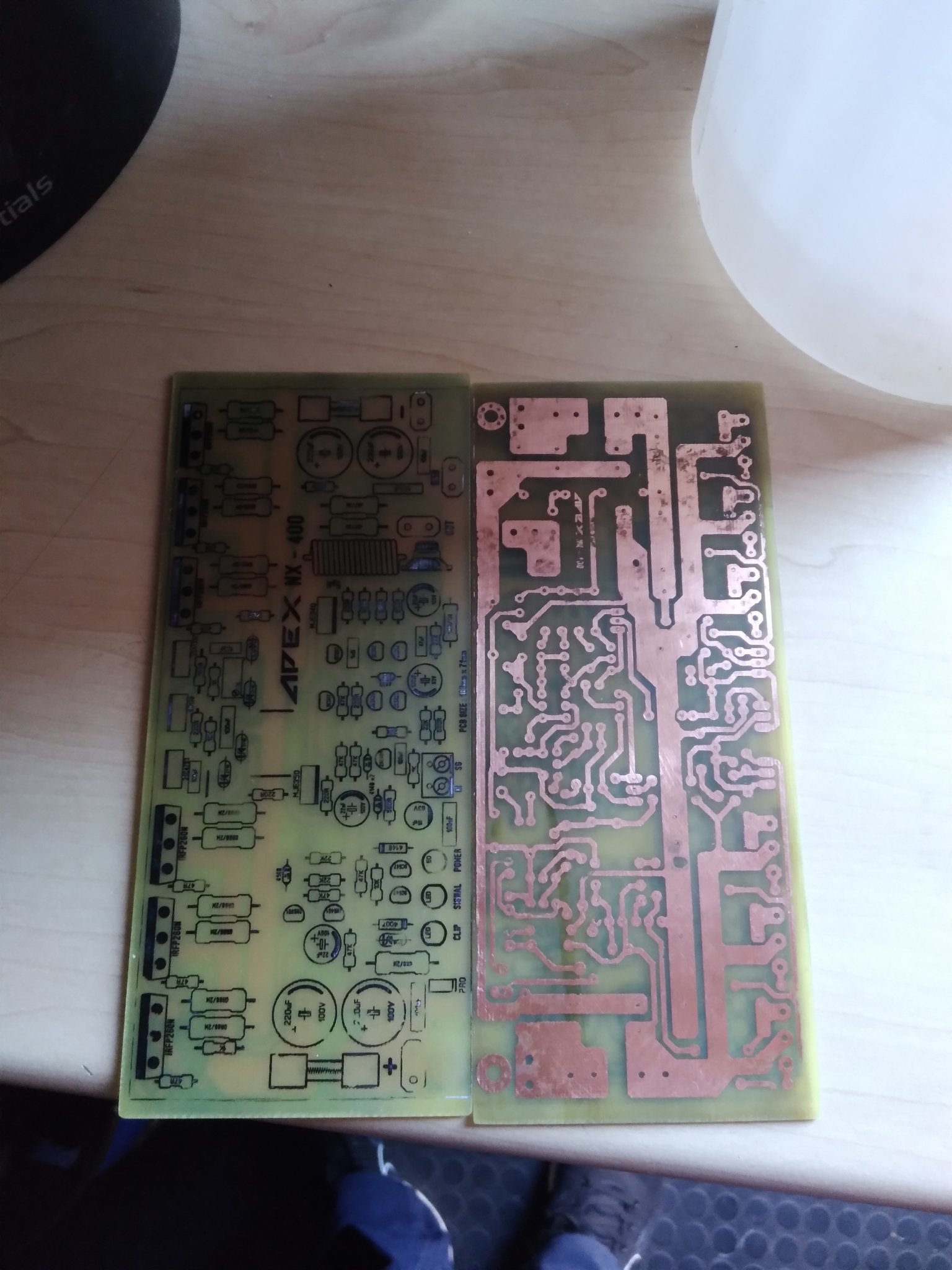

just knowing all is well with the design would be nice. I'm thinking about getting PCB from PCB house as gerbers are available.

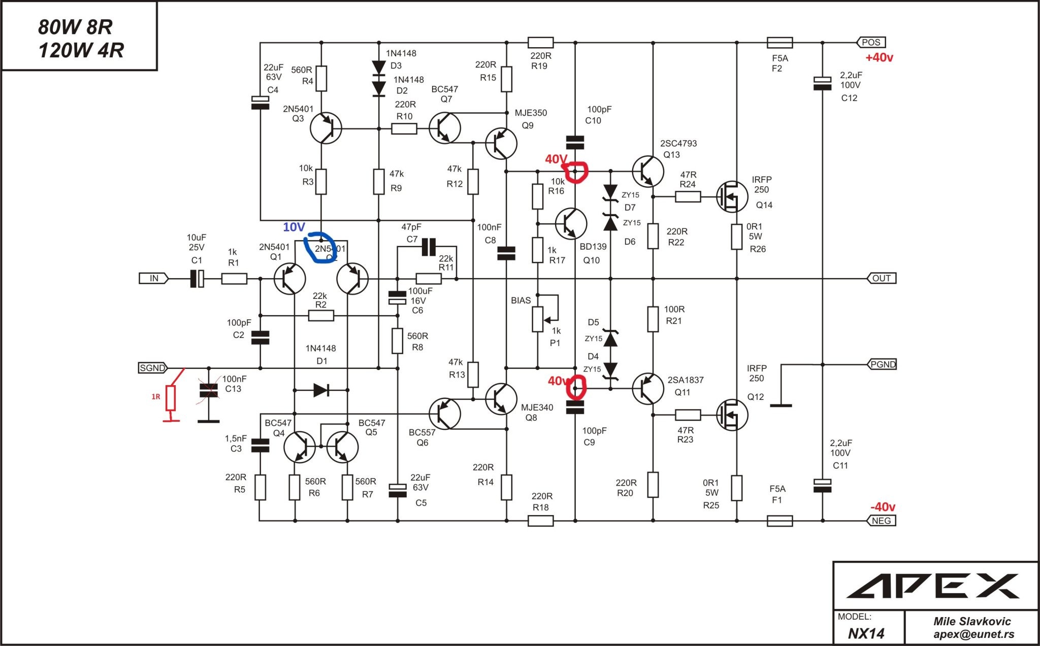

Hello Sir. Im getting DC output on NX-14. its almost same as Power voltage. No voltage across 0.1ohm in 0.1V range.
can you please give me any suggestion to debug this problem?
i have shorted SGND with PGND. But not connect any external 10K pot to the Signal Input.
Thanks.
