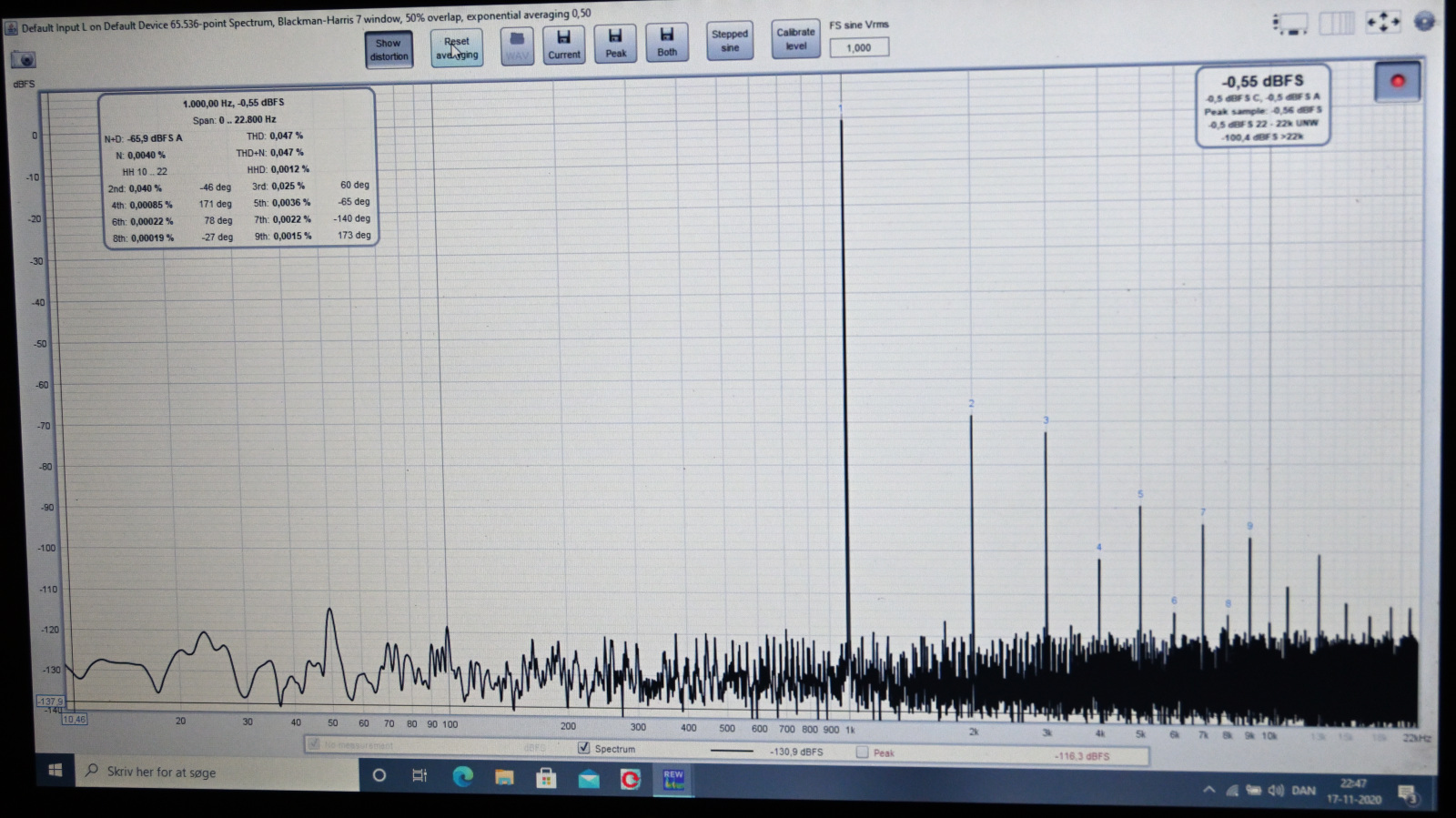

Yes, I played a bit with various cable configurations but could not get it better than the best configuration/measurement yesterday. The TS - RCA converter is a bit "flimsy" so could be nice to use a balanced configuration from amp to 2i2. And also nice with a TS - RCA cable for the output so I don't need the converter.
I measured the other mono block and they are both quite similar. I am so far happy with the measurement from yesterday and from this evening where I experimented a bit with cables. When I compare distortion measurement presented in amp forums I think my looks quite good.
I will print out the amp to balanced schematic presented earlier in this thread.

But, is there an option for an external sinus generator that has low enough distortion/noise so it can be used for distortion/noise measurement using 2i2 and REW?
I tried a cheap function generator I had but that was quite bad.
What about older analog sinus generators? .....like vintage HP etc....are they good enough? ....any suggestions?
It could also be just a 1 kHz test tone kit.
Reason is that I can have a more simple setup and avoid the "closed loop" I have today. I think it will look nicer regarding the cable routing. Then I will go for a balanced input solution for 2i2.
You'll avoid group loop with an external generator, and things will be a bit easier, but you won't have a better spectrum than this (last yours):
If you want a lower noise shelf then use averaging (I don't know about REW, I use ARTA).

The above spectrum was obtained by moving around with 2i2 until I got the lowest peaks on the monitor. Maybe it is easier to get an optimal setup using an external generator and there is also some fun in building it 🙂
I used averaging: Exponential 0.50 .....what that means I don't know.....there is also 0.75 etc. which probably performs a "harder" averaging.....
I am satisfied with the above spectrum.

MEPER, given one of your aims is to measure distortion at 1kHz, you also have the option of tweaking a 1kHz sinewave signal from REW to suppress the individual harmonic distortions of the output signal of the 2i2 to very low levels (much lower than the inherent THD from the 2i2 output signal, and getting down towards 0.0002%), and of using a 1kHz tone that is exactly frequency matched to the FFT algorithm to give better dynamic range of the amp's output measurement using the 2i2.
Ok, so I could also filter my Volcraft FG-250D function generator (set to 1 kHz) to get low noise and distortion?
The nice thing with the kit I get is that everything is included and easy to build. I could even go for "hand matched" components for the filters if I want and get even better performance.
I could also just buy an Audio Precision x555....or what is it called? .....but that will be more than 100 USD....or it could be a vintage HP distortion analyzer? ....with those I would also be able to check the phase of the 2nd harmonic relative to the fundamental?

Also I think the conclusion of the amp measurement is that PSU has a lot to say for the performance of the amp. A small bit of imbalance in PSU is visible in measurement. The first immediate sign of imbalance is if -+ rails is not 100% "numerical" identical. With this re-built of the rectifiers that was one of the outcomes that I got rails 100% symmetrical (and stable). Another outcome was that I got higher rails and don't waste "switching power" in rectifiers.
Definitely breaking the loop between output and input on the 2i2 I think will help. I'm interested to see the results you get if you feed in the function generator to the 2i2 because I have never been sure whether the inherent distortion is on the output, then input or a combination of both, so will be very good to see the performance with a known low distortion source.
