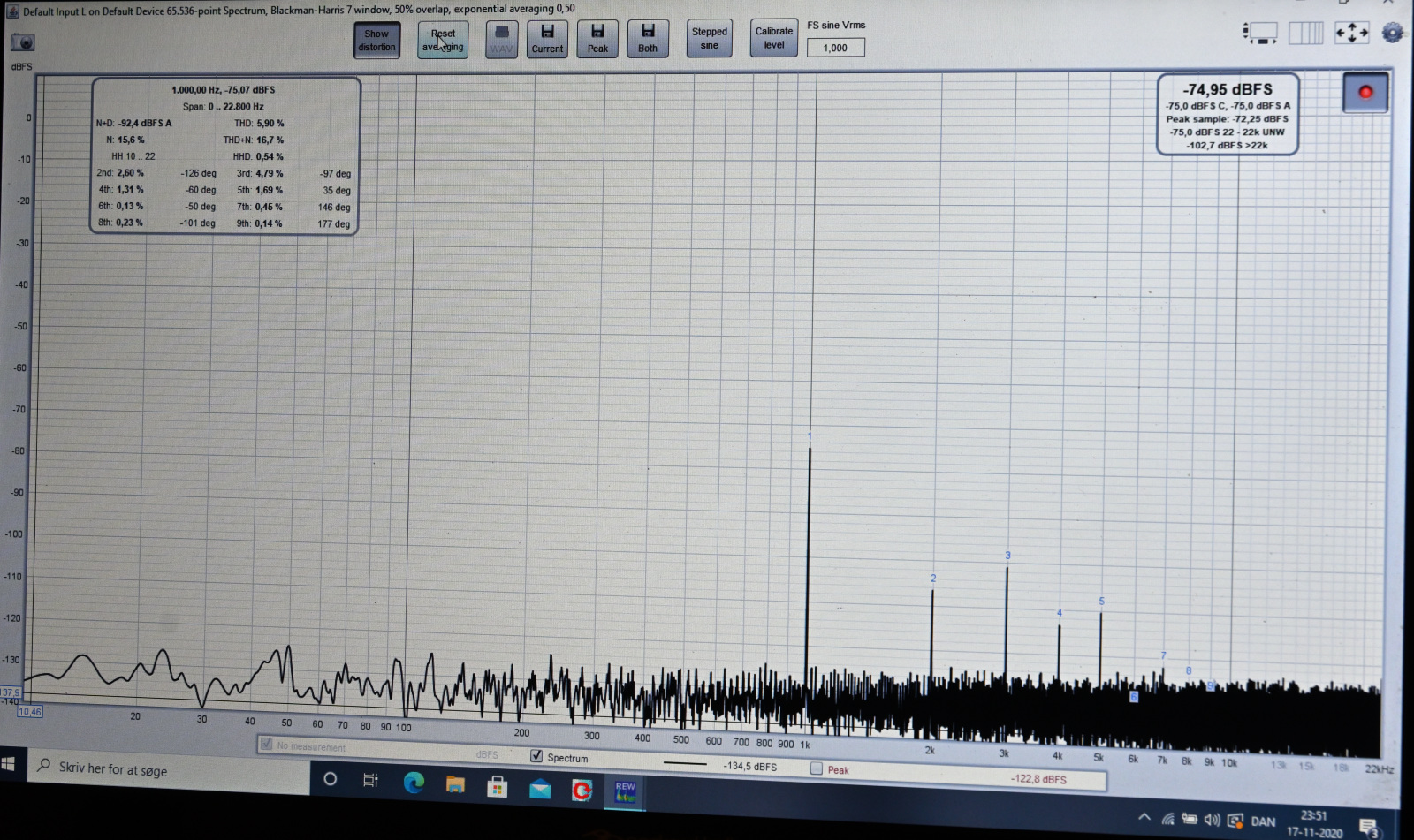

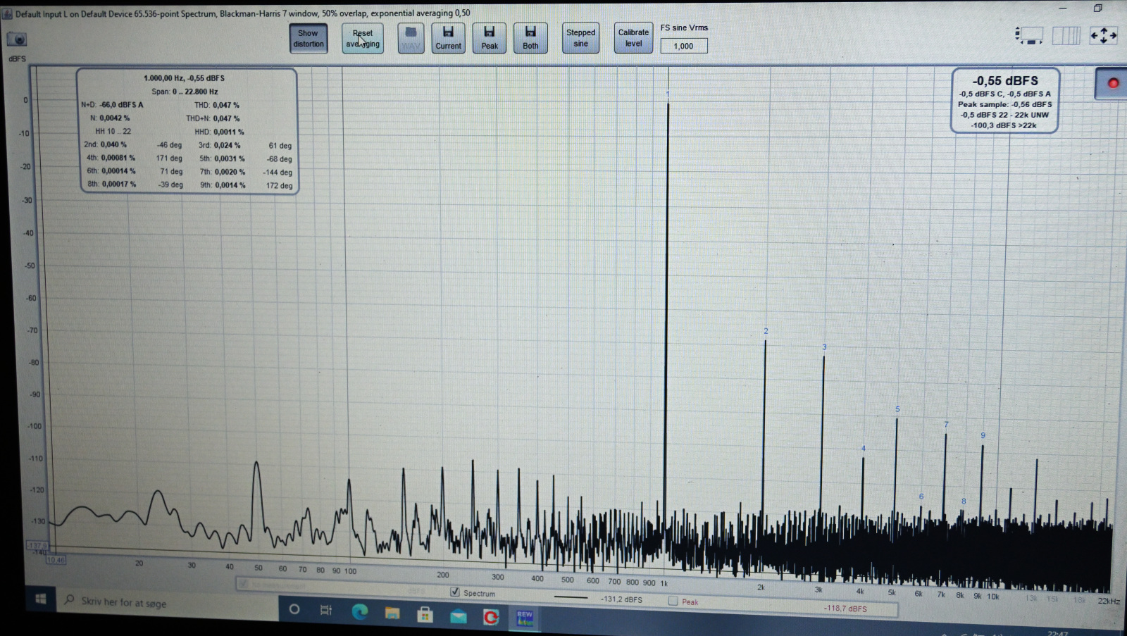

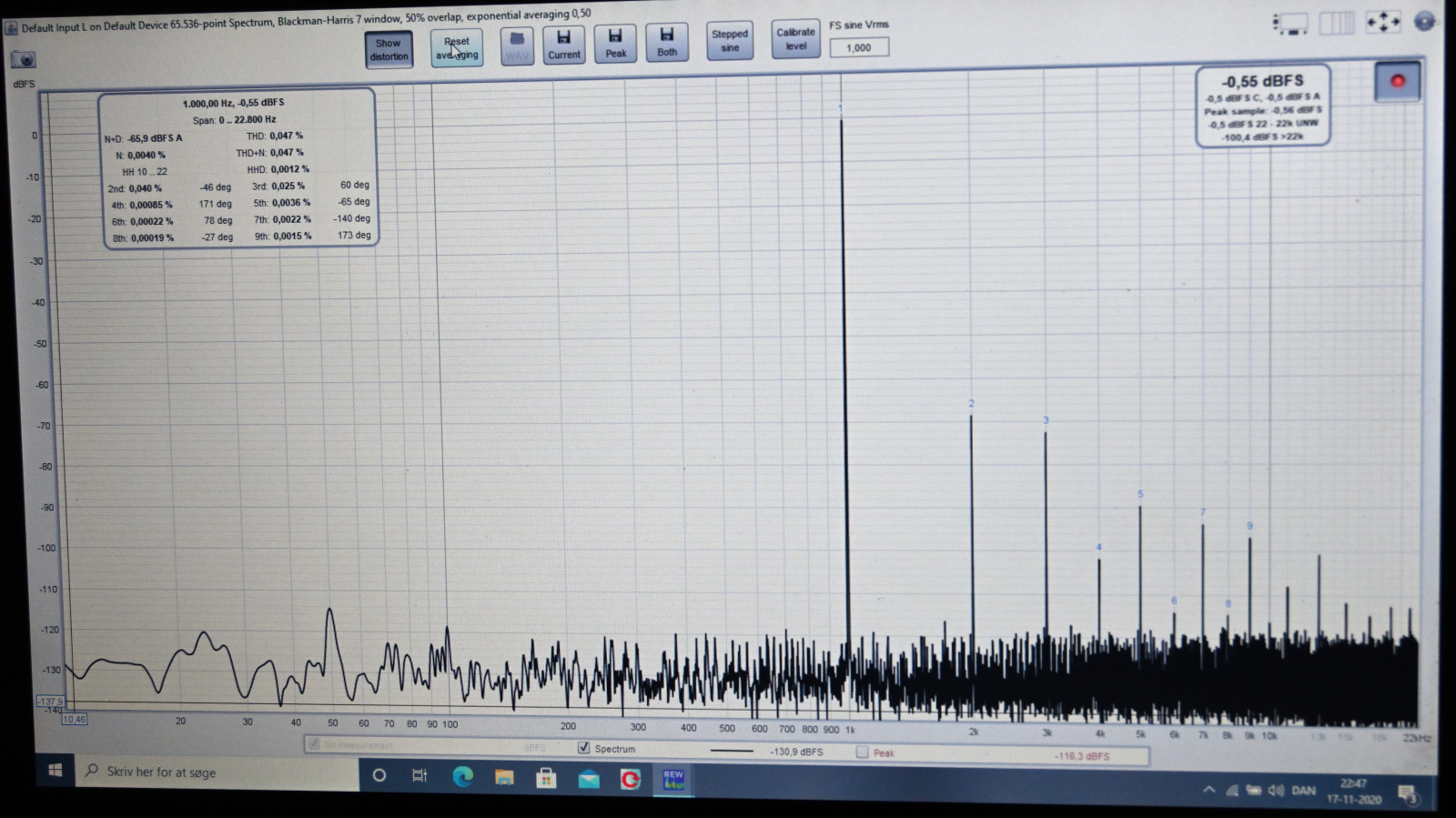

Now I made the first measurements using 2i2 with same setup as previous but with attention to if 2i2 could pickup some noise. And there is some strange things happening. The two images attached......the only difference is that 2i2 is moved 20 cm. The image with lowest peaks below 1 kHz is with 2i2 placed just on top of transformer and the other image 2i2 is placed 20 cm away from transformer. Do you think 2i2 is affected by the transformer magnetic fields?
If 2i2 should be placed far away from transformer I must use a much longer speaker cable which also can pickup some magnetic fields?
Probably the image with less noise is closets to what is coming from the amp?
But I need to improve the measurement setup.
What i noticed was that during the first 1/2 hour from when PC was powered on a lot of interruptions of the 2i2 probably caused by updating the PC, virus scan etc. Is there a way to ensure only REW has access to 2i2?
It does not help that the PC is old and slow.....

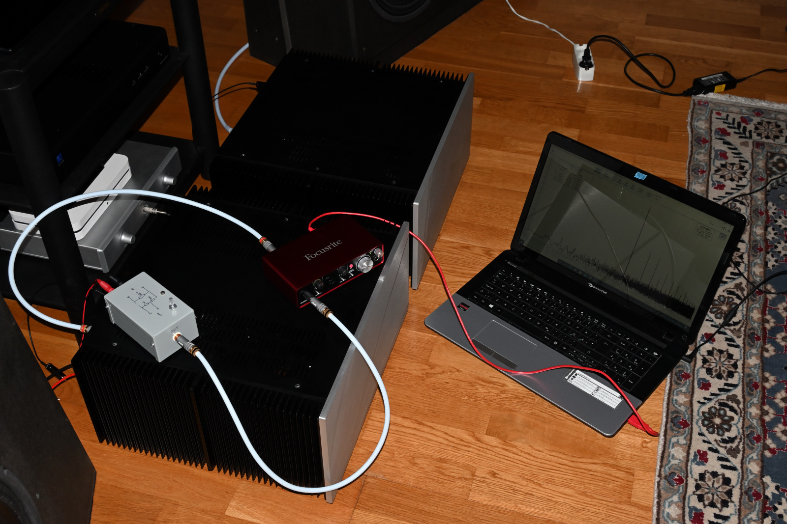

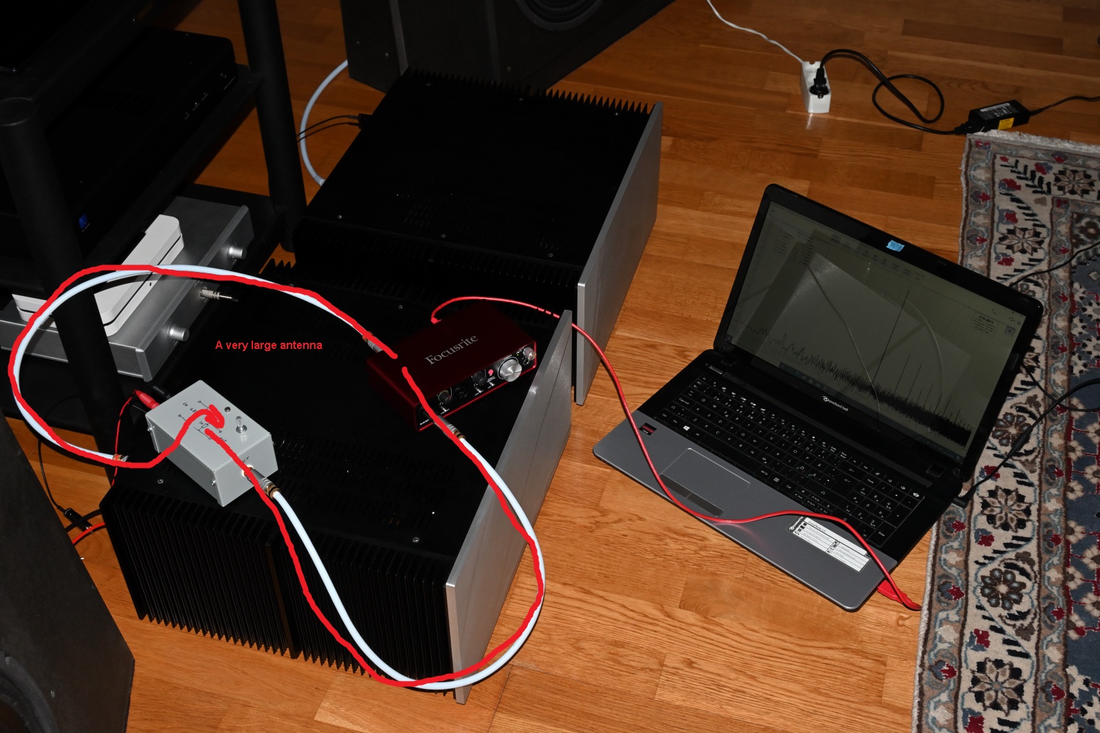

This is how my setup looks in the moment......left amp is under test and just below 2i2 is the encapsulated toroid. It is a placement of 2i2 where noise seems less.....
Amp outputs about 4.7 V RMS into 6.8R.

There was a request for an image if amp was turned off but 2i2 and REW still active. It is attached. If my hand just comes close to 2i2 I see a large 50 Hz peak and if I touch the input gain knob it becomes larger.....so it is very sensitive. I had to keep away not to disturb the measurement when amp is off.
It can be affected by transformer fields of cause, if it is placed close to the transformer. But the largest problem source is shown in your setup photo.

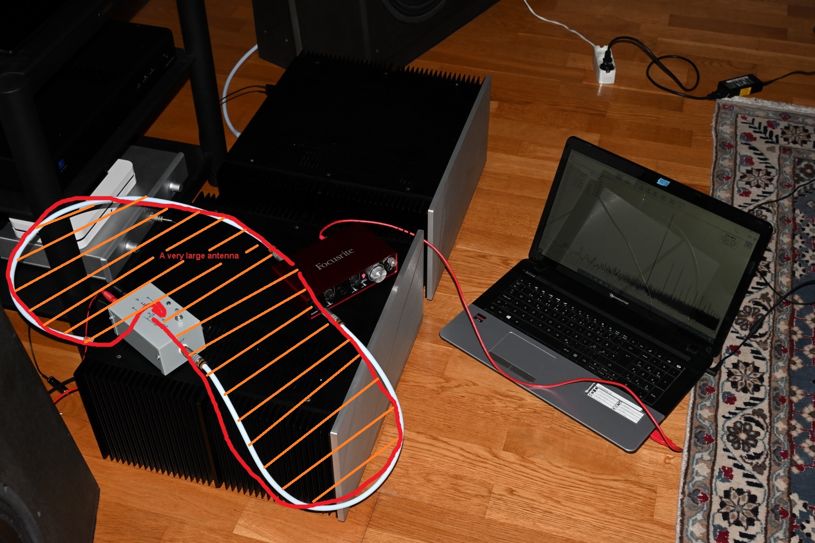

Look how large an antenna is:

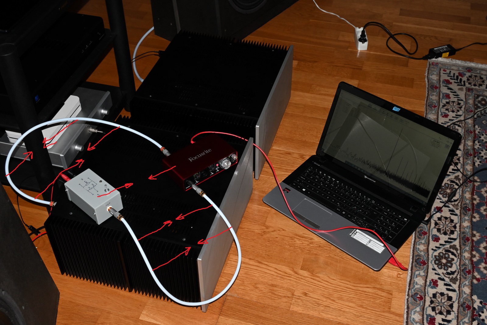

Are you able to repeat the plot, but:
(a) no amp input signal (REW generator set to min); amp input cable connected; amp output sensing cable and cable to 2i2 unaltered; temporarily disconnect the OUT connection within the interface module such that no signal gets back to the 2i2, but the 2i2 still has a gnd connection back to the amp. This allows a 0V loop from the 2i2 out to the amp and back in.
(b) same as (a) but with nominal amp input signal level. This allows the amp internals to have normal signal and 0V circuit currents flowing.
Is the laptop connected to its charger during these tests?
I always sit my EMU USB interface in an aluminium tray (which can have an inverted tray as a top cover), and the signal input plug sleeve is electrically alligator clipped to the tray. This acts as a shield of sorts. The aluminium trays are what we refer to as BBQ trays, or for food serving.
I see a good picture and no visible problem on this spectrum. I mean I see quite a good setup.
The coaxial cable you use now - is good enough (have a good screen), I think. The only problem with it - it is rigid so it is a bit hard to manage it right.

When I moved the 2i2 further away I made the antenna area larger and therefor one of the images shows more noise......is my conclusion based on above "antenna comments".
I have more flexible screened wires which are for internal connections. So I could build more flexible RCA cables so the loop can the closed. I will "play" a bit with measurement setup now I know what the problem is and see what I can achieve.
It seems the "antenna" picked up the field from amp as it looks ok when amp was off. First thing I will try is to move setup away from amp and I will try to close the loop as much as possible. My Supra speaker cables has a twisted configuration which should pickup less noise than just parallel configuration so I will try using a Supra speaker cable from amp to box to get away from amp fields. The cable is 1.5m. I will give it a try.
This is where if you use a balanced to se converter and an se to balanced converter so that you are running fully balanced both out of and into the 2i2 it should eliminate at least some of that noise pickup. that way you can make the non balanced connections short, and you can have a decent length on the balanced ones so you can get the focusrite away from the DUT as well.
As also mentioned by someone earlier, some sort of plate with a connection to the earth of your TRS that everything sits on should also help. I was surprised how much difference it made to measurements of circuits on my breadboard with a 3mm aluminium plate under it. Steel should be even better.

I don't think there is a strong need to change cables. I think there is only a need to manage them a bit.
If there is an in-built possibility to use balanced inputs somewere - then it is will help too (of cause).
But in general I think TS has good enough spectrums (and so measurement setup) now. At least, good enough for his monoblock amps.
He just need to play a bit with it to get an experience.
