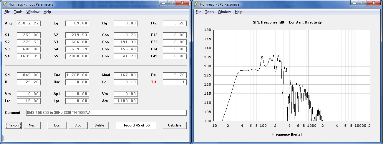

If you really want to move a *lot* of air at 30Hz you could consider the BMS 18N860 (Xmax=22/23mm), though you'll need a big box...
(and it's not so suited for a tapped horn)

Are you referencing iand's new design post with the bms 30Hz TH?
If you drive *any* speaker with a continuous sinewave at the box minimum impedance point at the rated power (P=V^2/Rnom) it'll fry -- not only is the current higher than normal but the coil isn't moving to pump cooling air. I fried a McCauley 6174 just this way (repetitive bass note at 25Hz reflex box tuning frequency).
At least BMS provide distortion curves measured at 1000W (89.4V) unlike any other manufacturer I'm aware of, which says a lot for their confidence in the driver performance, and the 15N850 is rated at 1200W (98V) and has 16-17mm Xmax rated by the formulae everyone else uses (adding Hg/4 or Hg/3), so it's got a lot better chance than most drivers of surviving high-power dubstep without running out of Xmax.
How long does this 'continuous' sinewave have to be played for, continuously, in order to deem it dangerous? Most dubstep doesn't 'hang' on a sinewave, but sweeps to and from. Some notes will fire for a 2-count (~140bmp), but not much more than.
This RCF design reaches 121dB @ 30Hz w/800W (again, if my math is correct) which is not bad at all, given it's size and that it's tuned for 40Hz.

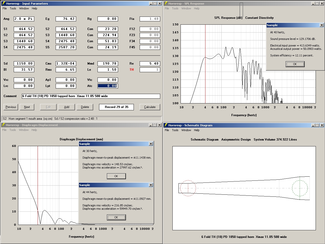

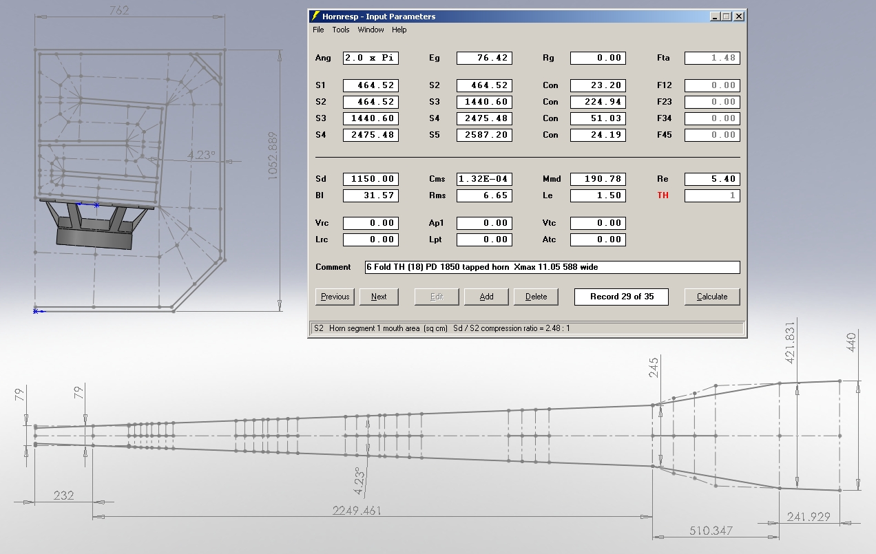

Here is a design similar to Wood1y's layout using the 18" Precision Devices PD1850 The PD1850 is a robust 800W horn driver with a 5" voice coil
Precision Devices International Limited
Note
Compression ratio is 2.5 to 1
Schematic is extrapolated from the physical model - not a theoretical sim.😉
Hornresp shows this driver OK down to 30Hz at 730W /76.4V.
What do yer think?😀

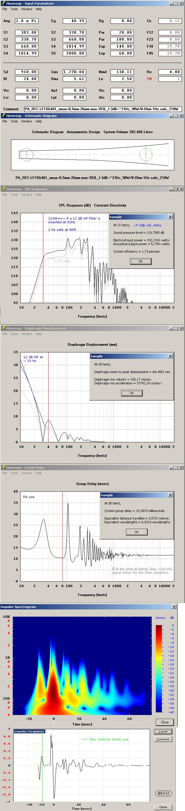

Stayed up til 7am and could only sleep 5 hrs til my mind got swamped with the urge to keep moddeling in hornresp. Last night I found a driver that models better (for my needs) in either of your enclosures (again, unless I'm missing something or doing something wrong). Hat's off to you both for coming up with great designs. And a thank you goes out to those who have nudged me a long the way. Let me know what you think. I'm eager to land on a winning design!
I have modelled both epa's and Xoc1's enclosures with the B&C 18SW115
First up, epa's:
First up, epa's:
good job😀
so you are getting the hang of hr.
concider that 140 db is like a jetfighter over your head
insane loud
here is another one
insane loud
here is another one
modified sym th
only 392 ltrs netto
you can ad a 3mh coil to smooth out the pasband if you use the b&c driver
just ad 4 in the LE field
only 392 ltrs netto
What programs are you two using in posts 68, 72 & 73?
@ epa: how would those curved bottom pieces in post 73 be made?
@ Xoc1: yeah, that's the downside - but, I think the 2-3dB increase is worth not building 2x the amount of boxes to gain the dB not had (double the driver(s)/cab(s), add 3dB). So, instead of building 2 cabs, spend another $150 (or £ in your case) to gain that 3dB and save space.
