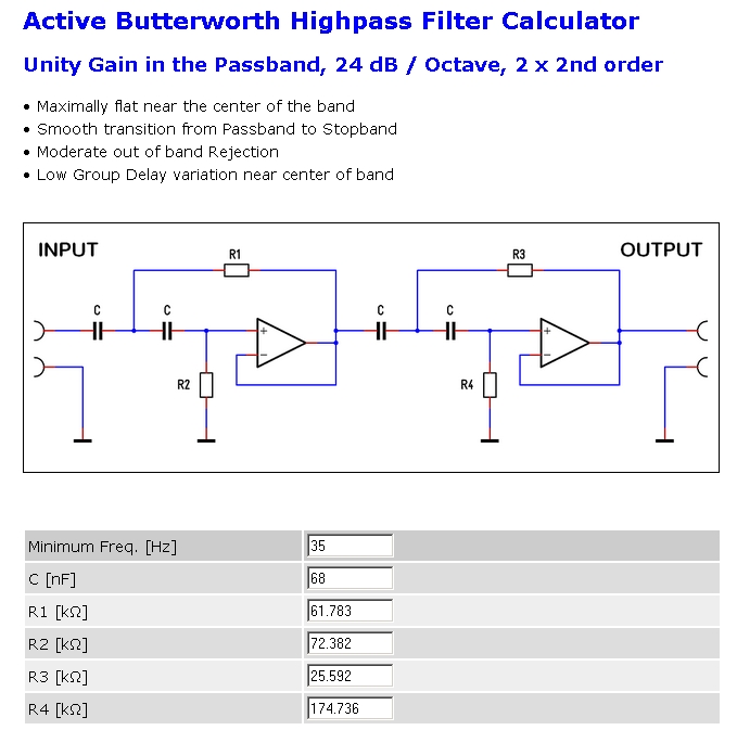

I am unfamiliar with the way that that the filter values have been calculated in that circuit.
Generally I tend to use a butterworth filter for the Hi pass on a sub.
I found a filter calculator on line
Online Calculator .:. Active Butterworth Highpass Filter Calculator
with the 68n capacitor in the circuit the resistor values seem quite high, I would probably recalculate this with a bigger value capacitor if you can fit them on the PCB.
Regards Xoc1

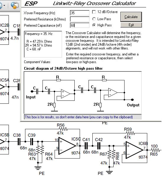

i used linkwitz riley crossover .
Project 125 the calculator
Linkwitz-Riley Electronic Crossover
the way i arranged it is below

Hi Stewin
According to the LR calculator the for the 35Hz filter using 63nF, R is 47K and 2R is 94K
In your schematic R is 47K but 2R you have made 23.5K You need to link the 47K resistors in series not parallel to make the 94K value.
To measure your crossover you could download HOLMImpulse
HOLM Acoustics
This will give you the means with a computer audio output and input to measure the frequency response of your filter.
