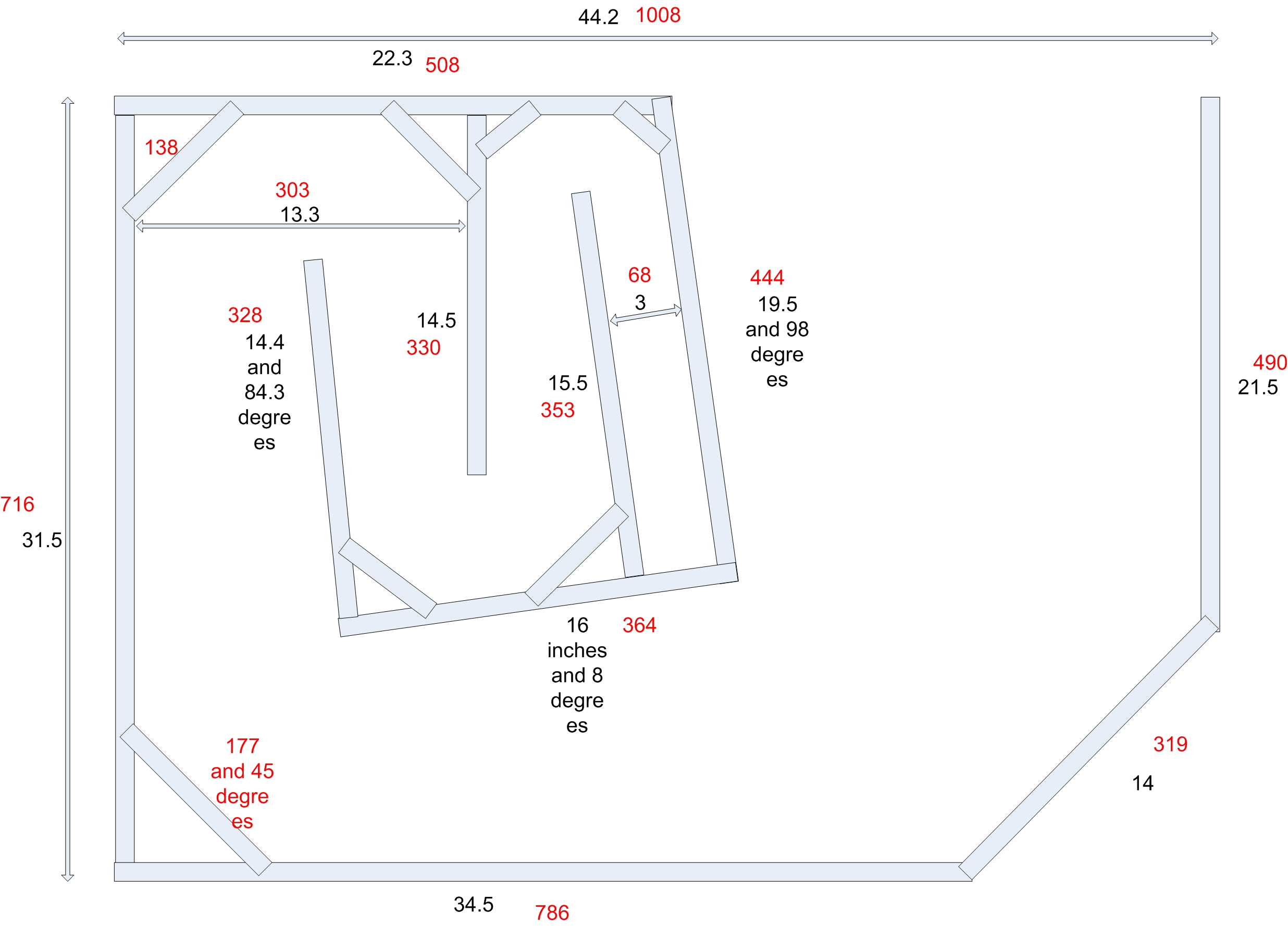

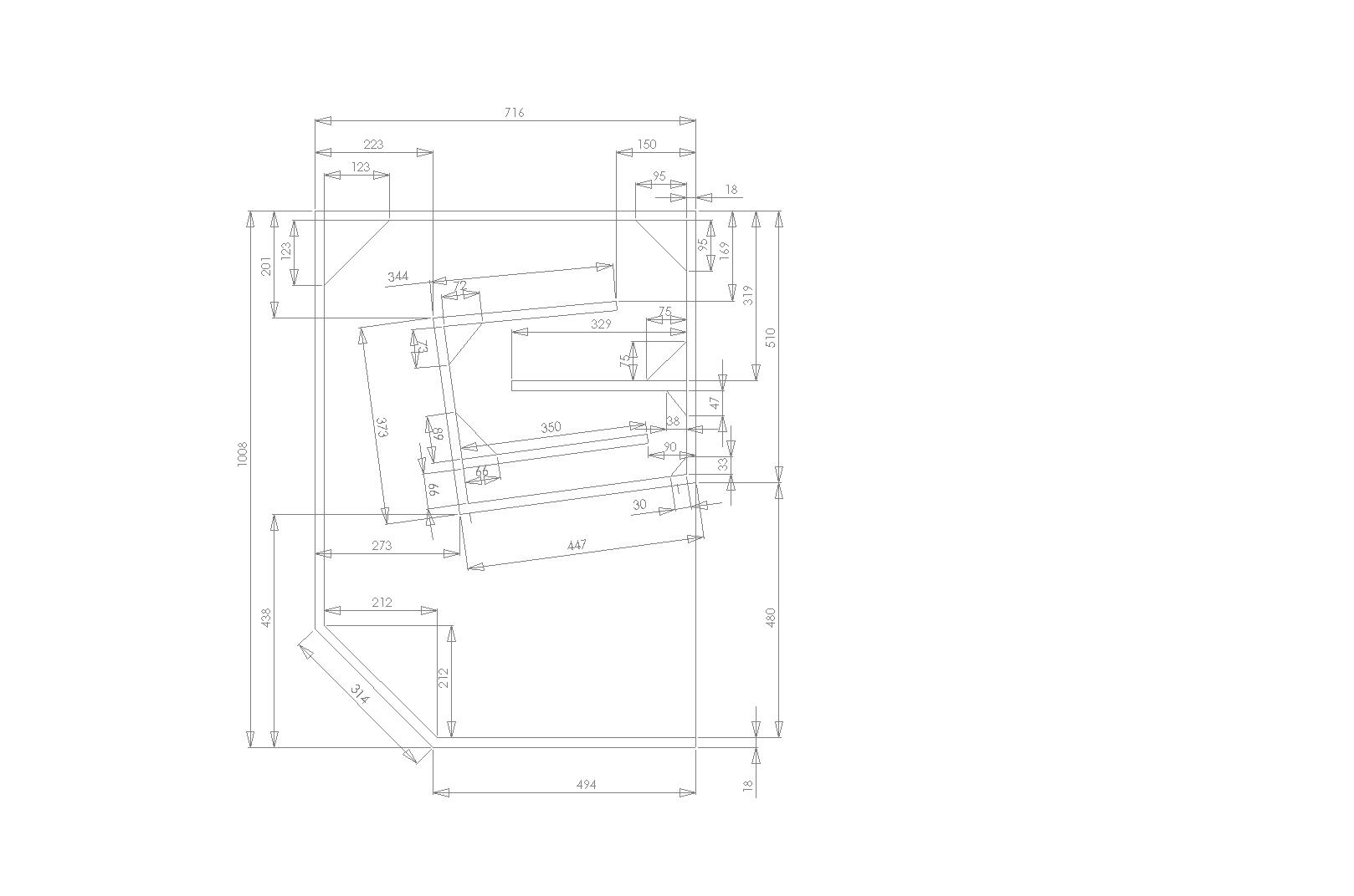

I have been reverse engineering this TH from the plan and the hornresp data.
I found that the taper varied for some of the folded sections, (the third and fourth sections are slightly shallower taper), and that the last section is stepped.
This is not meant as a criticism of what Wood1y has acheived😀
I think that this folding has obviously worked well.
The parallel first section has allowed extra length.
The step on the last section compensates for the area taken by the driver.
I attach a drawing of what I found, showing dimensions extrapolated from the given section plan and outside dimensions.
I also worked it in reverse, some of the dims are a tad different. Black inches (initial guess on scale), red mm. Note that the red is the scaled dimension which has been normalized to the given external dimensions, so will be more accurate. The black inches were guessed at by looking at the woofer.
